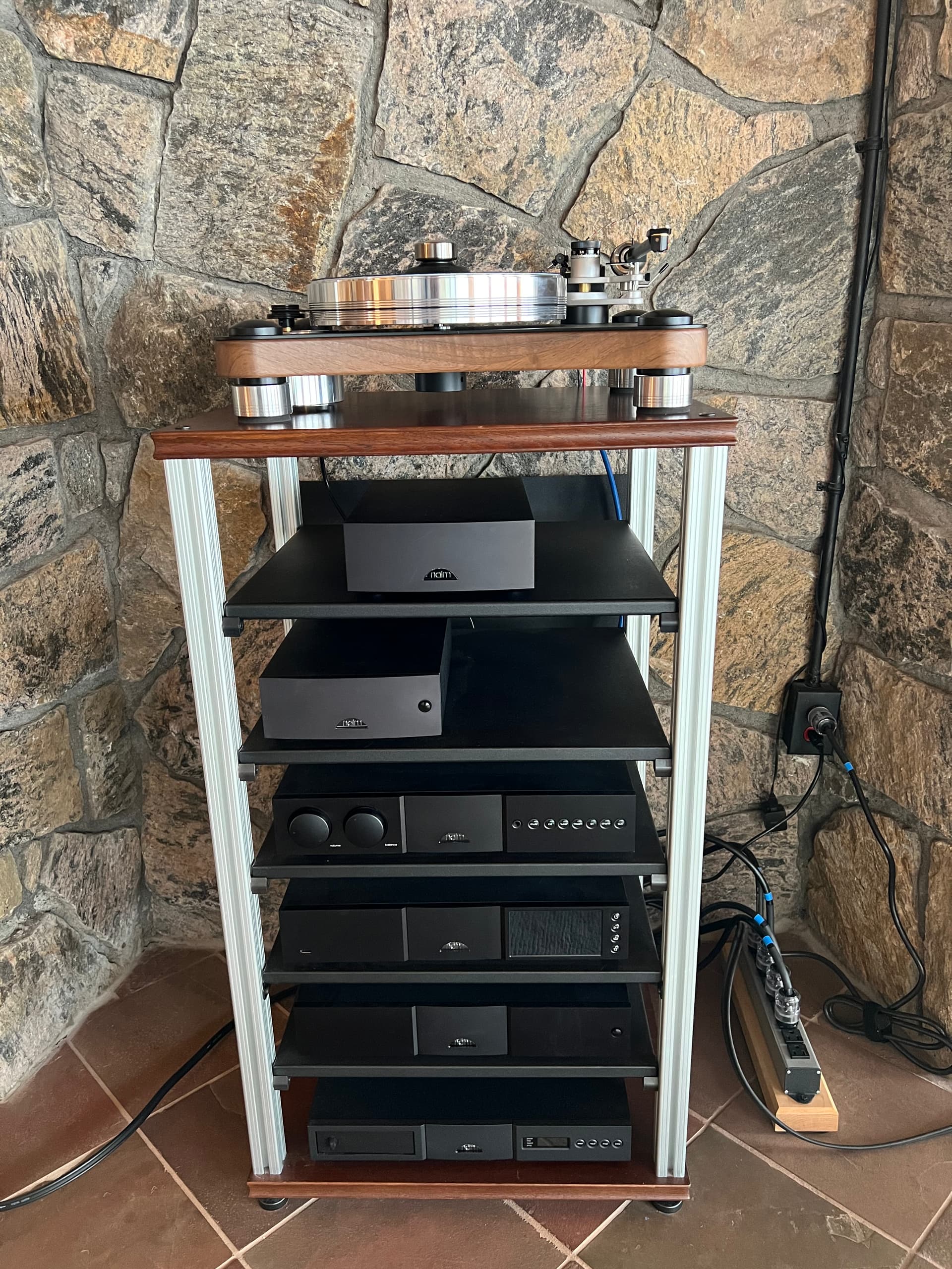

The Superline is on it’s own shelf, but on the same rack.
It’s the same configuration that I had with my Rega RP3, just swapped in the new TT.
I don’t think it will help with the popping, but I’d move the Superline to the far right of the shelf as it’ll move it away from the Hicap and also away from the AC motor above it.
Yeah was there originally, but moved it over so I could connect the grounding wire to the SN3 ground.
It made no difference, but I’ll be moving it back over to the right for good measure.
