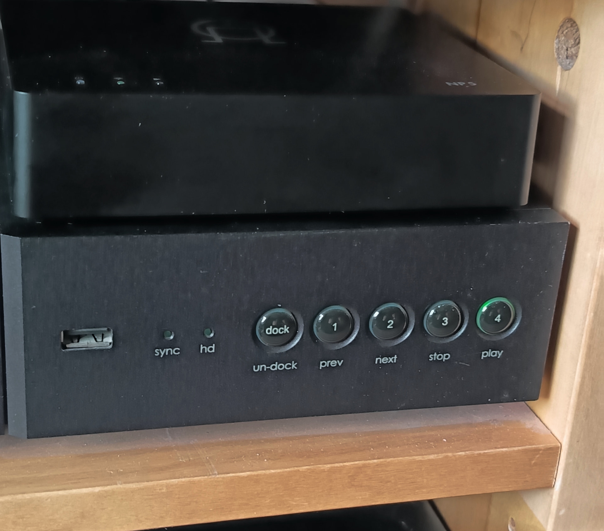

You could buy a Primare NP5 streaming bridge. The 272 would then basically be a combined dac/preamp.
You’d get improved functionality, plus an uplift in SQ. That would cost £700 including spdif cable and upgraded power supply.
I know you said no more boxes, it’s a tiny little thing, that nobody would notice. :blush:
You could even then go for a 555 power supply.
Thanks- there’s no more room on the rack! I will look at this though - I take it you have one of these?

I use one with an ndac. It is excellent.
Quite a few people use it with first gen naim streamers, primarily for improved functionality, but find SQ also improves.
There are a couple of people using it in a system with a 552 preamp. So. It’s a lot better than the price would suggest.
