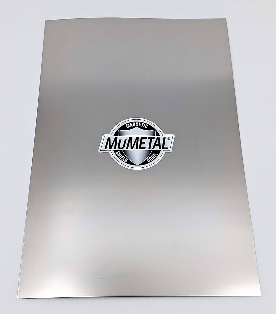

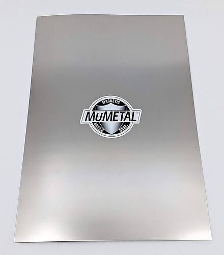

Try a mu metal shield plate. I will reduce the hum.
Mumetal shielding is no panacea though - it can reduce hum but also adversely affect performance. Naim used to supply it for anyone wanting to fit MC cards in the NAIT3, but really they felt it better without - i.e. best not fit MC cards.
It doesn’t cost a lot, so maybe worth to try. It won’t harm.
