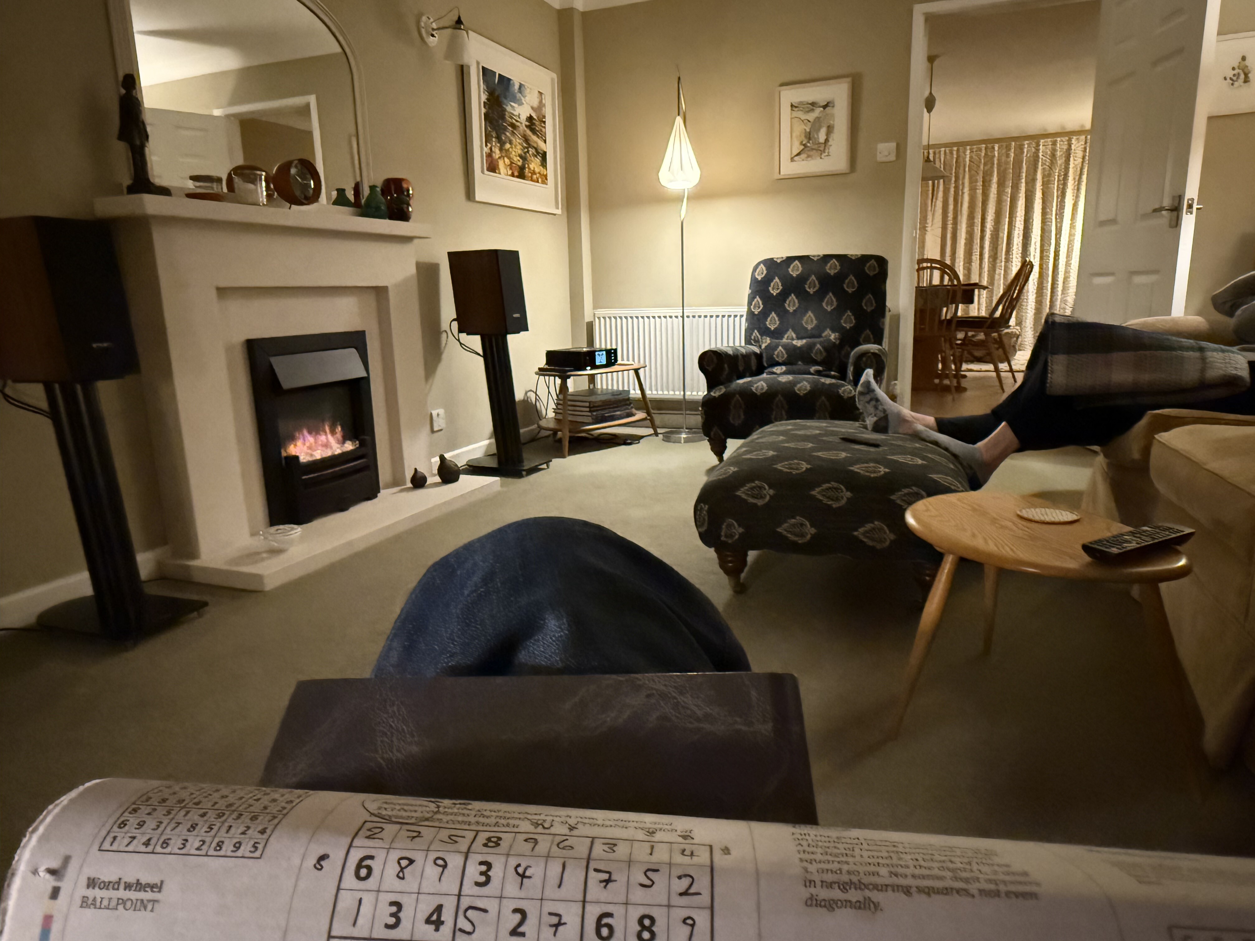

I never see folk showing room treatment?
I use Mrs HH to deal with reflections off the back wall.
Does she wear an acoustic smock?

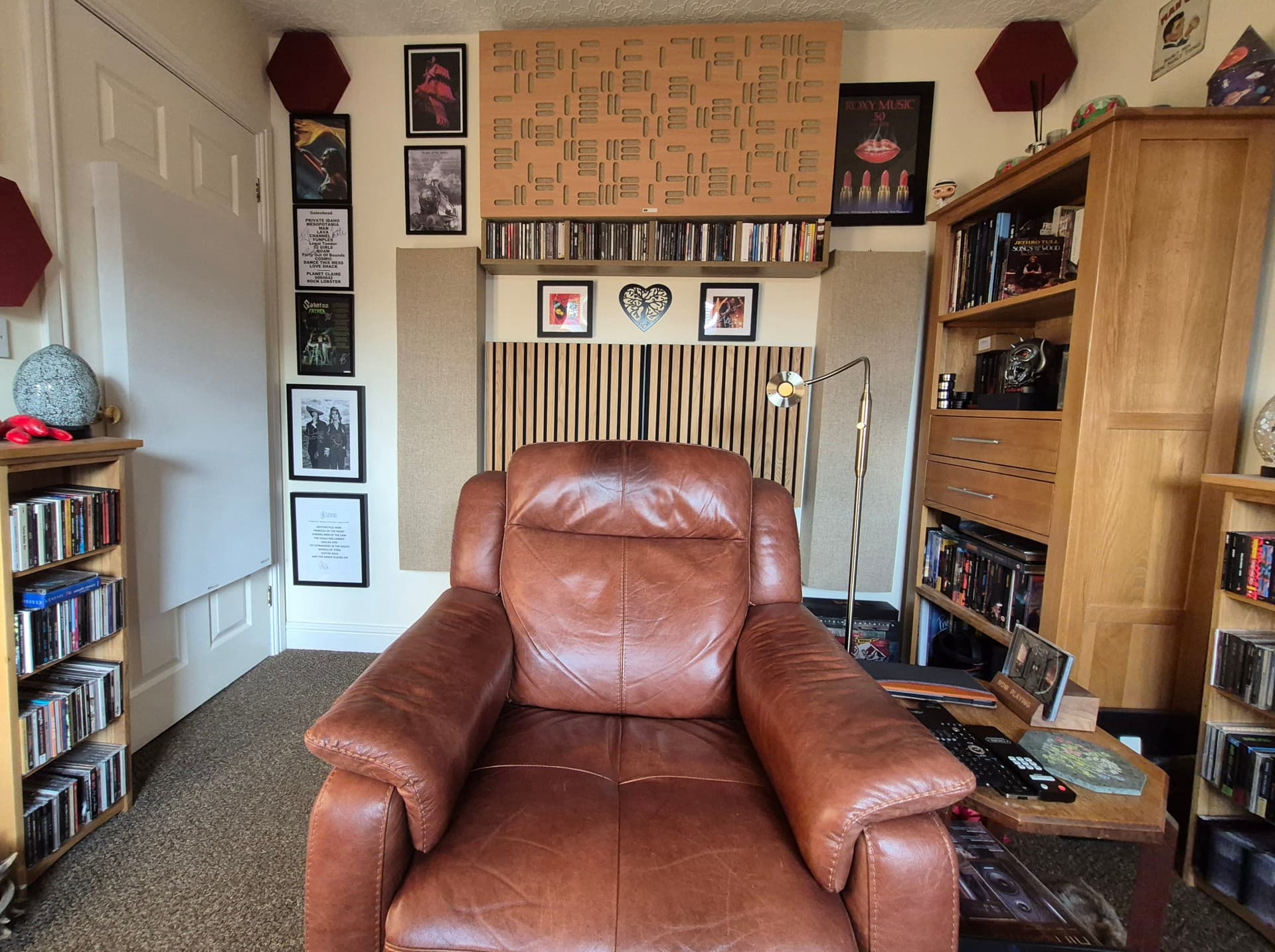

My acoustic panels

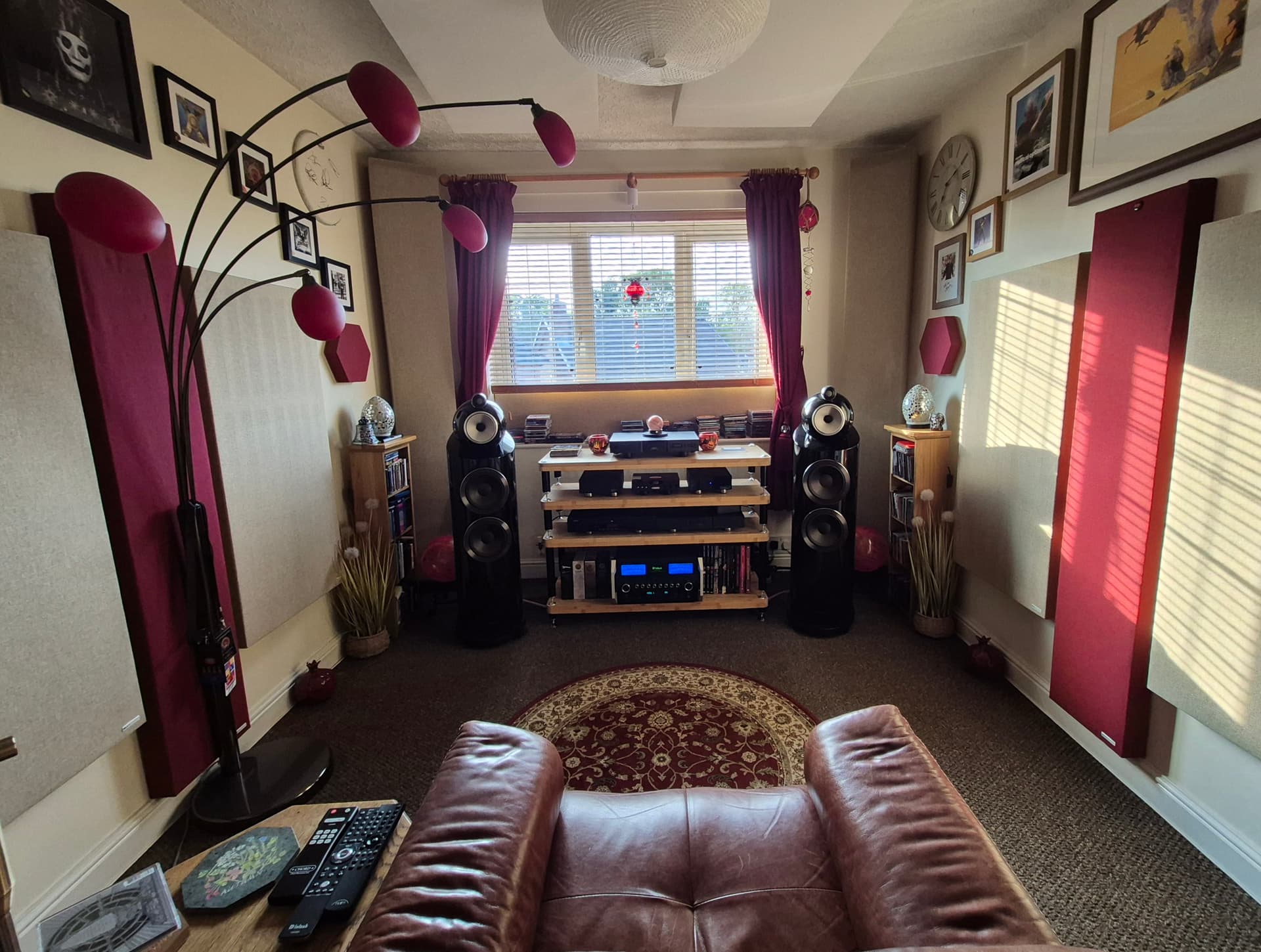

Small room so BIG bass traps (GIK Monster and Corner) behind speakers and 242 panels to remove reflections from side and back walls.

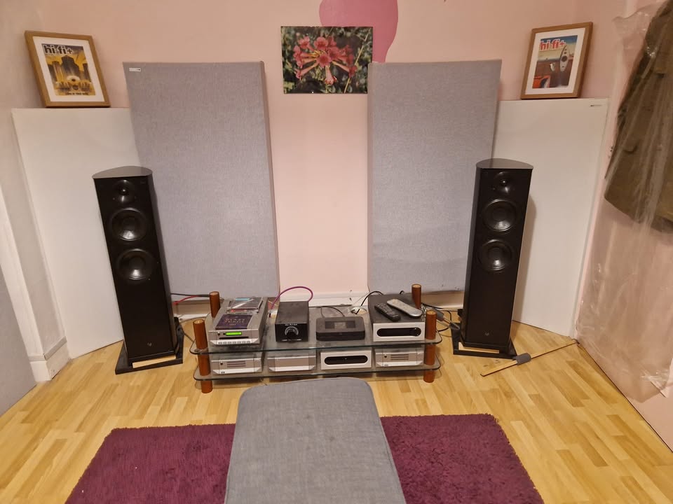

Thinking of aesthetic acceptability for some, your pic provides an opportunity for example (but certainly not meaning this as a criticism of what you’ve done): The corner traps could have another added on top taking up to the ceiling (might need a custom height) then they’d be virtually invisible,. And if desired that could even be completed by putting skirting board in front. And if the panels on that front wall were colour keyed precisely to the pink feature wall colour, which people like GIK can do if given a sample of the colour or the Pantone reference, they would scarcely be noticeable, instead of standing out as acoustic panels as they do now. The corner panels of course could be coloured the same way, the weather that or white as a nice contrast is nicer of course is down to the individual (or other household members!).
Do you think doing the corners floor to ceiling makes a different re just halfway up. I was contemplating going floor to ceiling in the corners and GIK recommended it too but real life experience is always valuable!
Gary
My understanding (but I haven’t yet had the corners ready to be able to do in practice) is that it is difficult to do enough bass trapping, so floor to ceiling better where it can be achieved. And bass traps are most effective in a corner where three surfaces meet compared to just two, so if, say, using two 1.2m tall traps in a wall corner of a 3m high room, it is more effective to have one at the top and one at the bottom with a gap between than the two sitting one on top of the other on the floor, though much difference if makes audibly I don’t know!
I bought all the panels off ebay so didn’t have a choice of colour. My wife is happy as this is my office/dedicated listening room! I have thought of buying another pair of corner panels but the room has 2.6m ceiling height so I am not getting many ceiling reflections (I think!)
