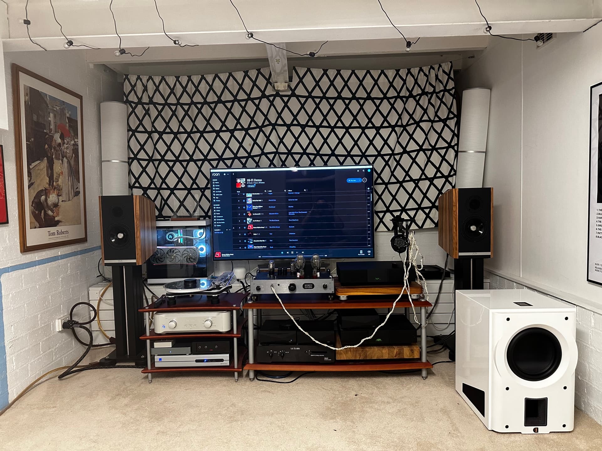

So Iā€™ve had the s510 for 3 weeks now. Itā€™s is a big improvement over the T5x, but you would expect so, given the price. I was impressed with the T5x though, just didnā€™t work with isobaric speakers. The base response is much faster with the s510.
Am I sold on subwoofers? Yes I think I am. They add more than they take away. Overall very happy with the REL s510.
