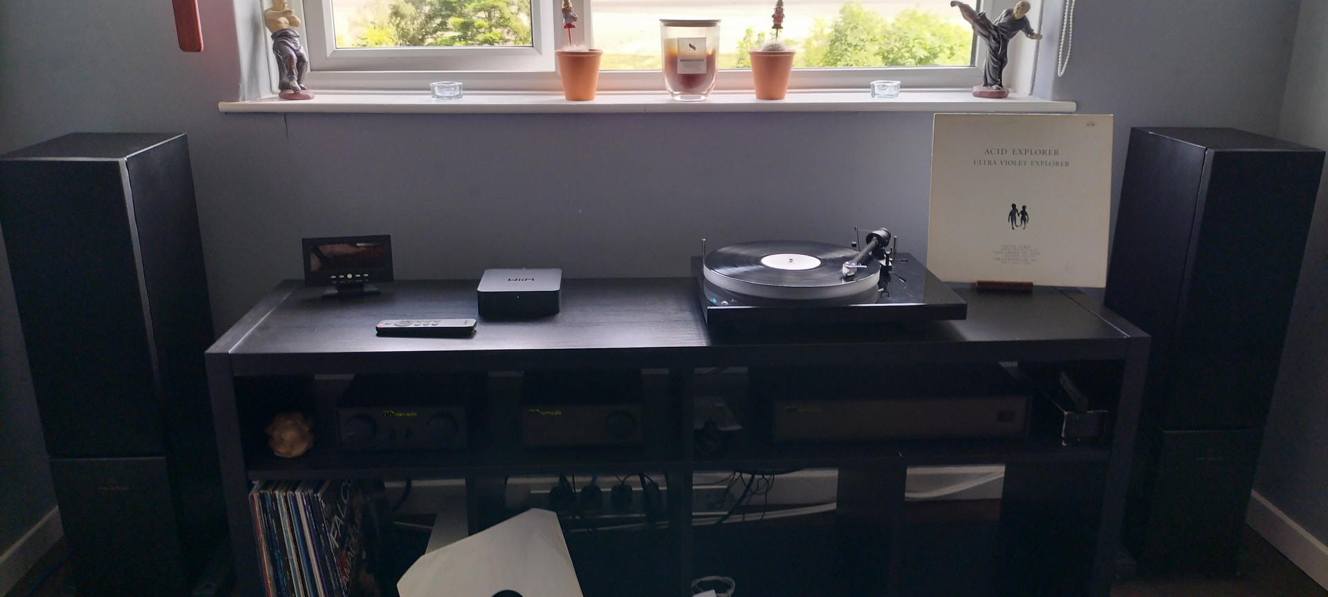

Hi Everyone, I need some advice.
This is my second system.
Amplifiers
Naim Nac72, HiCap and NAP 180 all connected with Black Snaic cables. Naim NACA5 speaker cable.
Sources
WiiM Pro Plus streamer
Marantz cd 63 ki signature cd player
Project Debut Carbon Esprit SB Turntable with AT CO9XEN MC Cartridge, Aluminium sub platter, new belt and bearing oil. It is seated on a heavy spiked plinth to help stop vibration.
I have Chord Chrysalis interconnect for the streamer which goes to the tuner input with a 5 pin din phono adapter.
The CD player is connected to the auxiliary input with a Chord Chrysalis with BNC Adapters.
My Turntable has a 2 metre cheap copper cable with BNC Adapters to the phono input on the Nac 72, I have the K Board in and it sounds better than great.
Speaker System
Original Linn Kan mk1 on original Linn Stands.
My question is I have been unhappy with the sound of the system and struggling to want to listen to it. I have replaced all the interconnects with the ones above from R A KCAG to all copper cables and the difference is amazing and I can listen to it for a long time and enjoy the time spent. I know the Chrysalis interconnects are only found on the used market. What new cable’s would you suggest for all three components. All amps and HiCap have been Serviced in Sheffield.
Finally is it ok to use the adapters in the short term and will they cause any issues.
Thank you in advance.

I tried the MA BX2 Speakers they are ok, but not with this Naim setup. The Ruark Icon speakers sounded very warm and detailed. I could live with them very easily. The LP12 with the Kans sounded very nice, as expected. I think I will be the owner of 2 LP12 this year. I tried the LP12 with the Ruark Icon and it proved the source is a significant contribution.
The Kan is a great speaker and sounds very detail and makes you listen, but the Ruark Icon left a very positive message with the LP12 playing through them. It’s has surprised me how good the Ruark Icon and the Naim amps with the LP12 sounds together. I just expected the Kan to be the better speaker by a long way.

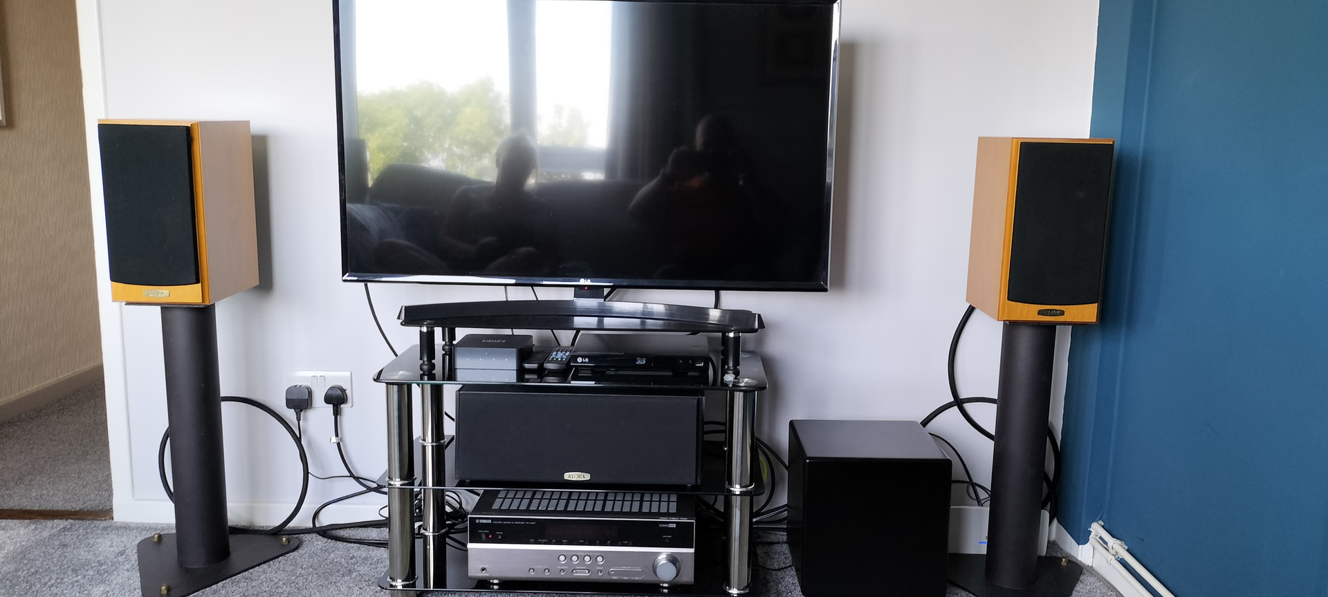

After all the messing around with speakers and turntables. I came home from a weekend away in Scotland. Thought I would watch a little bit of TV. Minutes into the watch my AV Amplifier went pop and destroyed it self. Tried to re-start it and no it was going to hi-fi heaven.
So I got a replacement and set it up, didn’t sound like my old amp. I changed the speakers with my Ruark Icon. Which were going to be used with the second Naim system. I put the Ruark Icon on the AV system and Ruark Dialogue one centre speaker and yes great back to film enjoyment and happiness.
My Linn Keiledh from the AV system are having to replace the Ruark Icon with the Naim and they are a very good substitute. They do sound better than when they were with the AV setup, the WiiM Pro Plus streamer sounds better and more fun. I am enjoying the Linn and Naim combination they seem to just have a great synergy.
The Linn Keiledh have some of the attributes of the Kan and the Ruark Icon, I think they are a win win situation. Still going to get an LP12 for the system.
