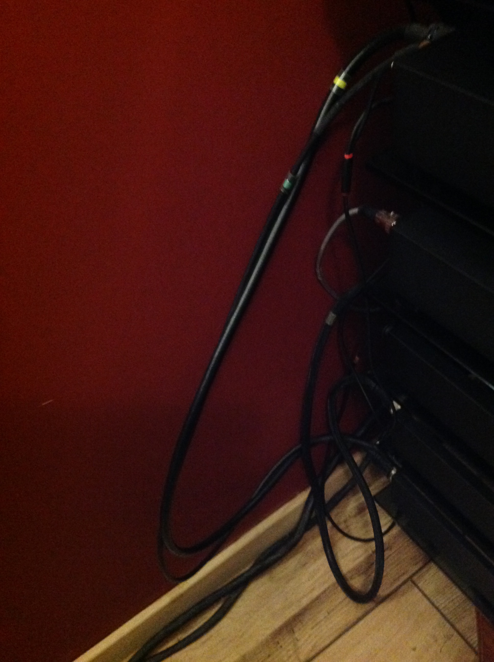

@angelodipa try and let the burndy and SNAIC hang togther from the 252 into the supercap (will try and find a photo of mine) with the 2 cables toching each other when possible

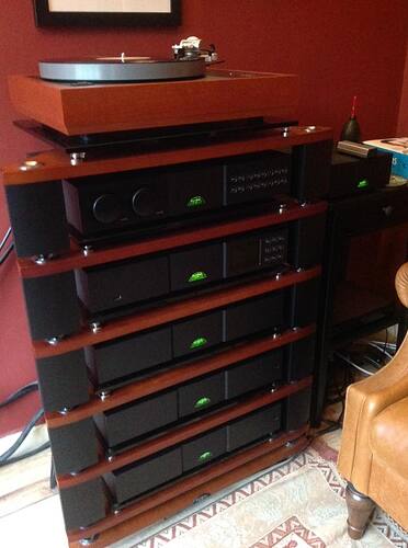

my 252 is on FRAIM the 252 is on the top and right on bottom 252/NDX/300/300DR/SC,
they are not touching the floor, as ever Burndy and SNAIC I tightern the locking collar

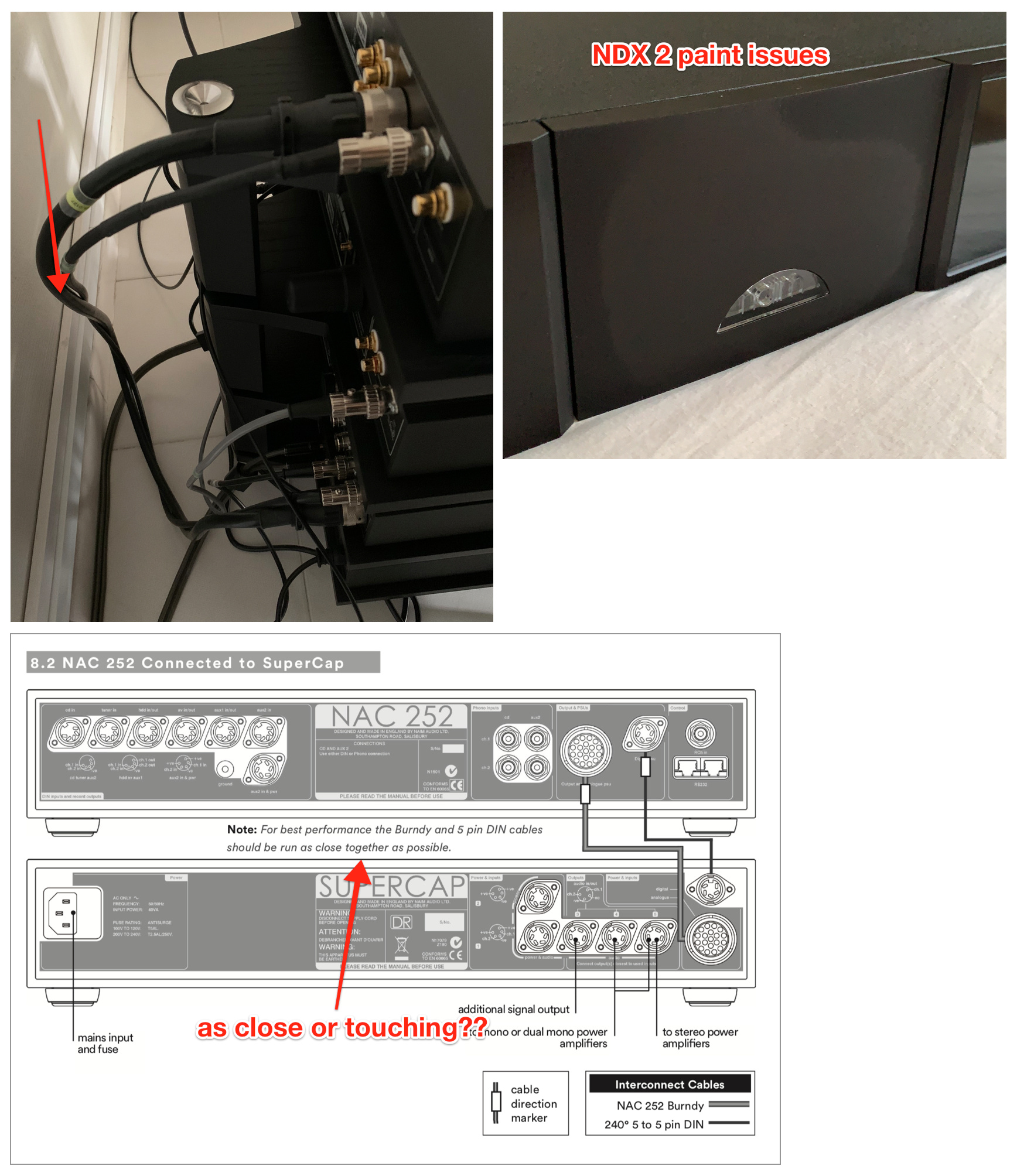

I recently replaced my Uniti Star with NDX 2, 252/SCDR and 250DR and my dealer advice me to not touch the Burndy power cable to anything at all. Whilst the guy who sold me the 252 said need to crisscross Burndy and SNAIC cable.
Pictured is how I crisscross which I think is probably wrong and worst of all it is touching the floor.
I am also confused by the manual saying “Burndy and 5 pin DIN cables should be run as close together as possible”, so does that mean it should not be touching too much.
My NDX 2 also got front paint issues, but dealer taking care of it soon :+1:
Soundwise I guess still waiting to burn-in probably, does not really feel very positive. I am it must be my setup of cable dressing :thinking:

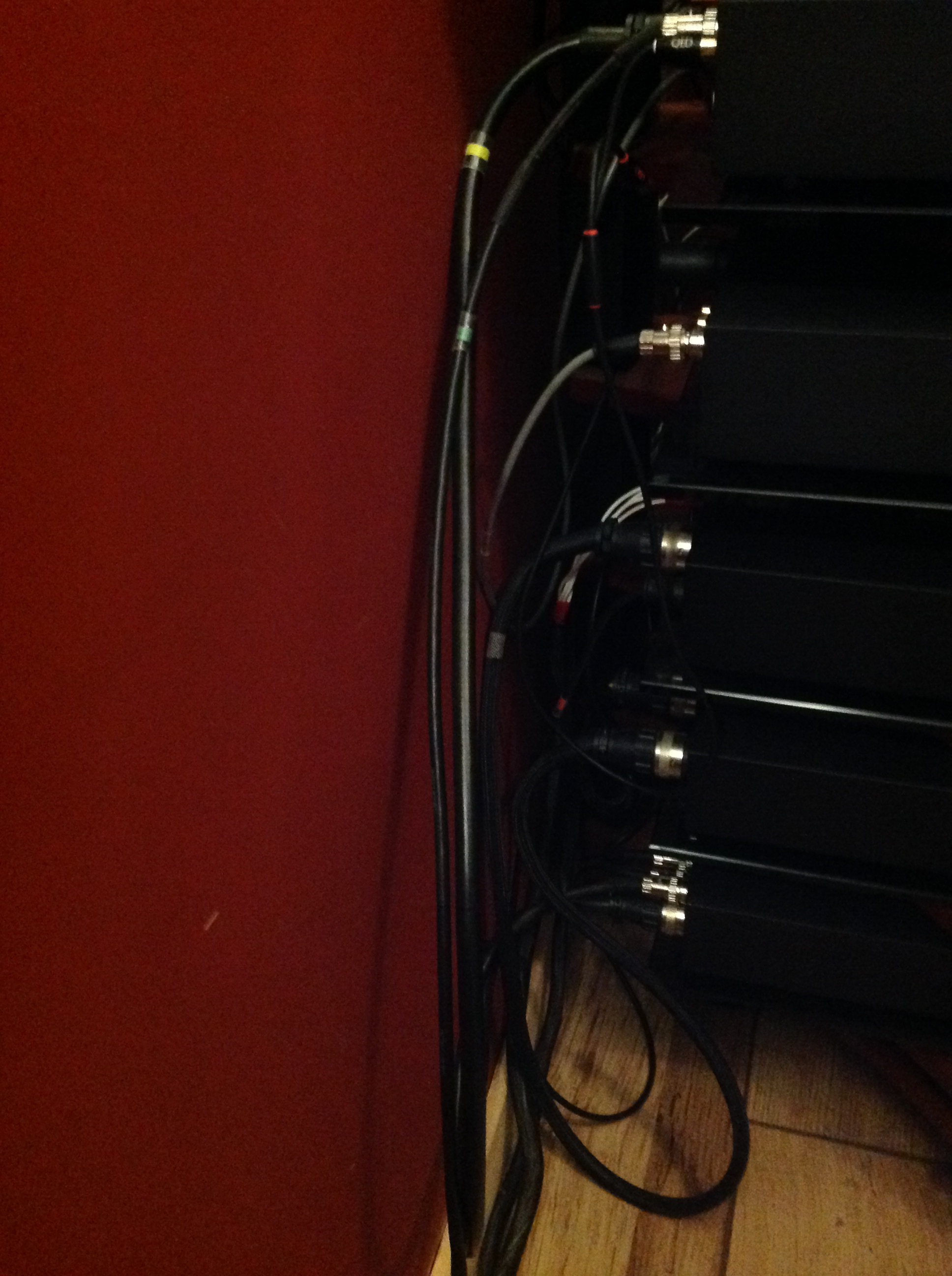

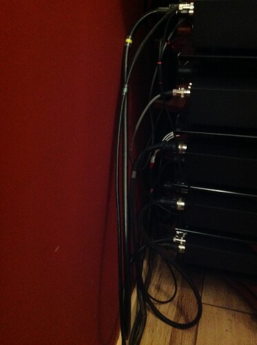

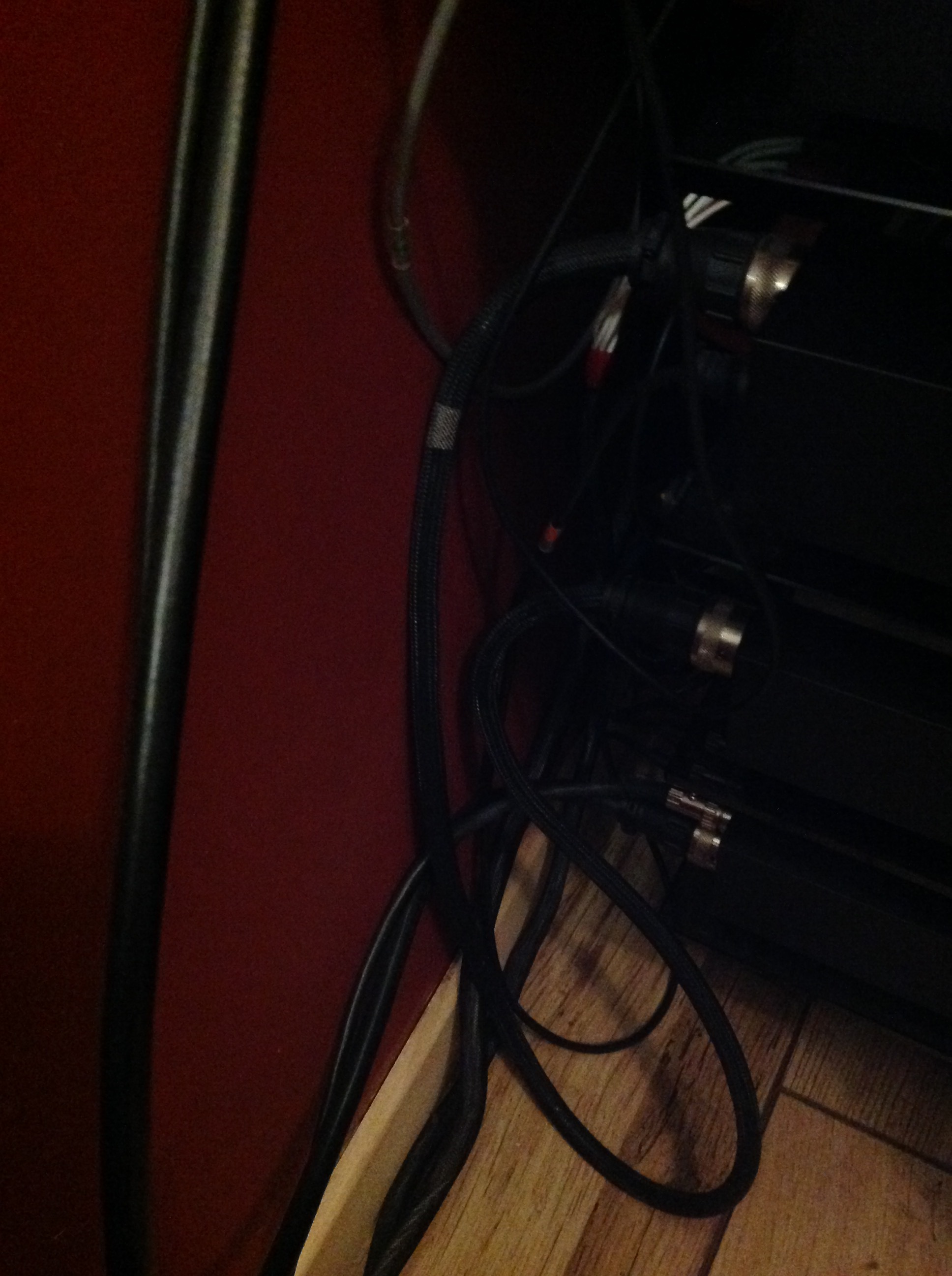

The burndy and SNAIC hang naturally in a G shape, under no tension, the cables are touching when possible, the other suggestion from my dealer is every so often under do burndy and stretch out and re fit
The 300 burndy are left to hang naturally with no tension
The reason for running the Burndy and SNAIC as close as possible is probably to do with induced currents which are proportional to the area and the magnetic flux inside a loop. Without knowing the design of cables etc one is guessing, but Naim want to keep it simple.
Brain and Brawn stacks can help with floor contact. More space behind the stack has benefits also.
