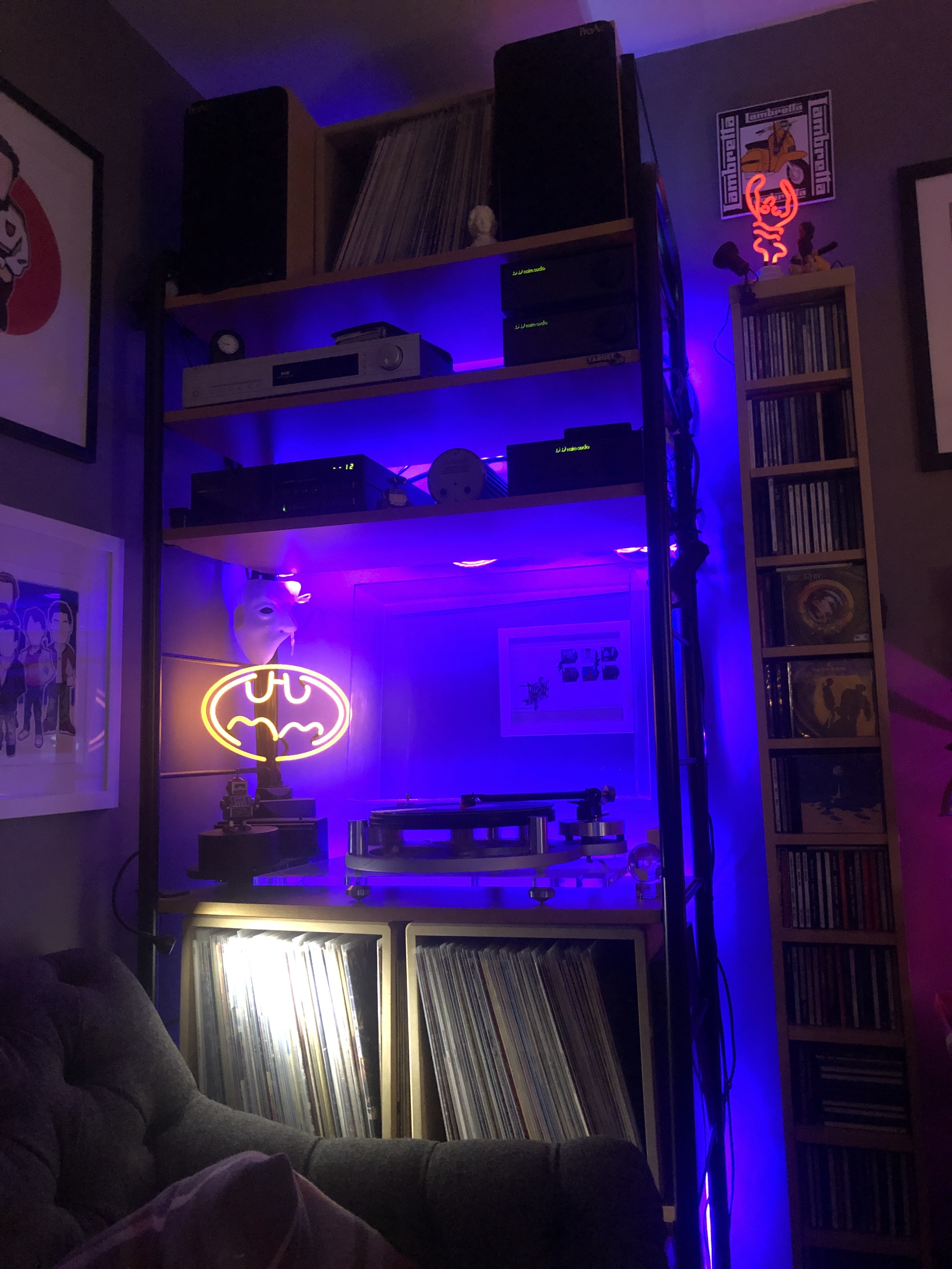

Be put together a set up for my study. Over the years it’s changed here and there and now consists of :slight_smile:
Nac62
Nap140
Hi cap (all olive)
Gyrodec with rb300 and a Ortofon bronze
Meridian cd
A cheap Cambridge dac for streaming
A Cambridge dab tuner
Proac speakers. Mounted way too high on a shelf.
The room is small. It’s a small study
My issue is that between my left and right channels I get quite a different sound. More bass on right , more treble on left.

The ALPS remote selector in the NAC62 can get worn and dirty. It may be worthwhile trying to clean it. Otherwise, contact Naim with the serial numbers to check on any service history. Servicing is recommended every 8-10 years.
you could probably switch around the speaker cables, and then the source left and right connections to see where the issue follows
