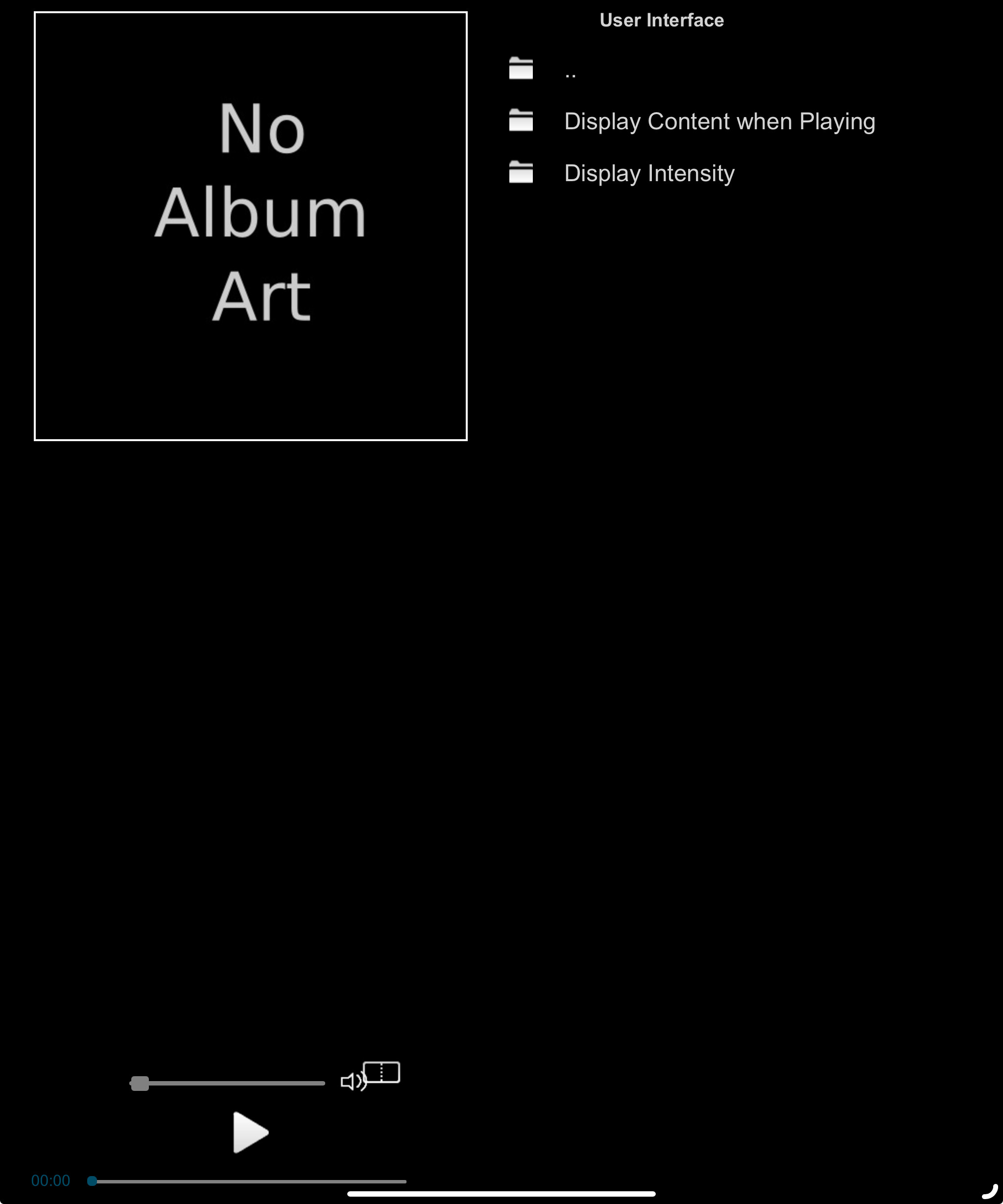

If you have no success after the the power off, type in your browser ipadress/webclient and go to settings
