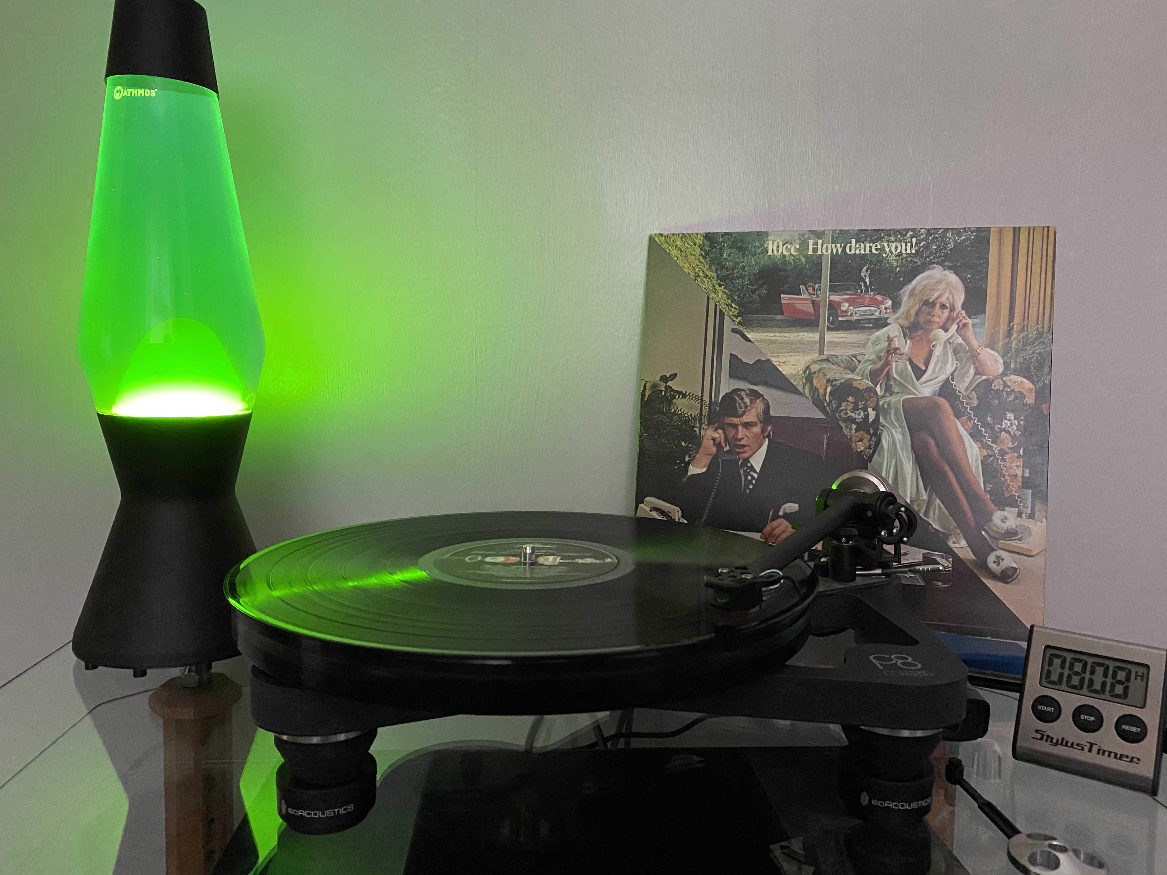

I have an ATVM95 Shibata on my Rega P8.
AudioTechnica suggest 800 hours on the stylus, which is hilarious (my dealer thinks 1500 should be easy). All my vinyl has been cleaned multiple times and I am recleaning it all as I work my way through all my vinyl A-Z on my ProJect VCe.
I have a stylus timer and, as I listen now, it’s done 808 hours since I bought my P8 on the 28th February 2020.
Still sounds as good as it ever did - but my only real way to tell would be to swap it out for another stylus (if I had a spare). Such a hard thing to determine as we are mostly naturally inclined to think “does that sound normal?”, “is that more sibilance near the end of the side than normal?” etc.

My VM95 SH is now just under 12 months since fitted to my P8, and hit 820 hours so far. Still sounds great, is used on well cleaned vinyl and I check the set up regularly :+1:

May I ask what protractor is used for your pictured VM95sh ?

I use the one supplied by Rega to check the alignment but it was set up by my dealer when I got the P8 and there’s been no movement of it at all since new :+1:
