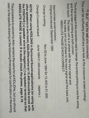

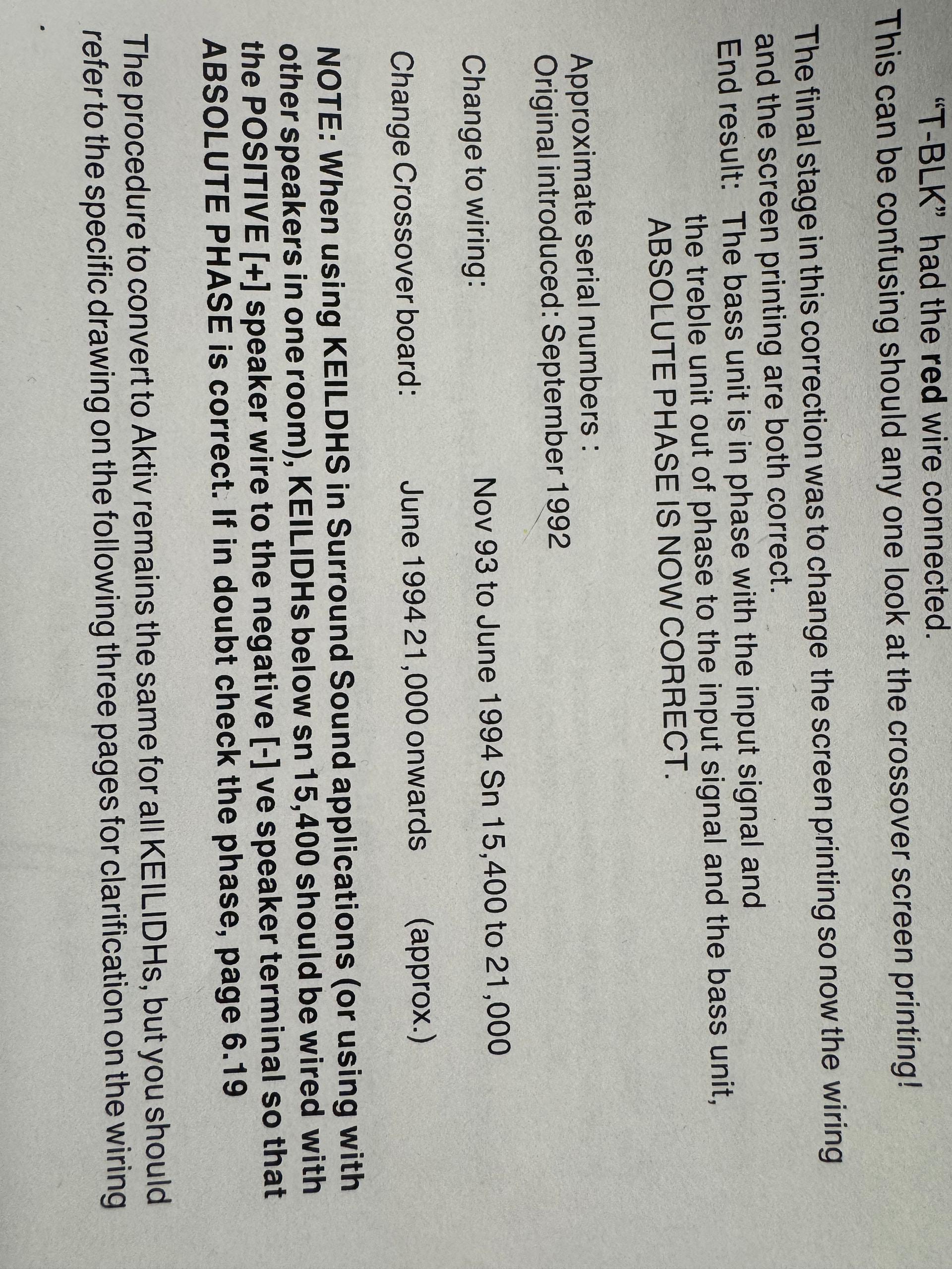

I still have my Keilidhs from 1994 and I use them as the rear speakers on my 5.1 system. I think they are great speakers and the key upgrades are the stone stands, renewing the tweeters if you had the Mk1 or Mk2 tweeters and the recap of the crossovers. The Hiquphon replacement tweeters are excellent and give a great improvement and recapping is easy to do and gives something extra. One key document to source is the Keilidh service manual from Linn. This is essential reading. You also learn that plus and minus are switched on early speakers (as indeed are mine) so you need to connect them out of phase with your other speakers in a 5.1 system !! The manual even tells you the serial number where they corrected this error ! Have fun - these are great speakers for their age and value.
HHB don’t leave us tied to that rock like Prometheus, spare us the pain and spill the serial numbers!
From the Asgaard chronicles: SN15400-20000.
Sorry about that- it is any speaker with a number below 15400 is out of phase
