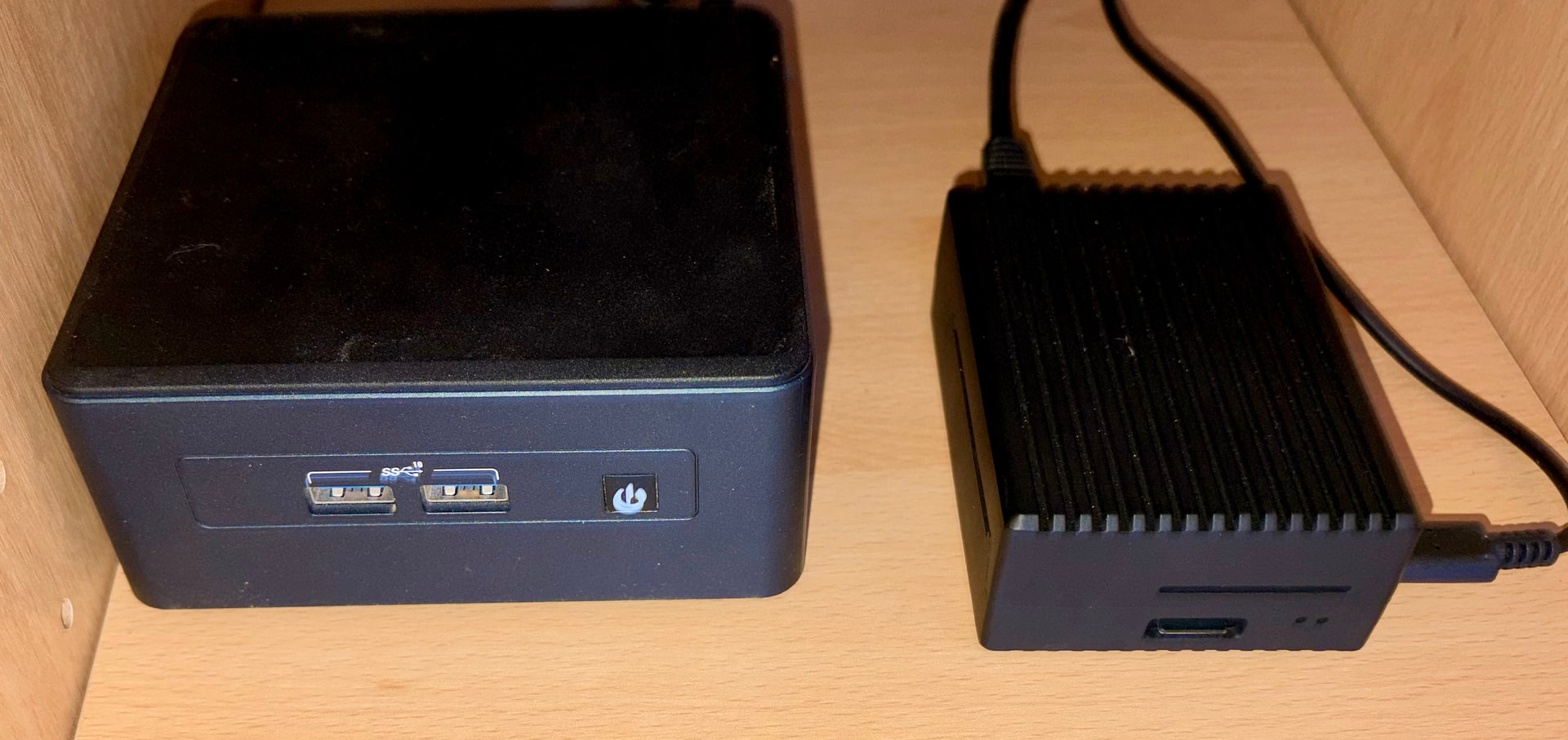

My music server gear is in the basement including my Roon ROCK NUC and rooExtend/rooUPnP RPi…
It looks like we have the same passive, aluminum RPi case :slight_smile:
As an official Roon Extension, it’s really nice that the rooUPnP settings are configurable within the Roon app itself.
