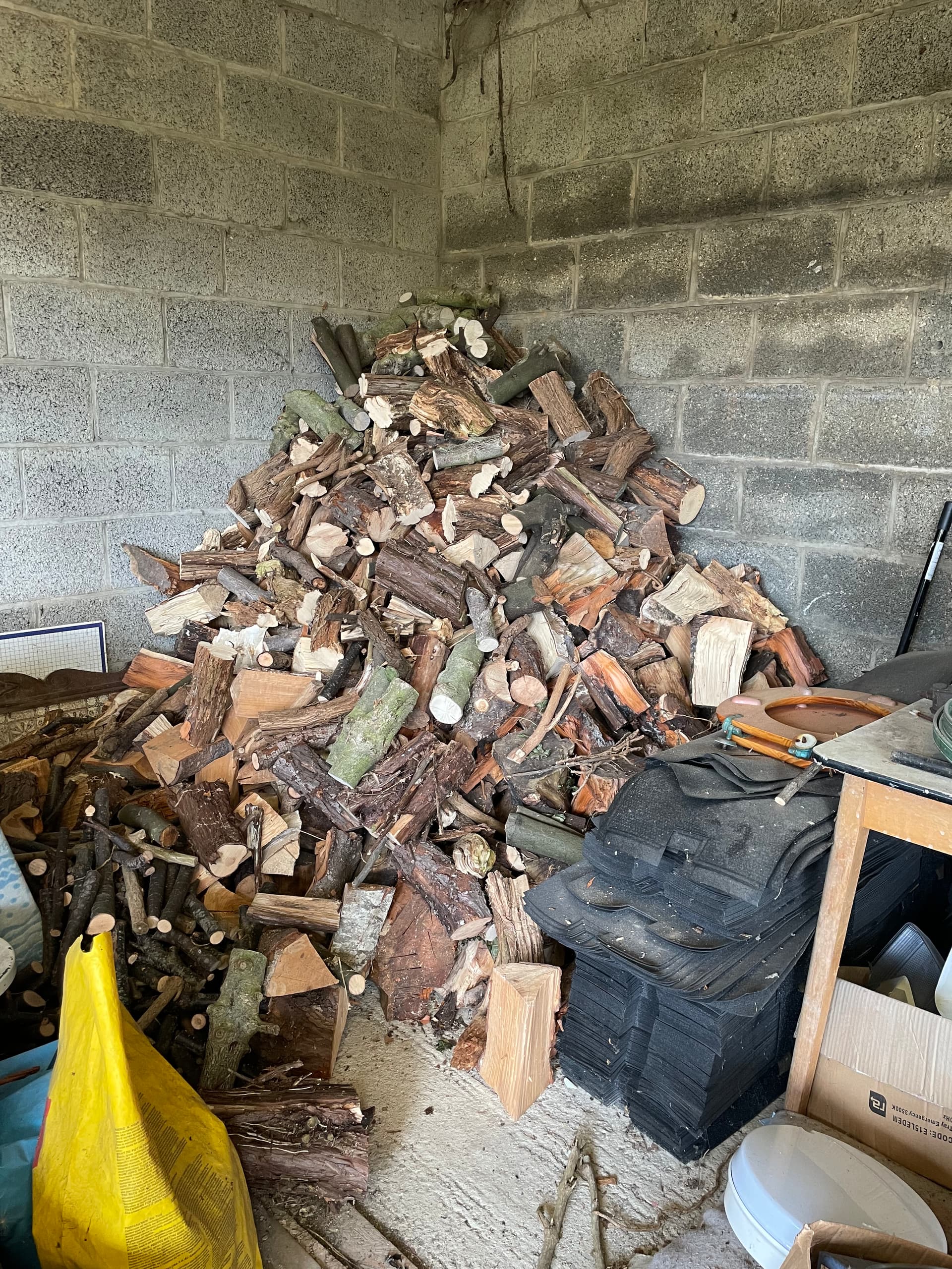

Plant a tree thats suitable for burning in a log burner and see how long it is before you can light you fire, and then see how long that one trees supply of wood lasts. Nice to have as a feature but simply not sensible as a means of keeping your home warm.
My wood comes from a tree surgery business, they are expected to remove the fellings…….it is a substantial amount they collect per week. It would most likely be burnt to get rid of it……but not enough for commercial use as wood chippings.

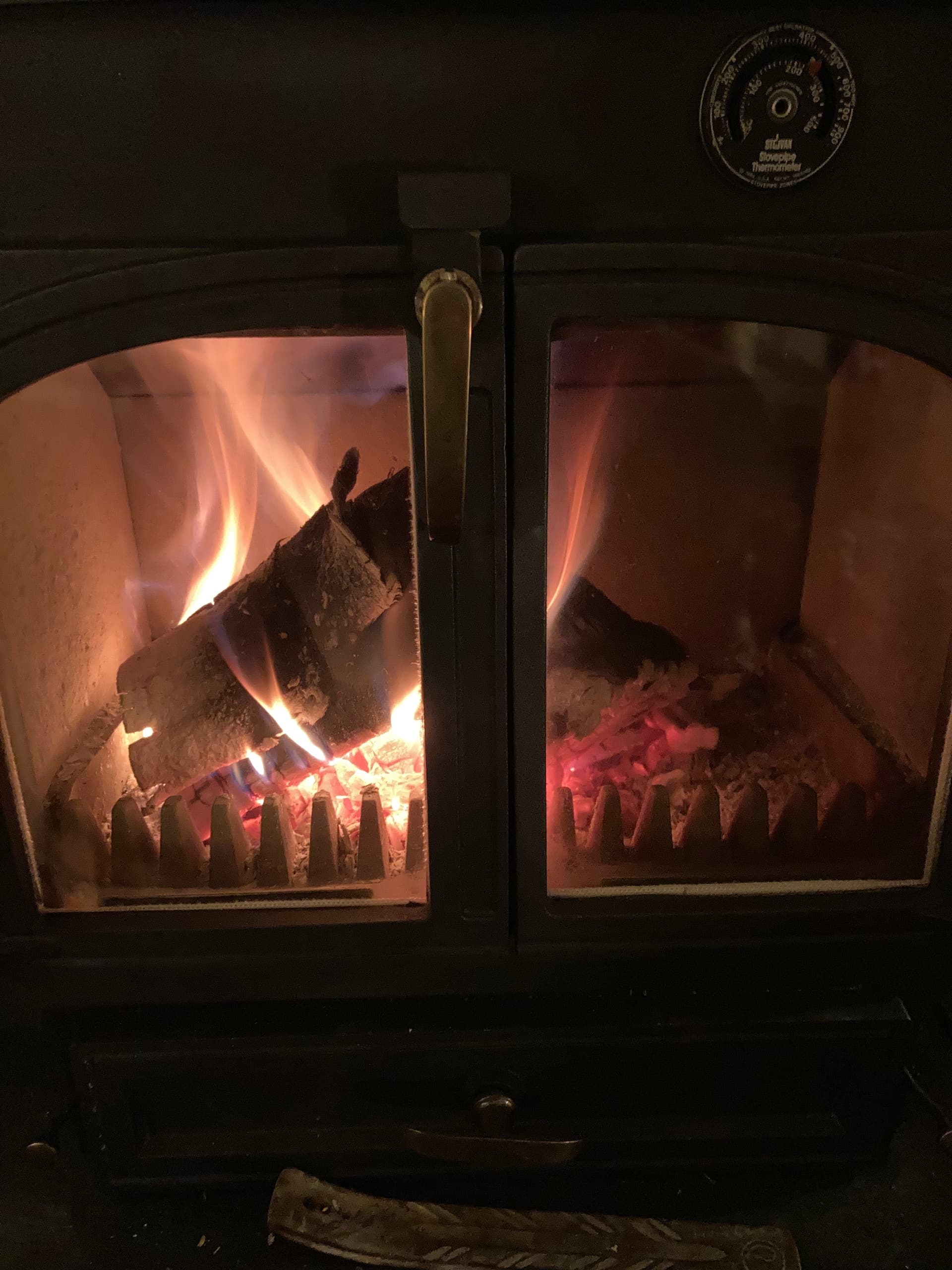

Zero degrees here tonight, the Clearview purring away at around 500C with a mix of lime and spruce

The downstairs dropped from 21c to 18c overnight so I must light the wood burner soon. It has been the only source of heat running 13 hours a day. The wood has been free and should last even if colder this winter than last.

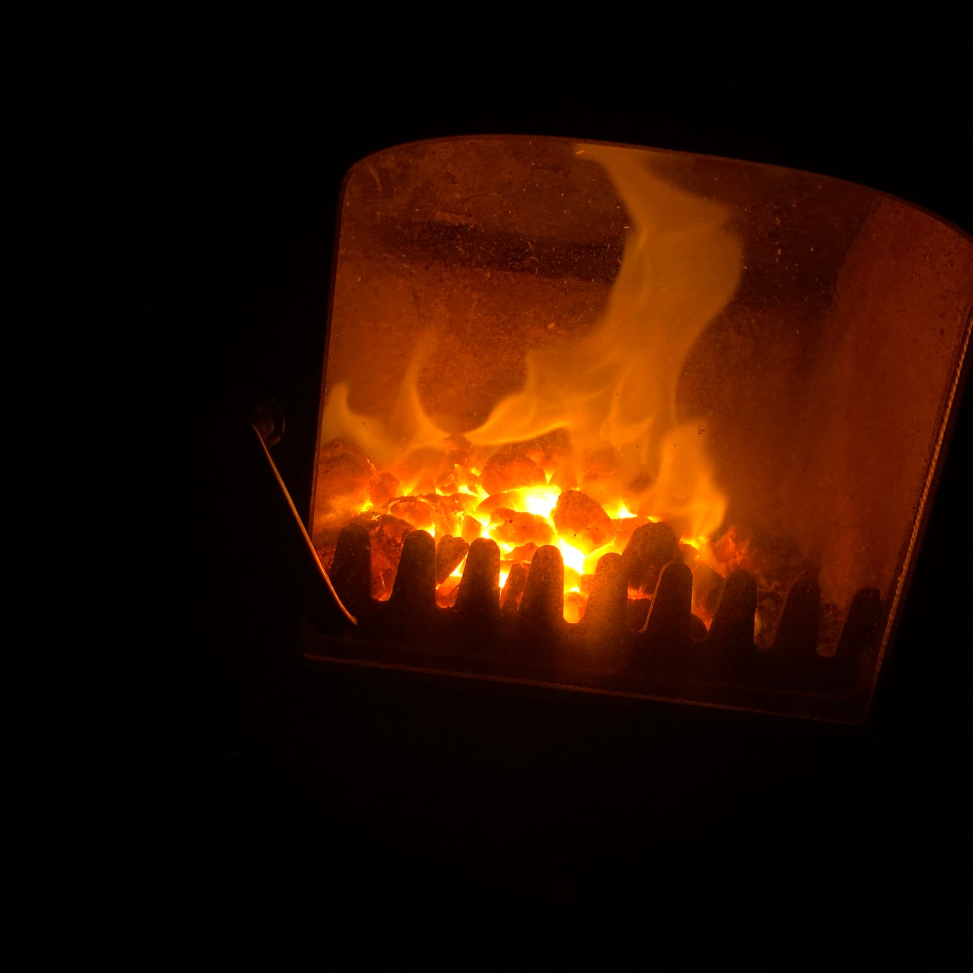

Only the second burn in my new stove.
(Fortunately only a slight pong of hardening enamel paint.)
Still trying to get to grips with the operation of it. It has three air sliders: primary, secondary, and a thirdary (tertiary). Blimey eh?
Seem to have it going either rip roaring away mode, or dark and smouldering…
I’ll get the hang of it soon enough i’m sure :slightly_smiling_face:

I would say let it roar until the chamber gets hot enough and then shut both. If you shut them too soon it will smoke.
Just my guess. Don’t know about the third.
Phil
The instructions only say to Pull the tertiary air slider out by approximately 50%
I think the tertiary slider maybe an adjustment dependent upon the individual characteristics of the direct air supply to the stove, plus vicinity of dwelling, altitude, draught of chimney etc (?) …find its sweet spot and leave it there.
Instructions also say that; When the fire has become established, close the primary air (marked with a single hole) down by pushing the lever inwards.
and:
The burning rate can be altered by moving the secondary air slider (marked with a double hole) - push the lever inwards to close down and pull outwards to increase the burn rate.
That seems similar to what I do.
