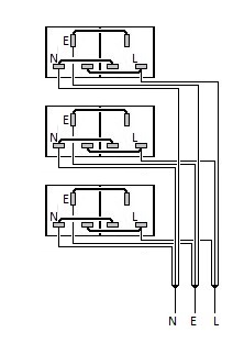

Yes 100% DIY - but only if you have knowledge/skill.
Mine has evolved over the years & the last upgrade was to 4mm/2 cable (the same size as a ‘full fat’ Naim PowerLine)
Titanex H07RN-F 4mm/2
Furutech FI-1363 13A plug (with Bussman of course).
3x MK Unswitched Double Sockets
x1 MK Swiched Socket (for aux stuff)
L N & E wired in Radial (Star)

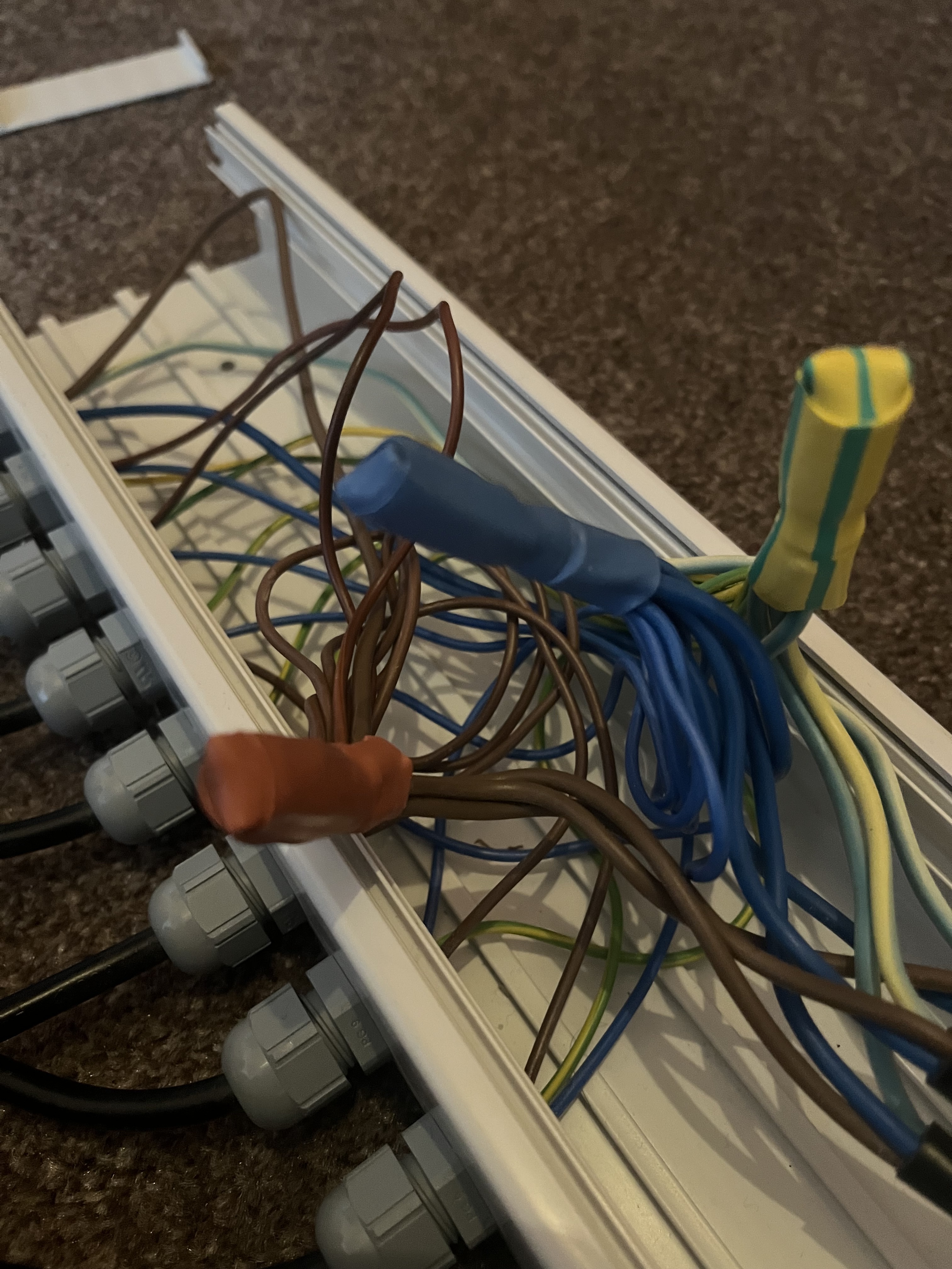

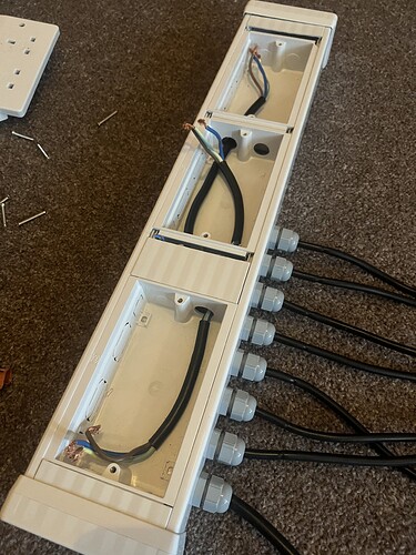

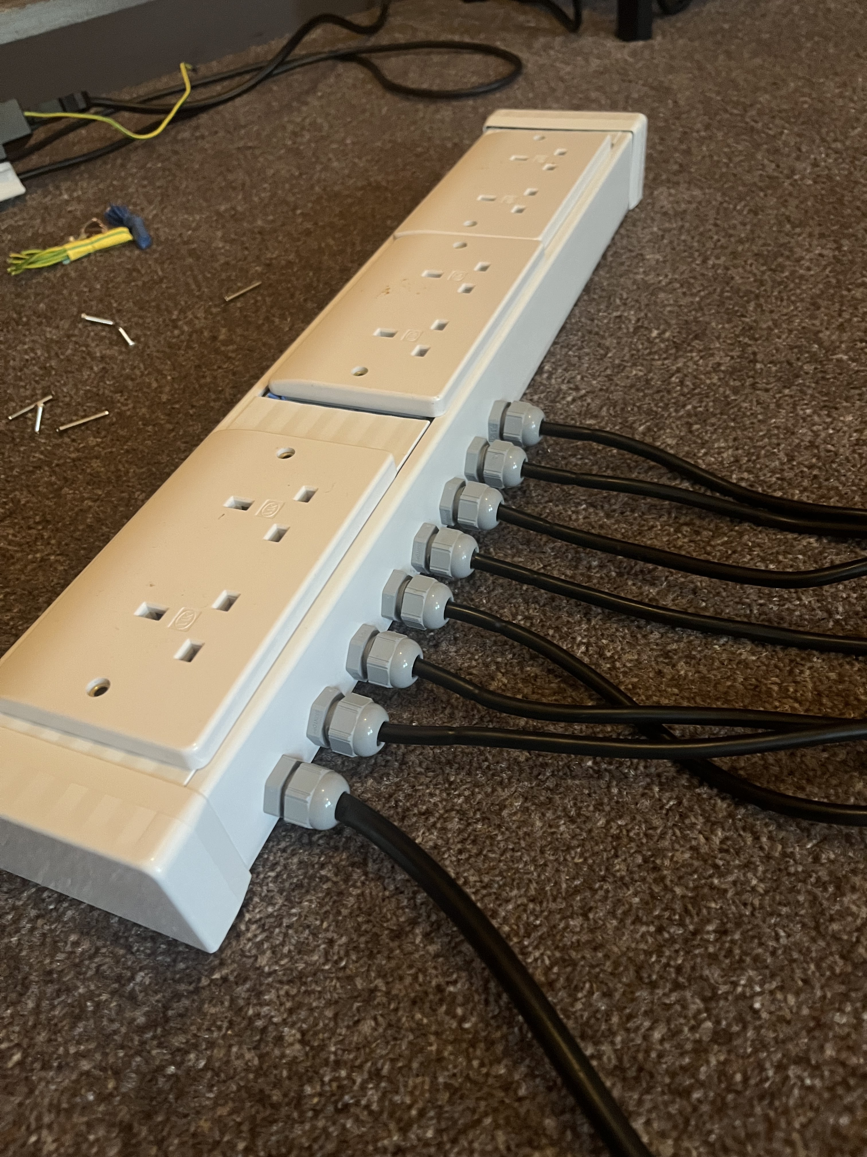

This was given to me by a family member,
Used to have a full naim active system
2006-2012
It cost 100’s of pounds back then he says,
So I was curious what so special about this, so lets take apart I thought,

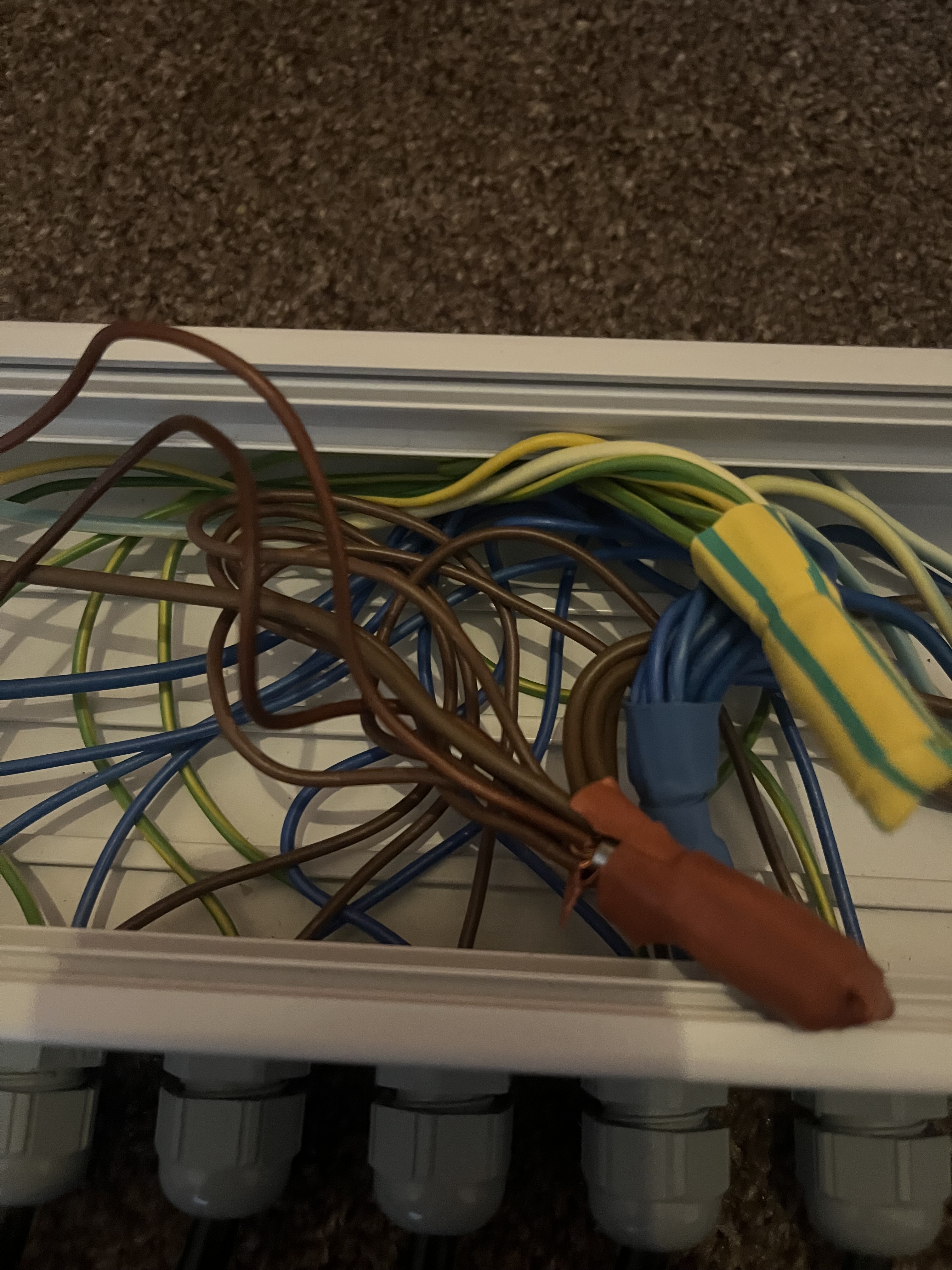

Ok looks like decent cable, let’s go deeper,

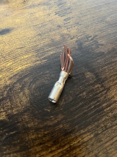

REALLY :thinking: this is what get,

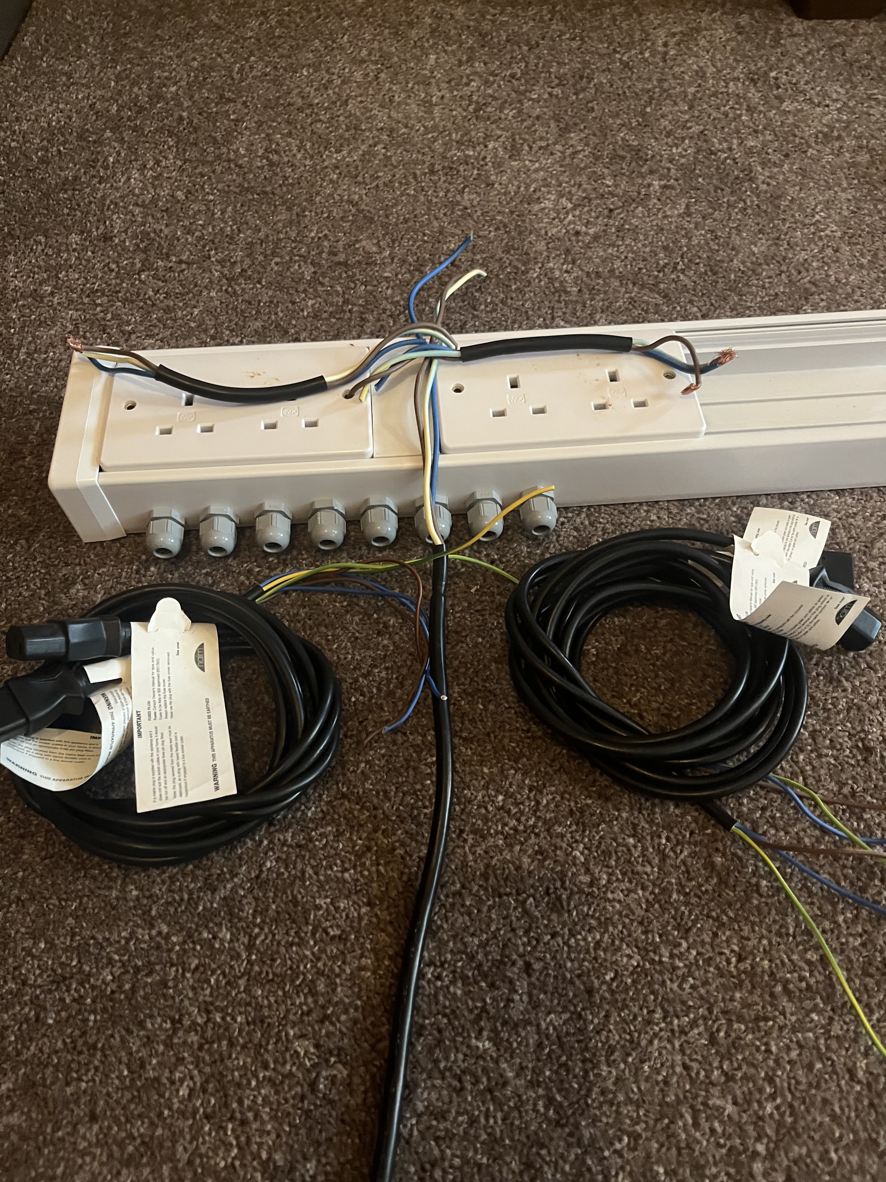

I can do better, going to make a 4x4 out of it, then hard wired to dedicated main,
But in the meantime I’ll just make a simple 2x double socket
What I don’t understand is why if you are you are using crimping connections.
Why not feed the power from the opposite end?
