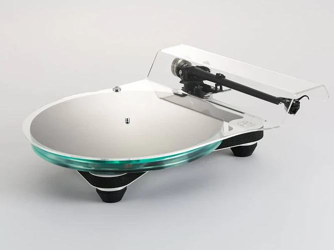

No. It has a little plastic cover that sits on the platter and covers the arm. It’s very easy to remove. There are loads of pictures on Rega’s website.

Spoke with my dealer. He feels the dust cover as you picture would be difficult for me, given my eye-hand coordination. He says that I need a hinged type. That leaves me with my current P9 ot a Linn TT. Is the Apheta 3 good enough given my system?
