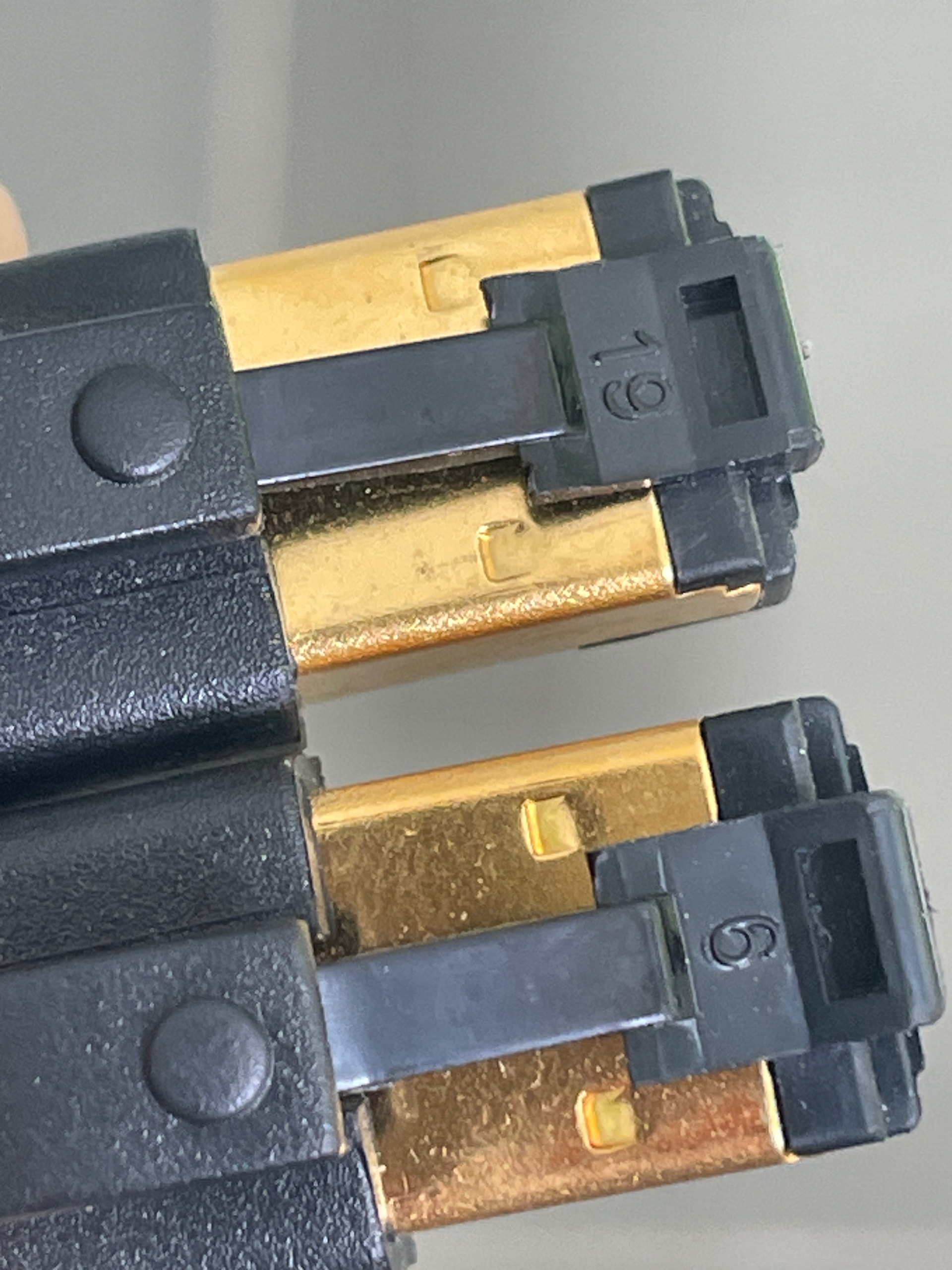

I’ve acquired a Melco C100 Ethernet cable which has asymmetrical grounding, but I don’t know which end of the lead is floating and which is connected to ground. Earlier posts on another thread suggested that the grounded end is marked with a Melco logo. Trouble is, both ends have a logo. Only difference I can discern is on the latching tab; one is marked ‘6’, the other ‘19’. Any suggestions? Does it matter, ultimately?

The plug with the melco symbol is the ground end, connected to your switch or router
The trouble is, BOTH ends have a Melco logo on the plug case…:thinking:

If your cable has the Melco logo printed on both plugs, I am pretty sure it is not a C100 but a C1AE which is the non directional predecessor of the C100. Had them both in my current setup and find the C100 way better…

With the c1ae I could not hear a difference changing the cable direction. The directional C100 Was better when connected with the logo plug on side of my switch when used between switch and my Melco player.
It was sold to me as a C100, so words may be had. I’ve contacted the distributor for comment, so we’ll see what transpires..

It’s confusing, isn’t it? My lead came from MCRU at a reduced price, but not in any original packaging, so all I have to go on is a visual inspection (and judicious use of a multi-meter).

A test with my multi-meter shows continuity between both metal shrouds on the RJ45 of the Melco. So, not floating, then?
