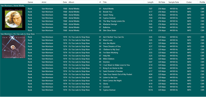

Never received any answer to my email sent on February 10, 26 and March 5. Below is a sample of just two albums that did not play with version 4.9.
When I try to play the same files loaded on a pendrive from the USB port, the music starts after a short hesitation.

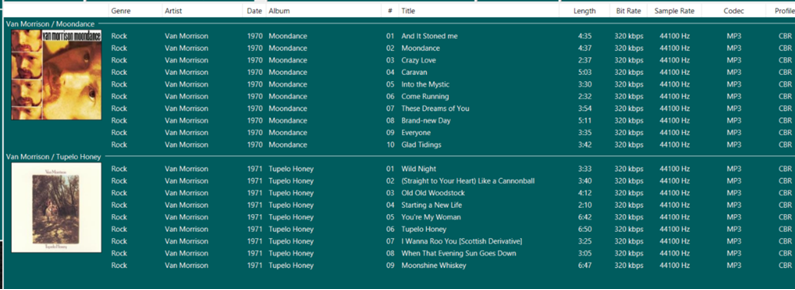

No problem with Moondance and Tupelo Honey albums, even though they are in Joint Stereo Mode.
