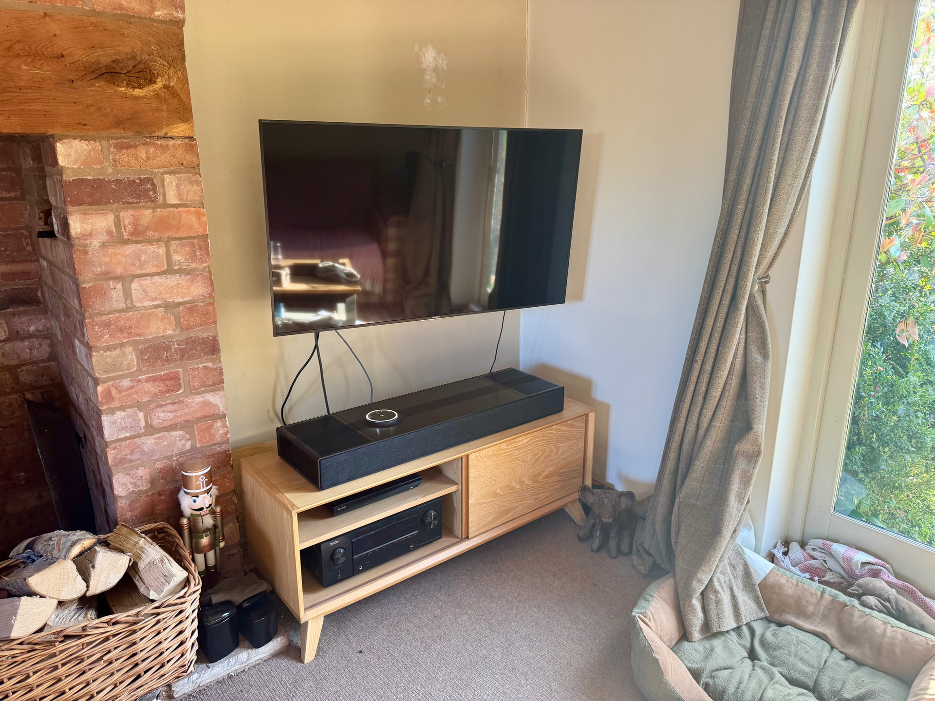

Might have something to do with what you have it sitting on?
Dedicated TV stand.

Possibly the corner positioning is the issue, might be interesting as a test to move it out to on front of the fireplace on a table and see if there’s any difference. Anyway, you’re never going to get any surround or atmos effects with it in a corner
Aye, that was something I considered but I had no issues with the Mu-so in the same spot. I know it’s in the wrong place for full on surround effect but I had hoped it would be better than it is.

I know there’s some compensation in the settings, but I think that positioning is possibly quite a problem in term of left and right walls.

Due to the nature of the side firing drive units, the Hekla really is designed to be out into the room, rather than in a corner.
It has been tuned for being in the middle of a room, and I agree that putting it into a corner can cause it to be heavy on the low end.
The DSP team are working on improvements to the ADAPT to identify when it’s in a corner to try and tame this a bit, but before that there will be a firmware update with some other improvements in terms of sound.
However, being situated so close to the wall will never give the proper surround effect, as the side firing units don’t have the room to angle the reflections to the right place.
We’re hoping to have the first update ready by early April, but I’m not sure that’s very helpful right now! Is there any way you could temporarily try it in the middle of the room, just to see if you like the unit when it’s not in a corner, and if it behaves a bit better?

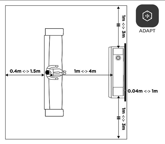

Is there any information on advertising literature/videos or operating instructions, advising there is a recommended minimum distance to a side wall.
Yes, it’s illustrated in the user manual under the “listening position Recommandation (sic)” section;
It would appear that you need to have at least a metre of space between the side of the Hekla and the wall.

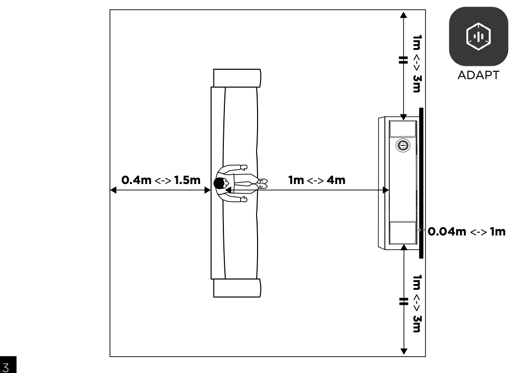

Listening position recommendation (fig. 3)
The product have been developed to deliver the most accurate sound immersive reproduction, whether it is used for Home Cinema and Music. However, a few simple rules should be followed to optimise their performance and to guarantee good tonal balance and a realistic sound image.
Ideally, the tweeter will be positioned between 25 to 70 cm from the floor.
The product should be equidistant from the left and right walls to recreate a symmetrical configuration. The listening position will be more enjoyable at maximum 150 cm from a rear wall.
Do not place the product too close to a corner of the room. This will have the effect of exciting certain resonances of the room and artificially increasing the bass level and surround effects. On the other hand, if the bass level is deemed insufficient, be sure the product is positioned close enough to the back wall to rebalance it.
Use later our ADAPT technology in the “Focal & Naim” application to set the position of your product in your room. ADAPT will tailor the audio output of MU-SO HEKLA to your room.
