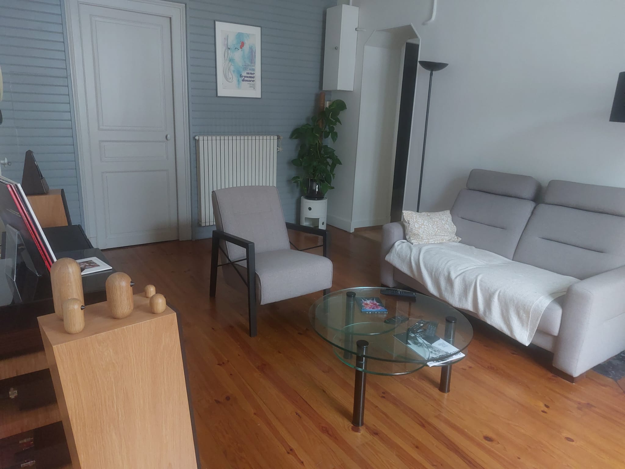

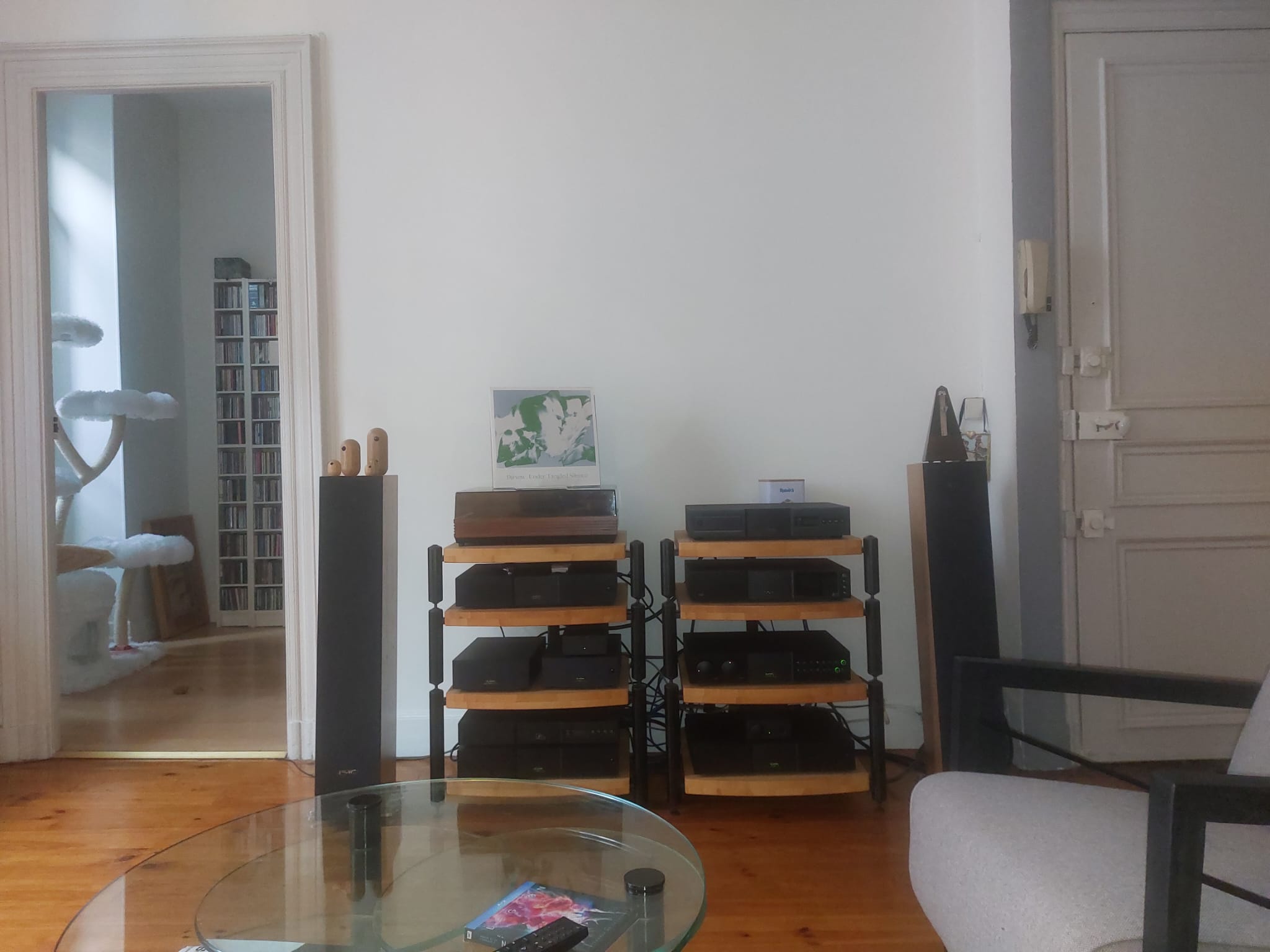

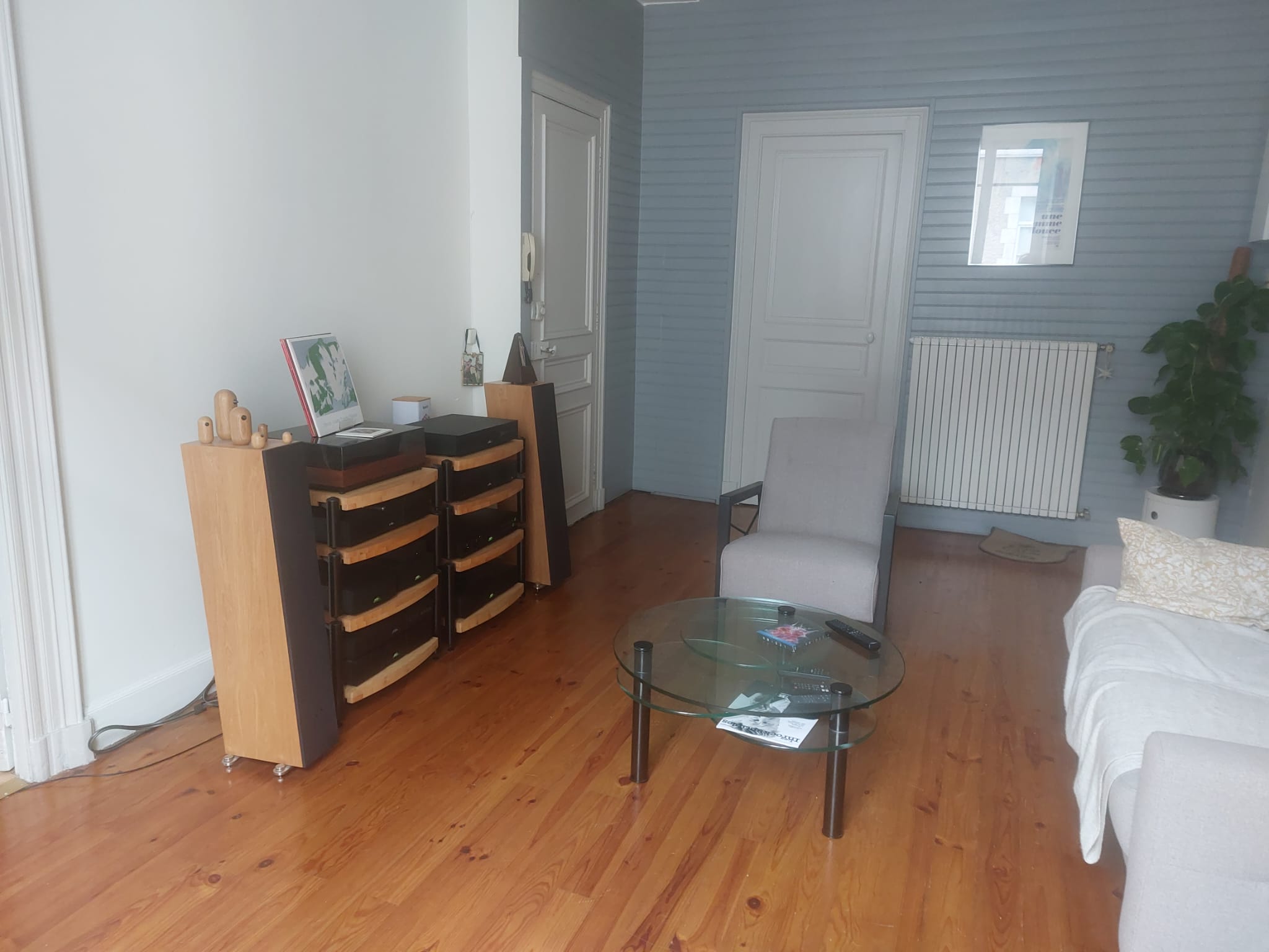

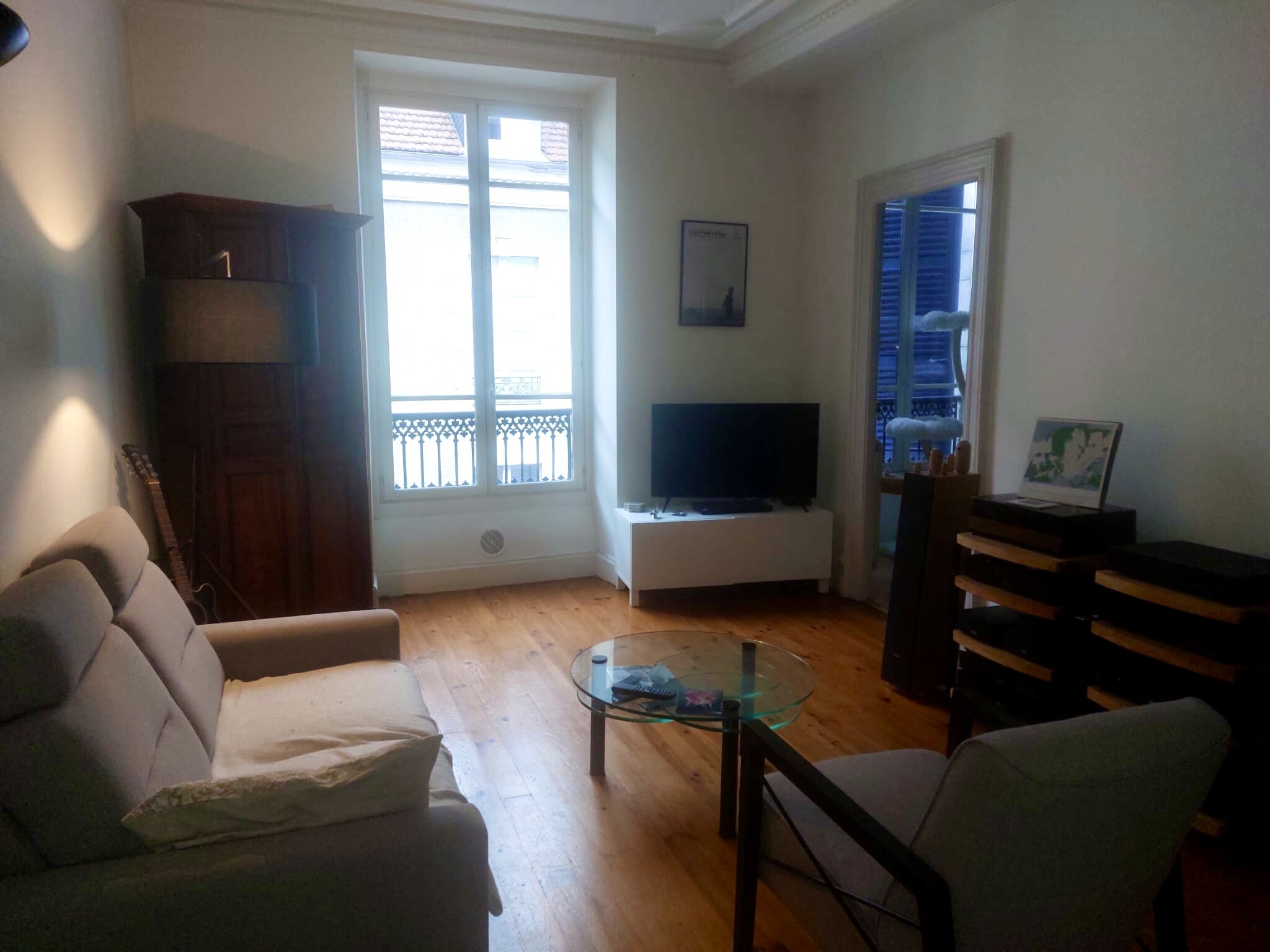

Hi again
Here’s how it’s set up today.
It matches the measurements I sent you.

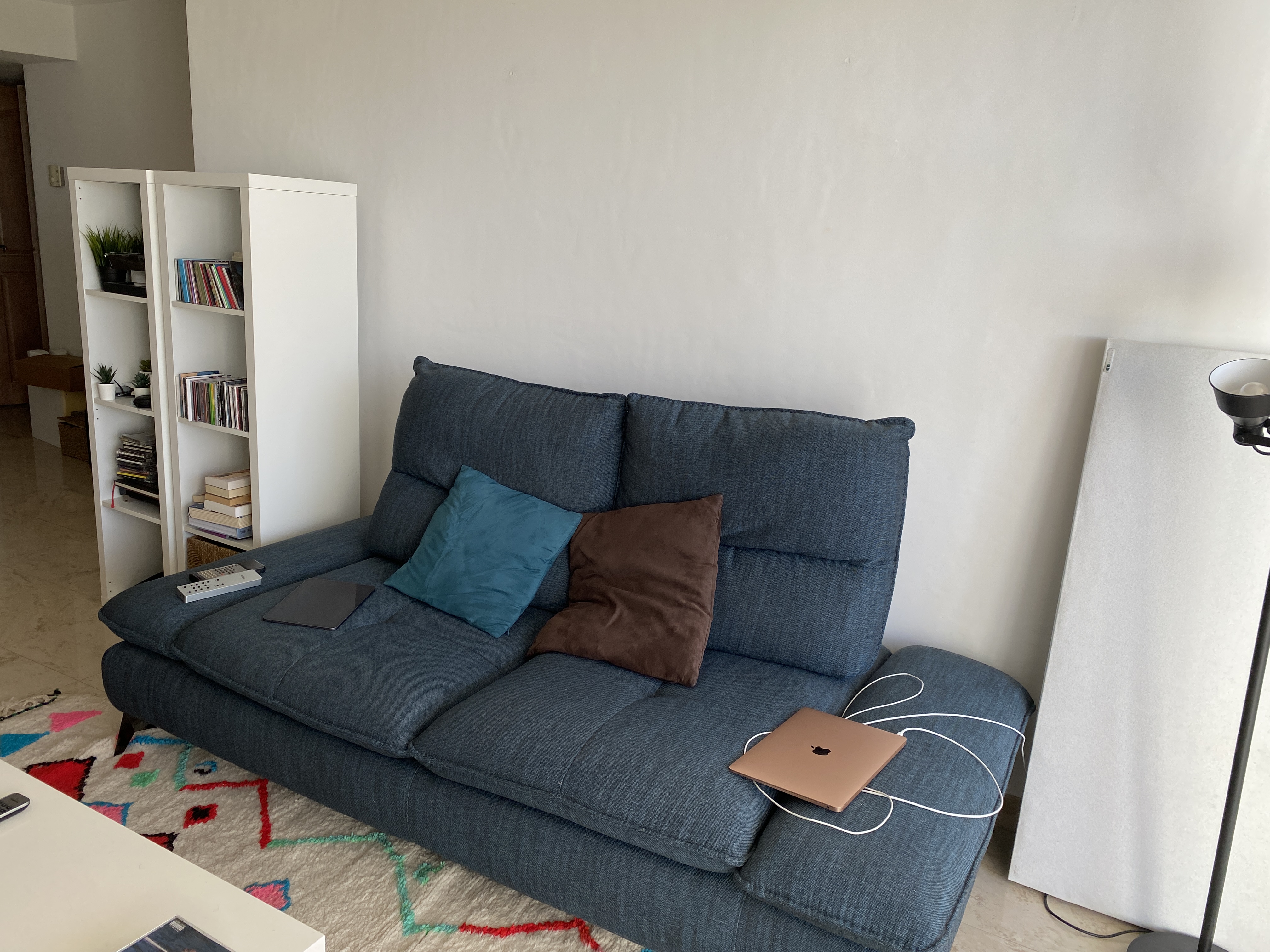

I placed a panel to the left of the couch since it seemed logical with the speaker being right across from it. But I can’t really say if it’s better or worse, because my ears aren’t in great shape at the moment, so I’m limiting my listening unfortunately.
One thing we haven’t talked about yet are the two bookshelf modules.
I know it’s good not to have a room that’s too empty, but is their placement really ideal here, with a right angle next to my listening position?
Would they be better placed somewhere else?
Back to the main topic, I feel a bit stuck. I really value all your advice and I want to thank you all for it. Please don’t think I don’t care, or that I’m only interested in changing gear :wink:
But if I feel blocked by aesthetics, I prefer to be honest about it.
I’m ready to make some aesthetic compromises, similar to what I did in my previous room, where integration turned out quite well.
But even temporarily blocking a window with an acoustic panel is just not possible for me.
I need a setup that feels pleasing while I’m listening, and that reminds me as little as possible of these issues.
I have no problem experimenting with GIK panels on the walls, even if it’s just for a few weeks until I find a new apartment.
Thanks !
Hi reptilia,
Thanks for the photos and continued engagement. I do recall a question a while back where you considered moving the sofa 50cm more away from the window?
My clear advice. YES. That way you have more chance of diminishing the first reflection point of the massive glass window.

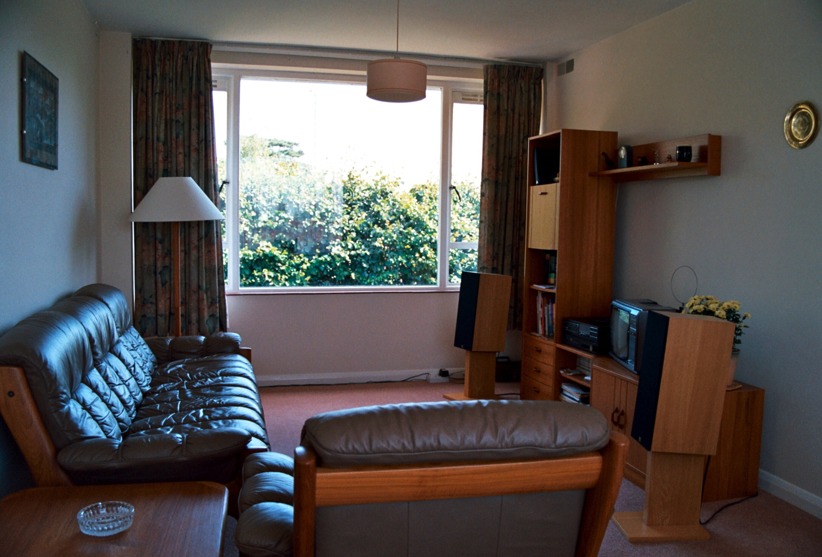

For your information I lived in a flat which I owned for many years which was an absolute problem to get right. I was using rear ported stand-mount loudspeakers, firing across the short dimension of a rectangular box with two massive single glazed windows at each end. Here is the picture.
However, this photo was taken in the daytime and it was the evening’s mostly when I listened to music. I had very thick and heavy curtains that completely covered the windows down to the floor - of course which blocked out the light! But more importantly, absolutely damped the negative acoustic impact of the windows.
FYI, I have prepared further information for you which includes a recommendation on how to spend maybe ~€600 (euros). However please do not get too excited, this €600 will not fix your current problem, nor buy you any kit, be that CD players, amplifiers, loudspeakers or even acoustic panels.
Simply consider it as an investment in your acoustic future.

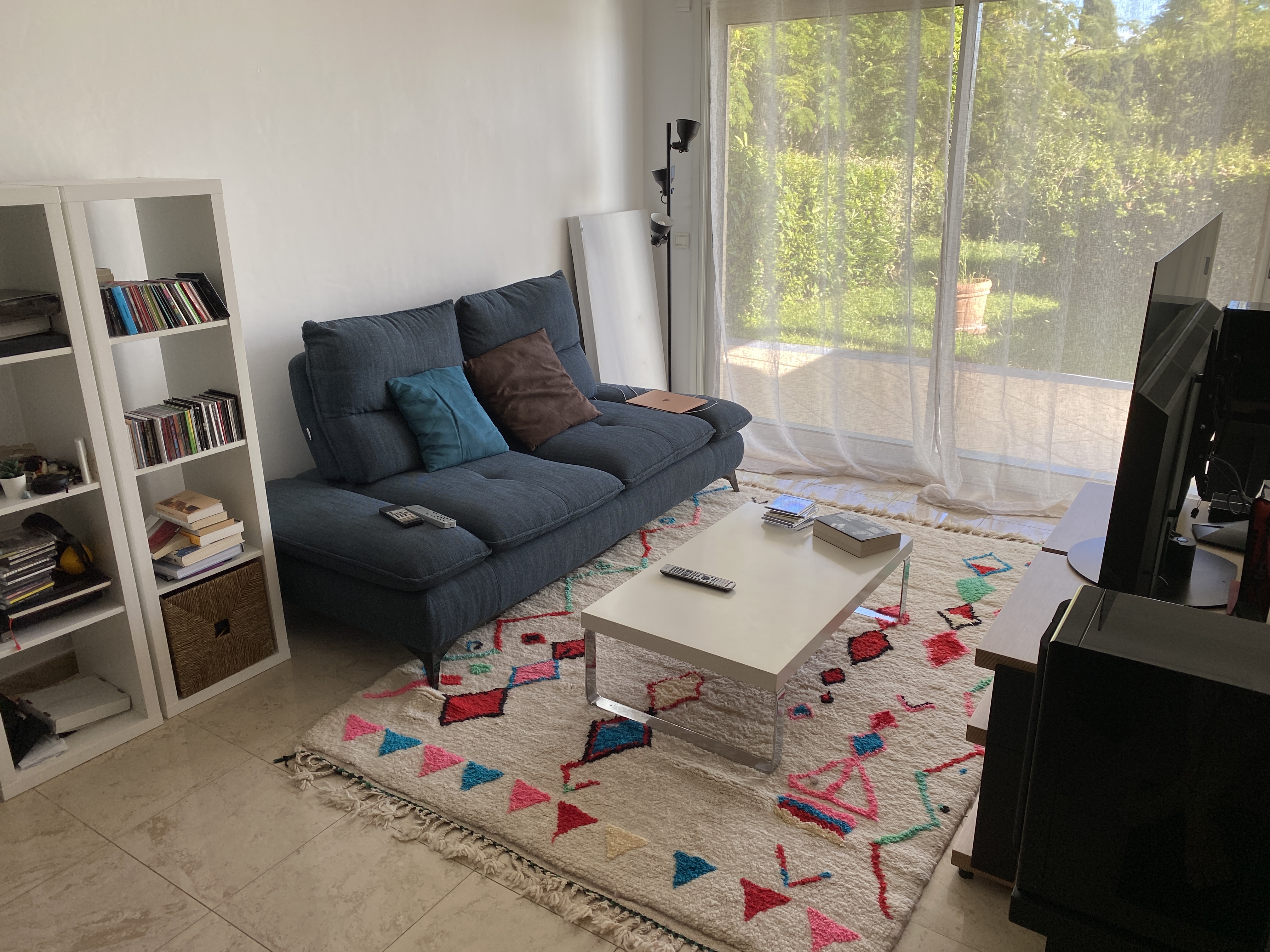

If you’re interested, I can post some photos of my friend’s setup (the one I mentioned at the beginning of this thread), just to give you an idea of the room.
Back then, there was also a rug under the coffee table.
