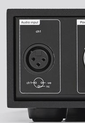

It has arrived and I have managed to get it set-up and connected to WiFi. I couldn’t get any sound to come out of the speakers though…I think I have the Burndys on my 300DR the wrong way round; but I am now on work calls for a few hours. Typical :roll_eyes:

with the no sound…do you have the correct cables? nap300 inputs are not balanced (even if they are on xlr) 350s are balanced config
I think so. I have a pair of Sarum T RCA to XLR cables, which the dealer checked for me and said worked. I’m not sure he did this with a 300DR though…I’ll try swapping the Burndy’s around after my calls and if that does not work I think I am likely to have the wrong cables :cry:
thats how it needs to be wired at the xlr end, might be worth a phone call to chord

If you have not touch any cables at all , and just installing linn, and you have the RCA to XLR , it shouldn’t give any problems. It’s a direct plugging . Have you switch to the right output? and check which RCA port you are using . And from your 252, just switch to where the RCA are been connected . Your linn should play .
Also , maybe you should check the linn apps .
