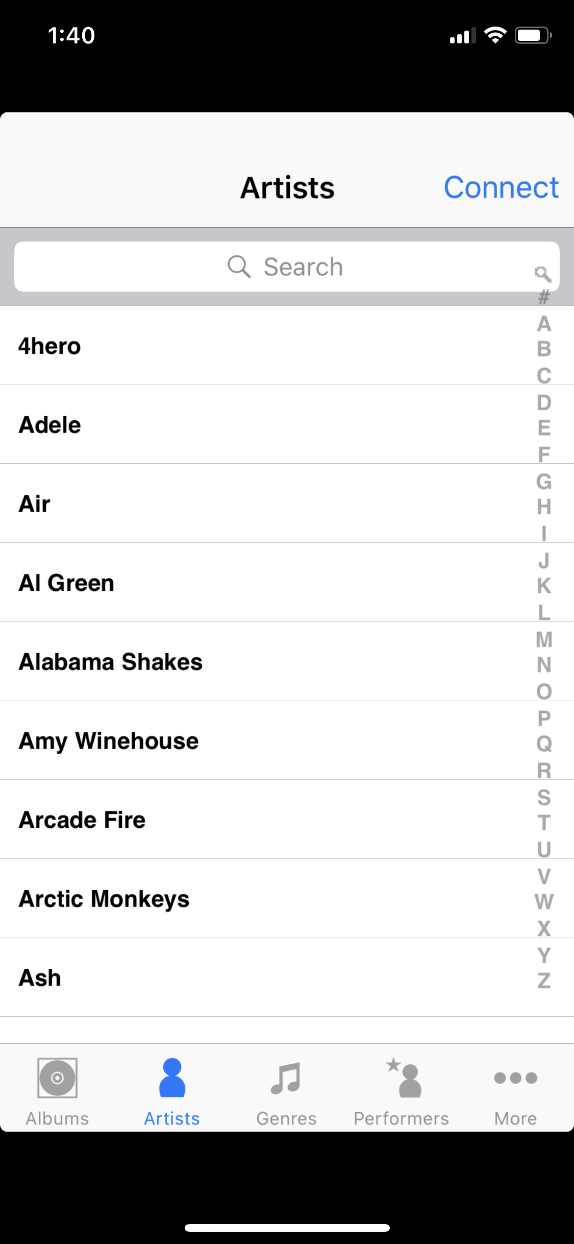

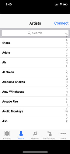

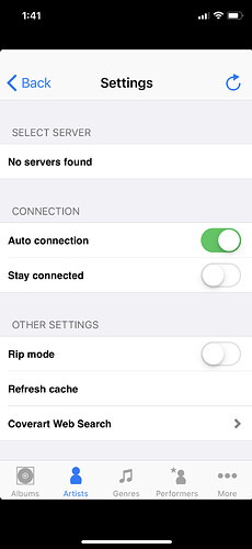

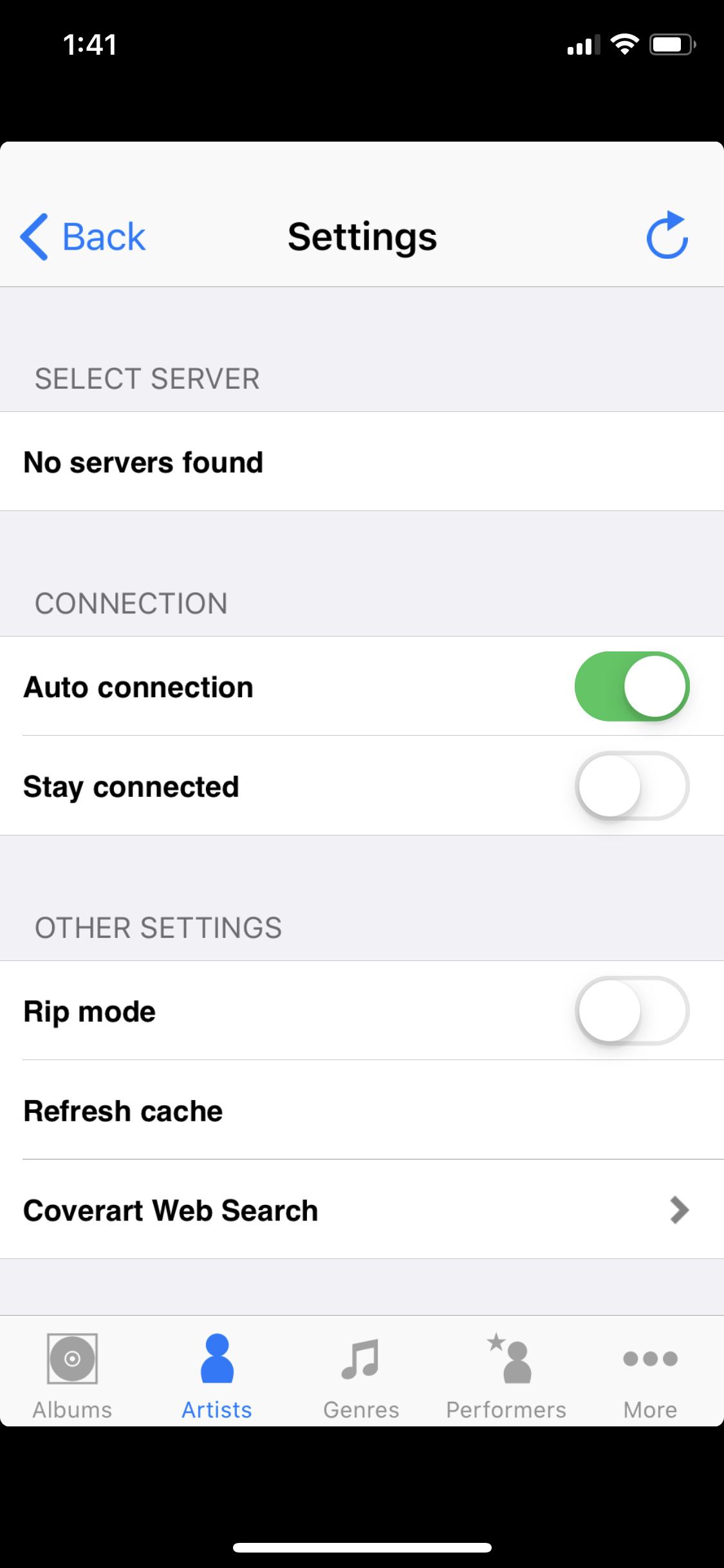

Hi
Thanks but that’s not working either. I’ve added a couple of screen shots from my phone. When I click connect when on the artists page, it doesn’t whether auto connect is selected or I type in the IP address
Hopefully these help?

What’s odd is it says no servers found. Maybe the HDX is offline. Can you check using the desktop client or via the web interface?
