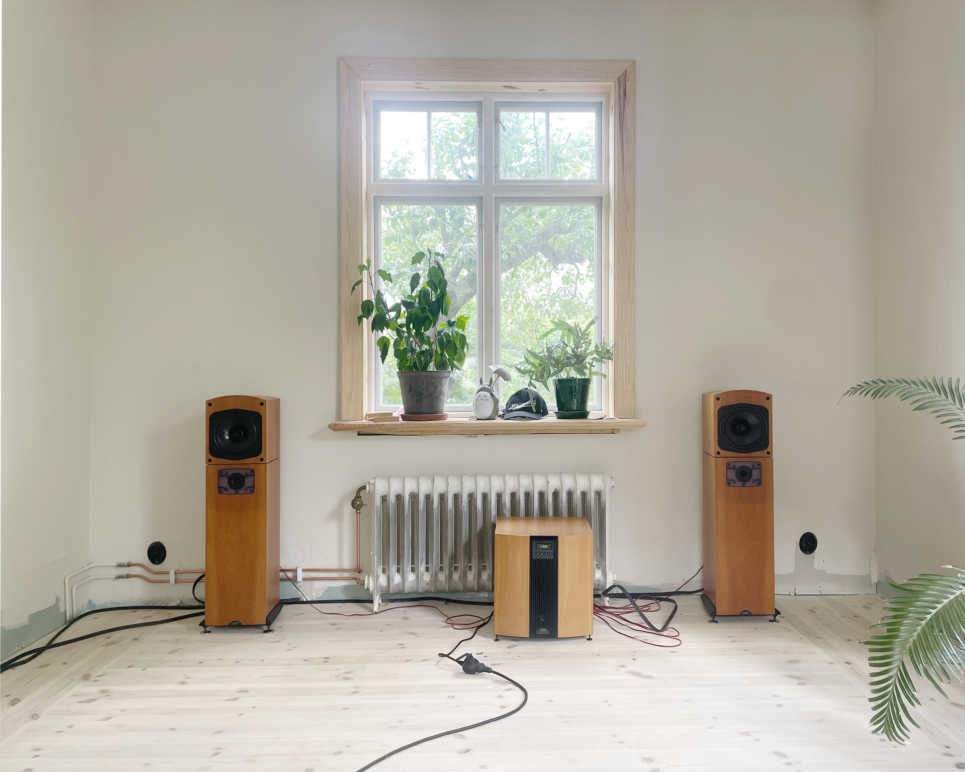

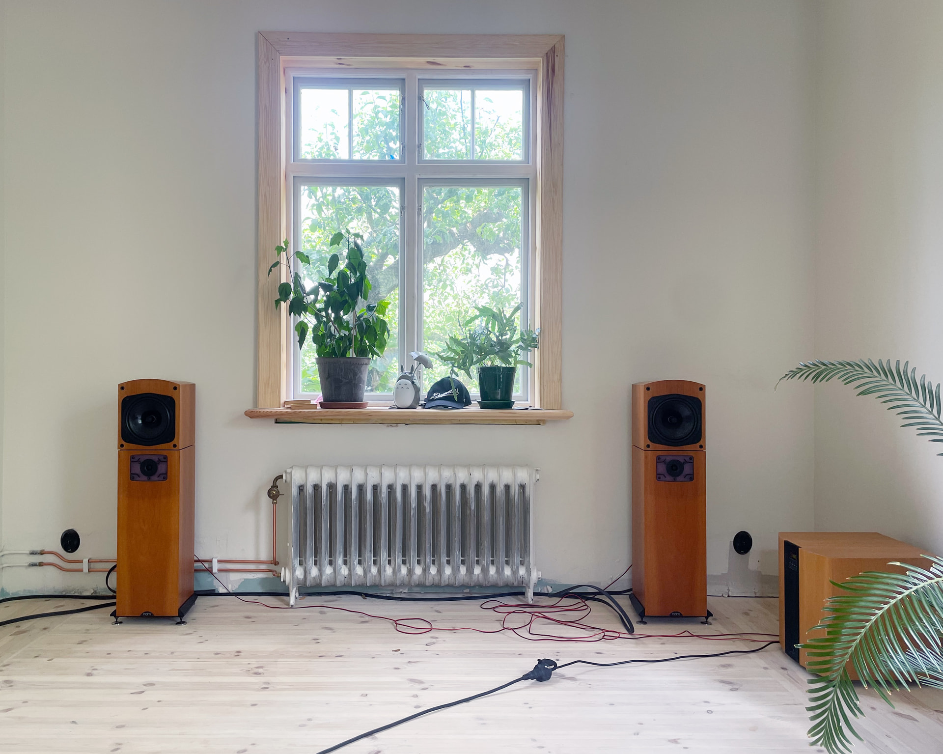

Temporary setup, trying some different positions for the n-sub. Getting used to the new speaker and the settings, not really sure what to listen for and a bit of a hassle to move the n-sub around so not really easy to get it right.
House renovation not finished, curtains carpets and bookshelfs on the sidewalls shall hopefully help some with reflections and perhaps damping…
