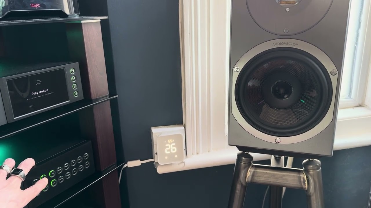

Hi everyone. Just a curious question. I have a 252 and whenever I mute or unmute it I get a fairly unhealthy sounding thump from my speakers. I’m fairly sure this isn’t normal, but I don’t think there’s any other issues with the amp, so wondering if anyone else has this or how much of a big deal it is? I only just noticed it recently since I picked up a pair of headphones and have started using the mute switch. Just for full info, it went back to Naim in 2019 and had a full service. Full setup is NDX2 and Rega P8/Rega Aria > 252/300DR with a Supercap DR and an XPS DR powering things. I did do a search and one result did pop up, but the video that guy uploaded has since been removed, so I have no idea if it was the same thing or not. Here is a video of my issue, since that will explain far better than me.

All sounding a bit concerning then! The volume of the thump is completely independent of the volume, it can be turned right down and it’d be the same as if it was at 9, 10 or 12 o’clock.
It both sounds and looks concerning. The speaker cone really moves when you mute. I would power down asap and send for repair. Sorry to say.

Sadly it does the same with all sources removed. I took them out one at a time and no luck. I did discover it’s only thumping in the left channel though. I’d never actually paid attention to that before, as the left speaker is so close I just noticed that one, but yeah, the right channel is perfect.
