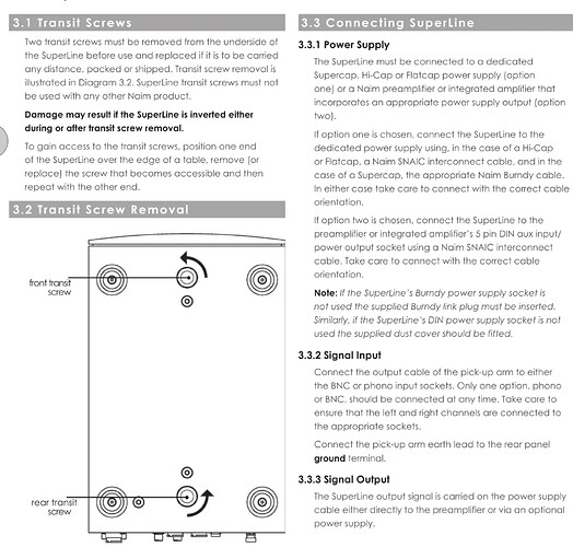

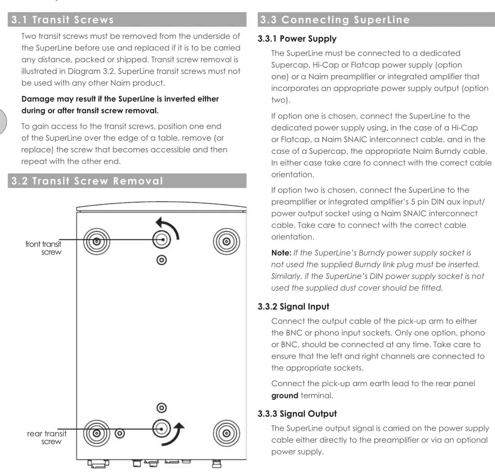

The SL manual is at best correct, but still unclear. Look at p4, and it does show how to connect the 252’s SuperCap to the SuperLine. Or does it? It only shows the use of a Burndy from the SC and assumes a dedicated supply to the SL. What it fails to mention is that a SNAIC can also be used with the SL and Aux2 of your 252. For this, the image above on p4 shows a 240-degree 5-to-5-pin DIN between the SL and HighCap. This is as close as it gets in the SL manual.

The Superline manual covers it, including a few examples further on in the manual.
