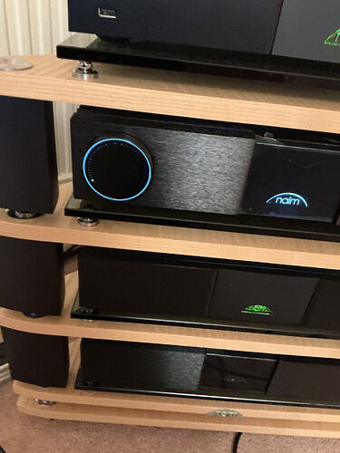

NAC 332 headphone output channels flipped the wrong way around
Through my main speakers both the left & right channels are correct. However through my headphones both channels are flipped over the wrong way around. Can anyone shed any light on this? Has my internal headphone stage inside my NAC332 been wired wrong at the factory?

@Stephen_Tate Anything is possible. Are you sure you connected your speakers correctly? Are your headphones wired correctly?
Have you got the inputs swapped left to right and the speakers swapped left to right so making the speakers correct and the headphones wrong?
Hi Jaybar,
My speakers and cables are absolutely connected 100% correct.
When i listen through my headphones left is right and right is left. This will have nothing to do with how the speakers are wired, although as i understand it, Naim changed the orientation with the NC stuff.
I re soldered with my new connectors supplied with my NC250 to coincide with this change.:thinking:
No. This has nothing to do with how the speakers are wired. You can disconnect the power amp from the preamp entirely and you will still be left with this same oddity.
ah, i meant the source input to the 332. But of course the 332 output to power amp input would cause another swap.
or try putting the headphones on the other way round?
Just to clarify here: same headphones used on 5Si, XS2 and SN3 throughout the years, and so i know it’s not those. My finger is firmly pointing at the 332.
I would let your dealer know. IIRC there was a similar issue some years back posted on here, with a piece of Naim kit where the hp channels had accidentally been reversed, so it’s definitely a possibility that’s the issue.
