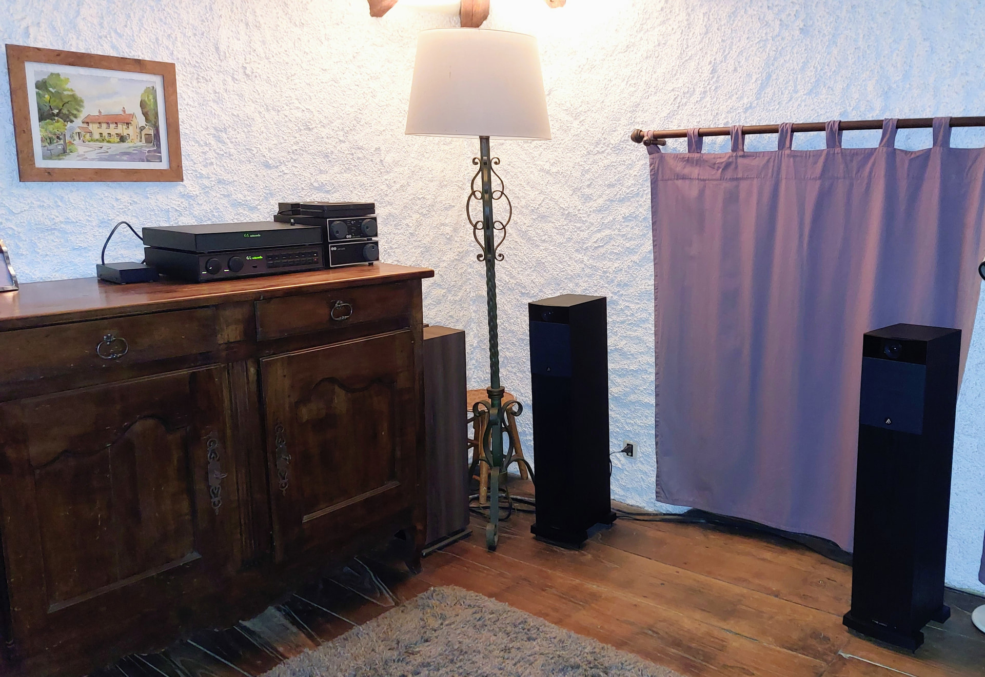

Well that is a pleasant surprise. I didn’t expect much from this. Bedroom with CB 62/140 playing in to Fyne baby floor standers F302. Source Node2i/Qutest.
I replaced the 62 and left the 82 running with the 140 overnight at low volume. Today listened for about an hour and then swapped in the flatcap. Immediate and obvious improvement, mostly in the bass control, but also separation. Impressed with this simple change.
That’s excellent. Wait until you find a second hand HCdr :laughing:
Always the plan but they are thin on the ground at the moment.
Stacking it all on a sideboard is def not helping though.
Lol, temp to try it out.
