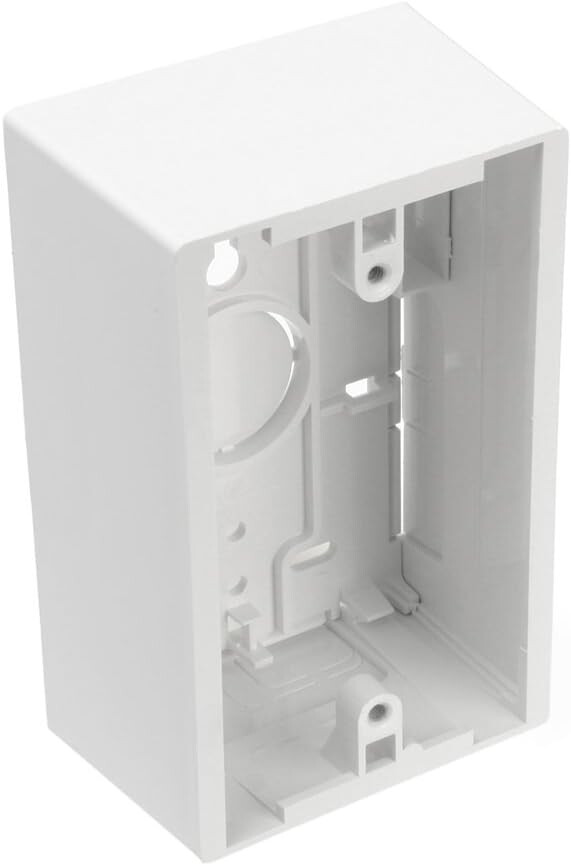

You could terminate them inside a ‘wall box’ and cover the box with a plate that just has a round hole in it. The A5 emerges from the hole.
A challenge will be the stiffness of A5; it doesnt want to bend around sharp corners but you should be able to get it into and out of a box like this.

You can get ‘brushes’ for pattress boxes.
Search up Matt Black 2G Single Brush Cable Entry & Black Surface Pattress Back Box on eBay for example

Couple of pics to illustrate instal here, now done a long time ago. Brush plates available in single and double gang and can be fitted to a metal back box (wall inset) or a surface plastic box.
