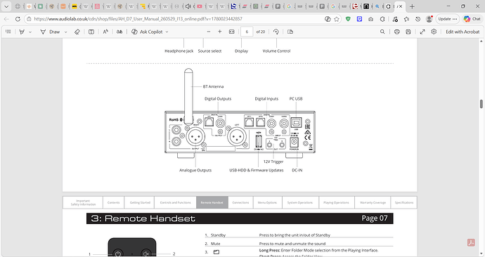

I can’t see any analogue input, so can’t be used like a normal headphone amp.
From a glance at the AudioLab website - this component, the D7, is listed as a Digital to Analog Converter (DAC)
It appears it has its own power supply and can be used as a source input into a stereo system or as a stand-alone source with headphone amplifier.
There are multiple digital inputs. It does have Bluetooth receiver. Unfortunately it does not seem to have capability to connect to internet based streaming services directly.
To make this work you’ll still need a digital “transport” upstream to feed signal into the DAC - e.g. CD player, computer, or streamer.
You already have a high end Naim CD player.
Unless you’re using the AudioLab to get a digital audio source into your 282 preamplifier, it doesn’t serve much of a function in your main system.

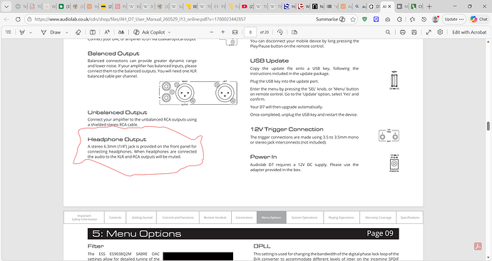

D7 analogue output > 282. Assume this will somewhat alter the sound of CD5 in the Naim/speaker system.
I assume if headphones are plugged in the D7 would mute the analogue output? Check with AudioLab if manual doesn’t make this obvious.
Good luck
I think that is the case.
