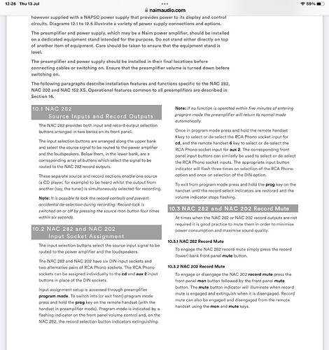

Hi, while there is a thread on the nac 282, I would like to ask a question. I know the answer maybe in the manual but I can’t understand it. I wanted to change the cables between the supercap and 282 for chord shawline interconnects. Are they 4 pin din to 4 pin din or are they 5 pin din to 5 pin din. It would be a pain to pull out the equipment. Many thanks :+1:
Yes - aka Naim SNAIC’s.
