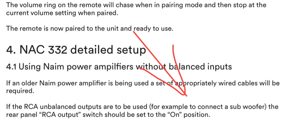

Don’t Naim support bother to read their own manuals these days?
I’m fairly sure that you can use the XLR and RCA Phono outputs together as it has been discussed before re. passive bi-amping.
@ChrisSU if I could I’d send you the coldest pint! Brilliant! Haha
You’re right, I confused it with some class D issue or something.

As I already have an RCA cable and seems like 332 supports it, I’ll go with this option first.
