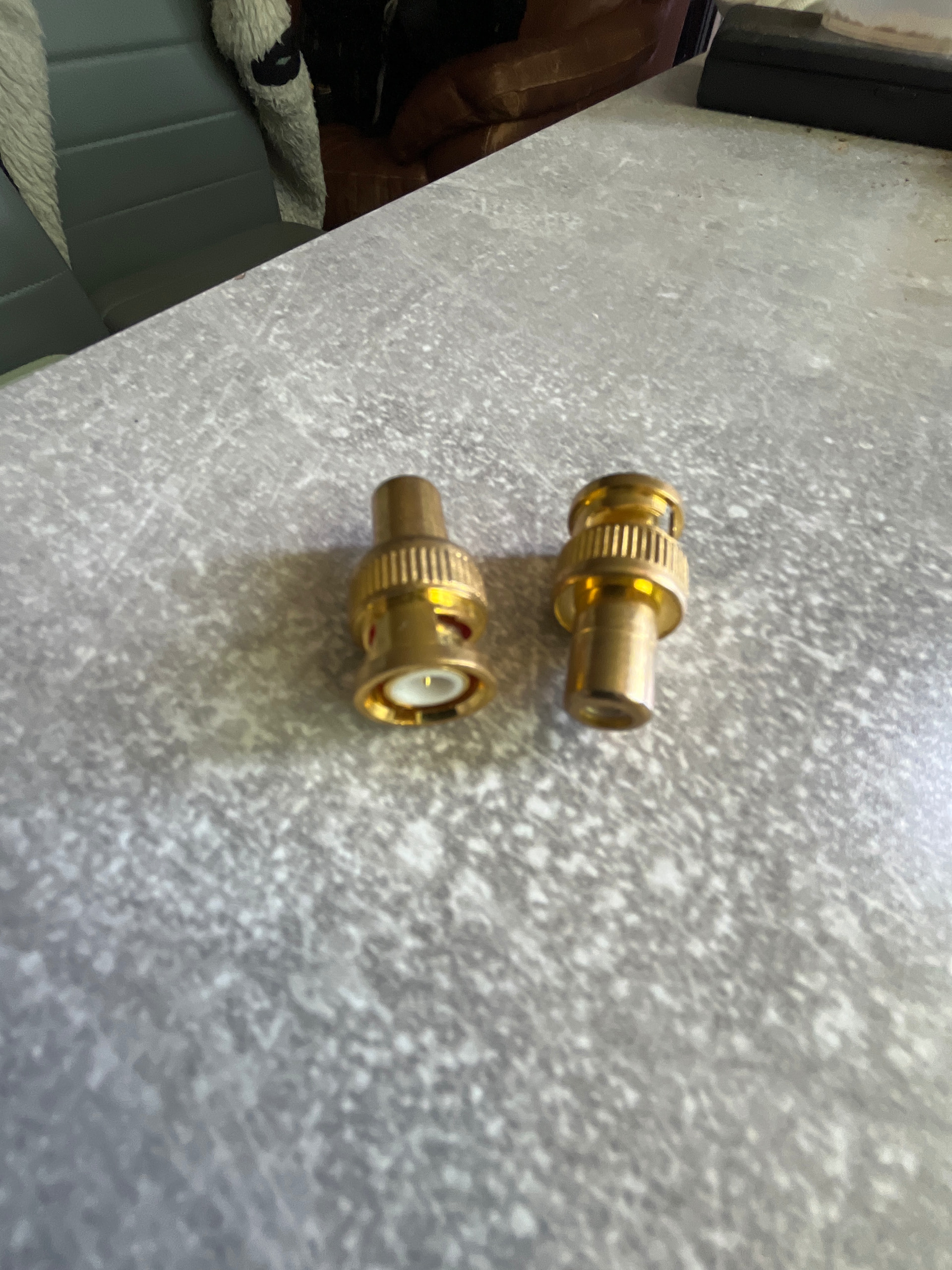

Alternatively you could buy BNC to RCA adapters
I am trying to avoid adaptors as they degrade the sound. OK for a temporary fix though.
Adaptors are best avoided except as a temp measure. If you are unable to fit the correct 50 ohm BNC connectors to your interconnect then you may be best replacing the BNC sockets with good quality RCA Phonos, such as from WBT (keep the BNCs in the box just in case you ever sell on or wish to revert to standard). Your Naim dealer may be able to do this for you.

I would use BNC to phono adapters. That they have an effect upon sound quality in not a given. You can of course find quotes from engineers/sources in both camps.
BNC adapters are very bad for sound quality,when I have tried.
