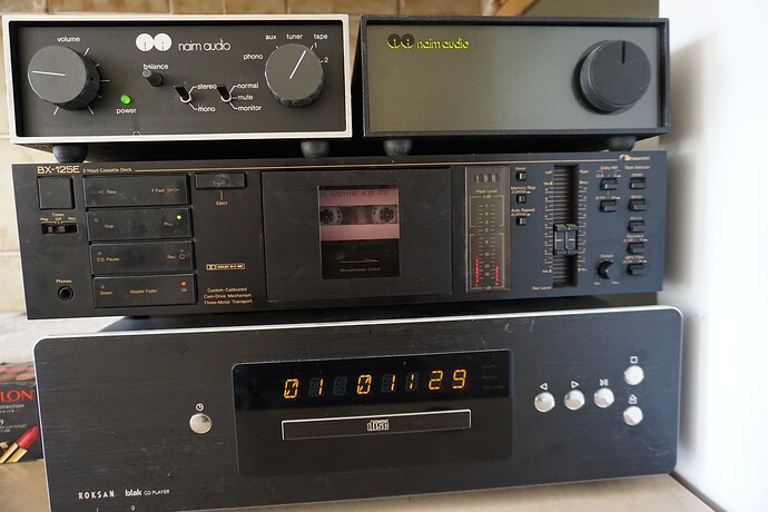

Hooray! My Nakamichi BX-125E has been restored to full working order! It must be 30+ years old, purchased to replace an Aiwa/Akai (can’t recall) 3 headed deck which was burgled. So now I’ve got two functioning Nakamichis (BX 125-E, DR-3) Here are a couple of pictures of where they’re slotted in. I now find myself yearning for a reel-to-reel, but I know it’s just nostalgia. Love and hugs to all, Stevie xx
Nice decks. Should serve you well for many years!
Nice decks.
Can you get some separation between them, rather than stacking on each other?
Naim equipment does prefer its own dedicated shelf.
DG…
Hi DG, it’s not really possible, but thank you for your excellent advice. I don’t think I’m a conventional hi-fi user, and so I quite often sacrifice optimum audio performance for convenience, or just to fit in round my other enthusiasms. My main (active) amplifier isn’t stacked though (NAC 82, HiCap, Snaxo, FlatCap, NAP 250 x 2 into Linn Keildihs), love Stevie xx
