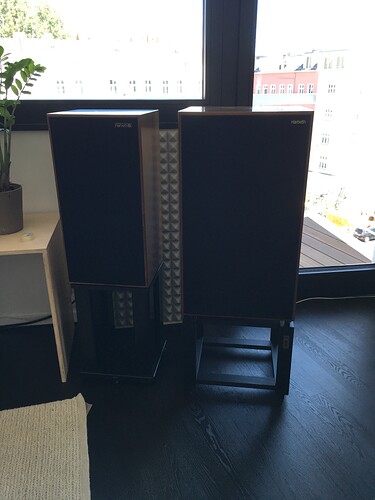

Had a weekend trial with a friend having 40.1. I’m using SHL5 Plus myself. Wattage improvement was not as obvious with SHL5 as with 40.1 which is understandable even though it could be heard there too. I would describe it mostly as the high wattage amp sounded calm, detailed and relaxed no matter volume was played.

I’m sure most amps can “handle” them but the breakpoint is when you put size of room and dB at your listening position into the equation and also of course how good are your ears and are they as mine.I do love Naim sound and would like to get close to that relaxed sound I experienced from the H390 in Naim lineup but not sure how far I need to go since Naim is pretty expensive and I’d like to find the sweet spot for my requirements. I wish one could borrow music equipment from retail stores. I would even pay for it but around me no one offers such.
I went from SHL5+ 40th Anniversary to 40.2 recently. I have the 300DR as power amp and in my room and to my ears there is more than enough power in the 300DR to blow up both my ears and my apartment, or so it seems. I don’t like to listen to music at very loud levels (around 62-ish dB according to an app I downloaded for free). I do agree with a comment made above that the 40.1/2 probably should have 252/300-level amplification and a great source to properly shine.
However, I brought my SHL5+ speakers over to a guy who wanted to test them before buying them and he had 1) a much larger apartment than I have and 2) a very large subwoofer and 3) a large powerful NAD amp. The room was somewhat acoustically treated and he used a Rega RP6 as source. It sounded very good, although very different from what I was used to. He liked to listen to music at loud levels. Perhaps SHL5+ and a subwoofer could be an alternative to the 40.1?
