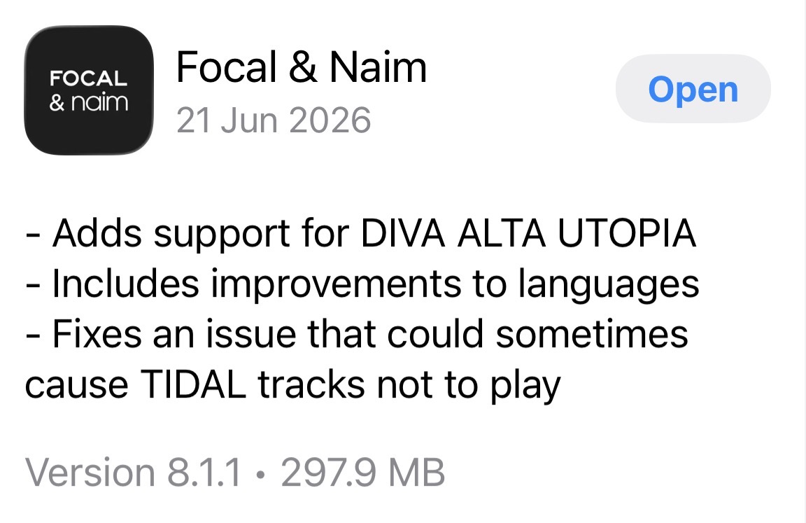

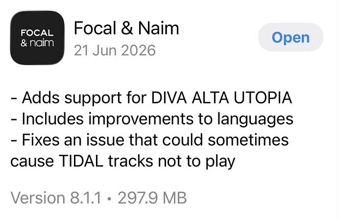

I’ve had no issue with my NSC222. Are you running the latest version of the app which was released on the 21st June 2026.
Yes, v8.1.1 of the Naim app is running.
