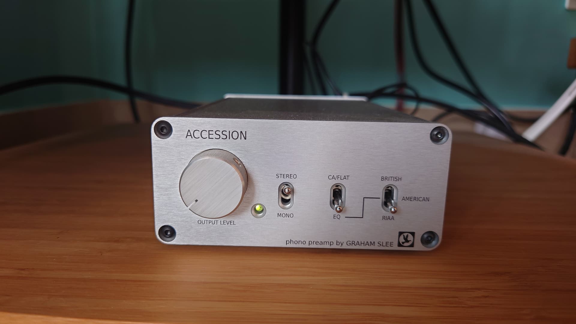

The Graham Slee Accession does mono, and supports various EQ/RIAA curves. It might serve both purposes.
I’m very pleased with mine, it sounds great, and there are good reviews online about them, including from Michael Fremer, so I think that’s reasonably good feedback on the SQ. Obviously listen for yourself if you can, Graham Slee offer a try before you buy service.
They do only come in MM or MC though.
The only negative feedback I could find, from a Google search, is retarding build quality. The Accession is a £1000 phono stage, with a £350 power supply. It doesn’t look like a £1000 stage, my old Stageline was much better built, but the Accession sounds much better than the Stageline.
