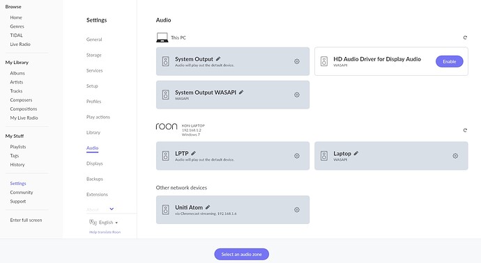

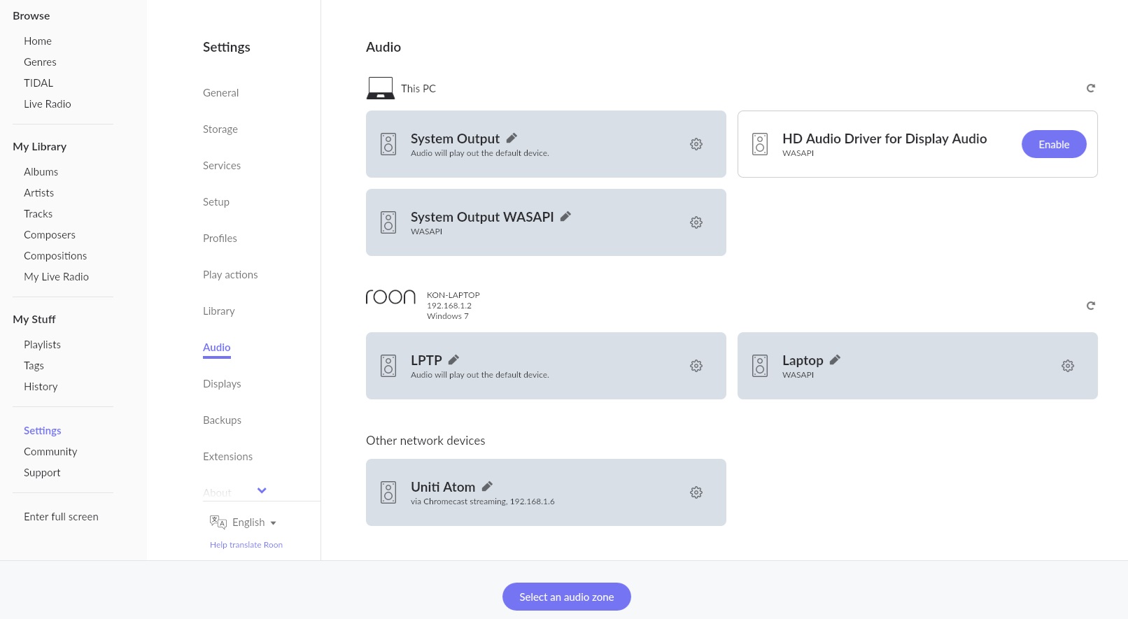

After that, the Atom no longer appears as a Roon endpoint in my Roon Core.
It appears as a Chromecast enabled device, though. Go figure.
Right until the firmware update, Roon and Atom worked faultlessly with RAAT.
Now I can only use Chromecast to stream from Roon to Atom. Any ideas?

No, there’s nothing else further down the page.
Roon only recognizes as endpoint my laptop (with 2 different streaming modes), which I’m using as a remote.
No Atom anymore.

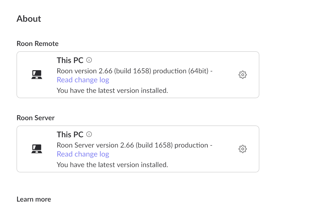

I suspect what the issue is that you’re running old Roon server code. Try and update.
Earlier this year this was a critical security patch on Roon RAAT of which we applied and also did the recommended steps of adding a signed certificate into the product. That means the device will only accept signed code from Roon. if the server is old and doesn’t support signed code then the device won’t show.

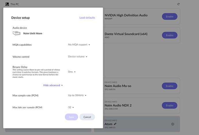

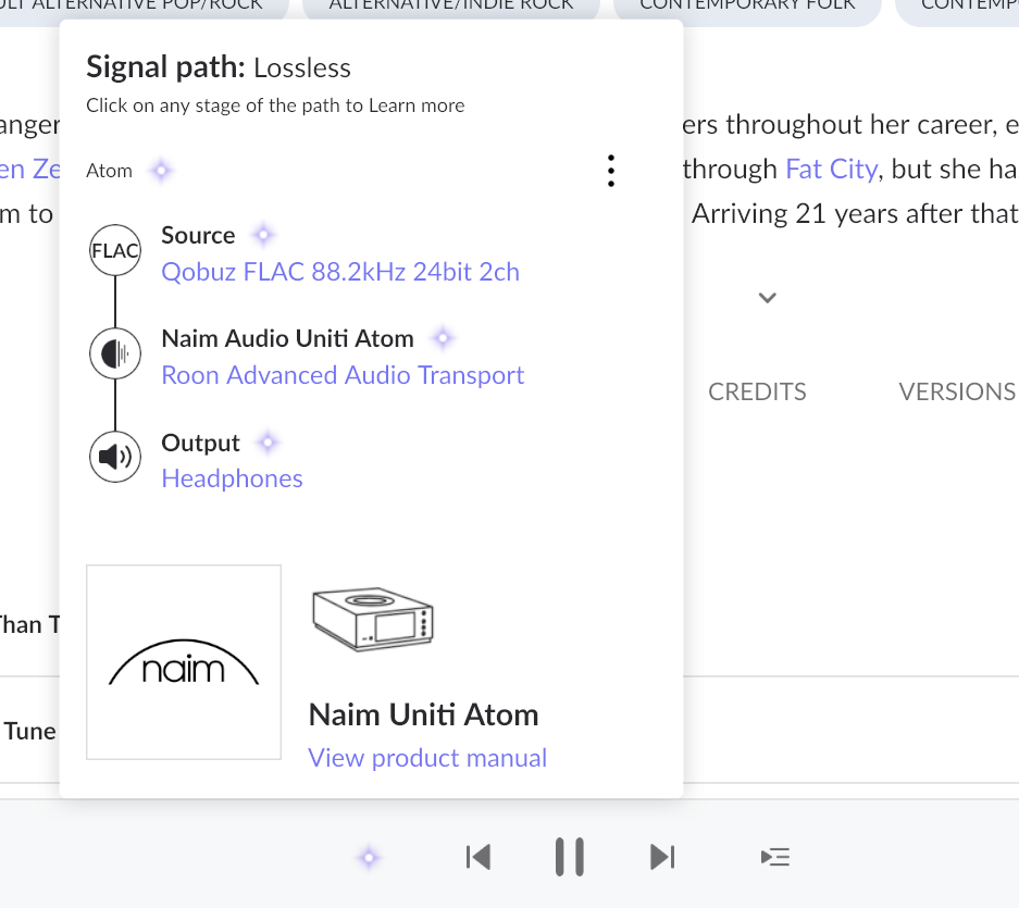

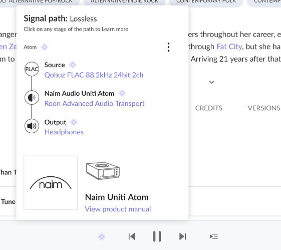

Just to prove in principle it can work here’s mine:
Hope that helps

Hi @kokixx
it sounds like that is the reason. This Roon update was a security critical one and hence why we have done it and rolled it out fairly quickly. This affects all manufacturers, not just Naim and needed an update to Roon RAAT 1.1.47 + apply for a certificate from Roon labs. The certificates breaks compatibility though as the Roon RAAT client will only accept trusted LUA code signed by Roon.
If you want to check then download latest Roon server on your mac/pc and check if the atom is then detected.

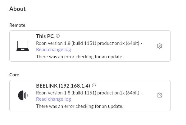

To recap, I’m using Roon 1.8 installed in a Win11 miniPC as a core, and I’m using Roon 1.8 installed in my trusty old Win7 Acer laptop as a remote. Because that’s how I’m listening to music, sat on my favorite position with my laptop on me, and while working also changing music on the fly. To give an idea of how much I don’t want to change things that just work, I also have a far newer Acer Win10 laptop which I found frustrating to setup and use and it sits unused in a drawer.
In the pic below my current Roon setup is shown.
Now, from the suggestions I got from you, I understand I should update to core Roon 2.0 to enable the Naim Atom to become Roon ready again. Will I be able to use Roon 1.8 as a remote for this? Because I think Roon 2.0 is not compatible with Win7 to install it on my old laptop.
Or, is it any way to roll back to older Roon builds for my core and remote and older firmware for my Naim Atom to make them communicate again and just leave them like this forever?

No, you cannot use a Roon Remite 1.8 to control a a Roon Core 2.0.
No, you cannot roll back on the Naim app.
You need to update to Roon 2.65.
