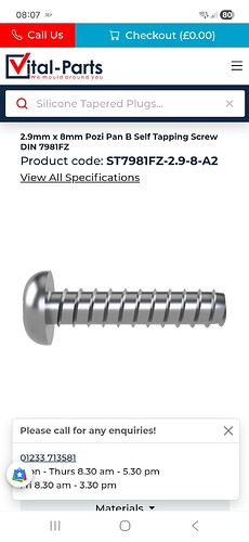

How about this
They look like good metric equivalents.
I think that generated image may be cropped, so they may have points though.

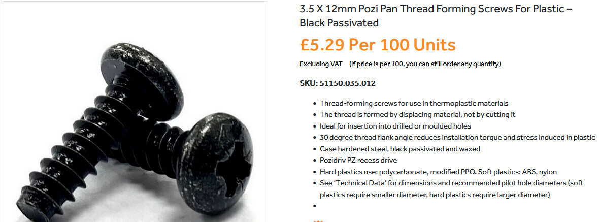

Would this be the correct size for the earth screw
2-5-x-12mm-pozi-pan-thread-forming-screws-for-plastic-black-pasivated-zinc-plated
These ones would be better:
2.5mm would be too small.
Regards
Neil.
