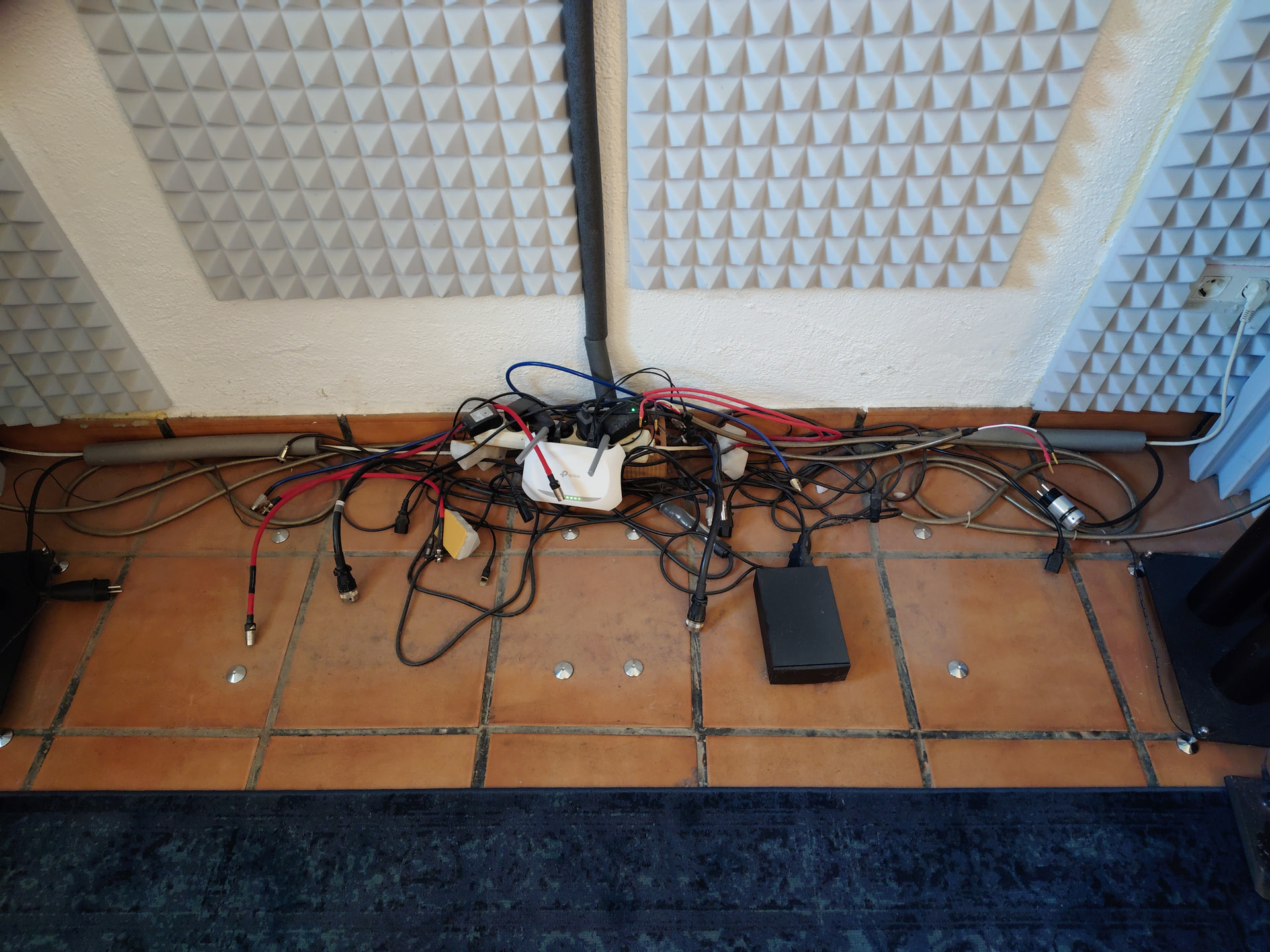

I had a headphone amp connected to the preamp and plugged into a plugboard. The boxes are connected to two different wall outputs with Hydras.
So I just plugged the headphones amp into the streamer with the RCA Phonos and the sync light on the nDAC came on.
Must be an invisible magic circuit.
:flushed_face::face_with_monocle:
I suspect there’s some odd earthing issue going on here.
Seems to have settled. Taking the RCA phono feed from the nDAC by flipping the miniscule switch between that and the DIN setting.
Sort of what I do. RCA out from nDac to HPA and din output from nDac to Nait50.
