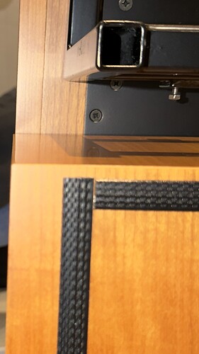

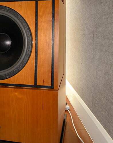

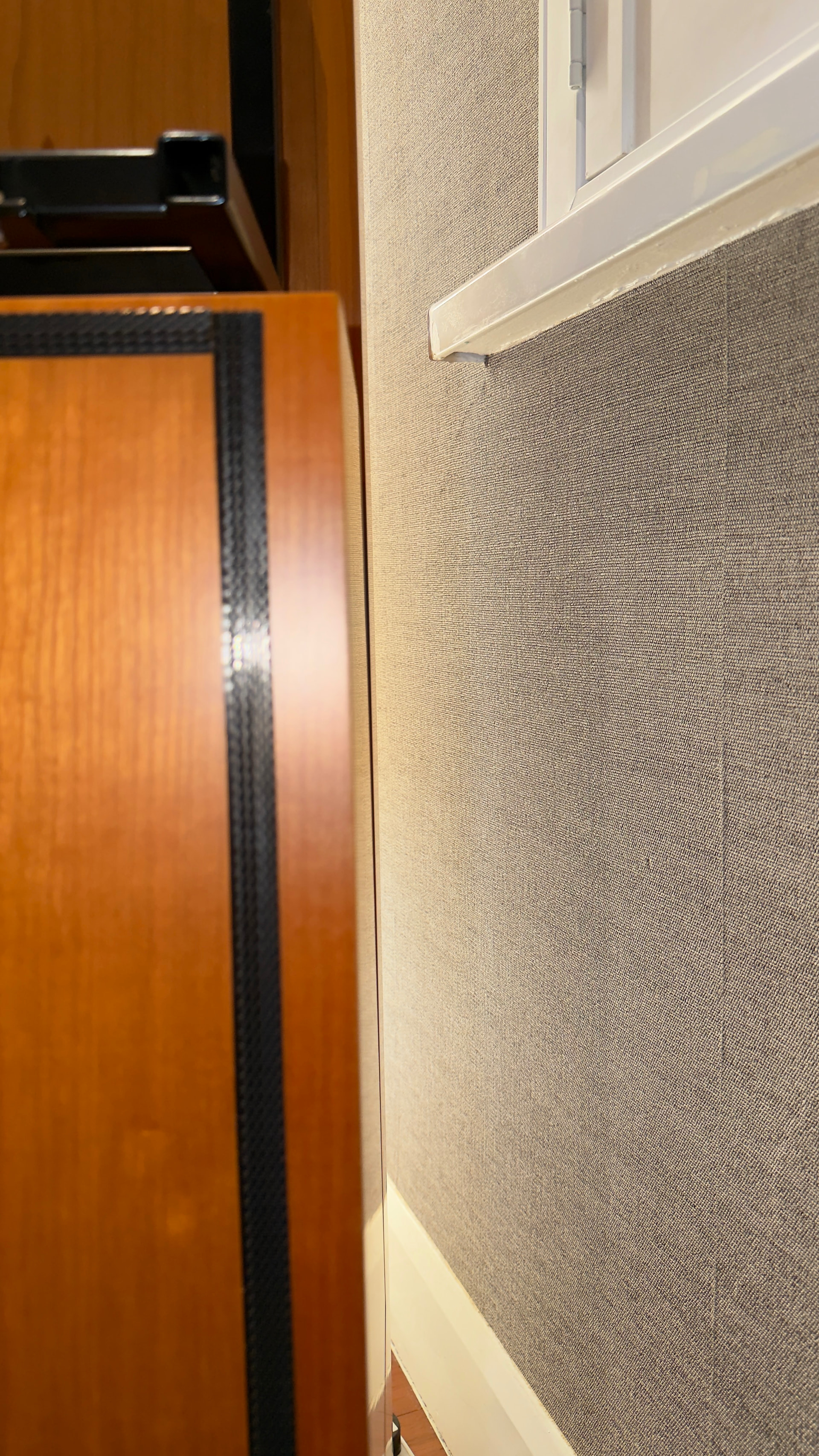

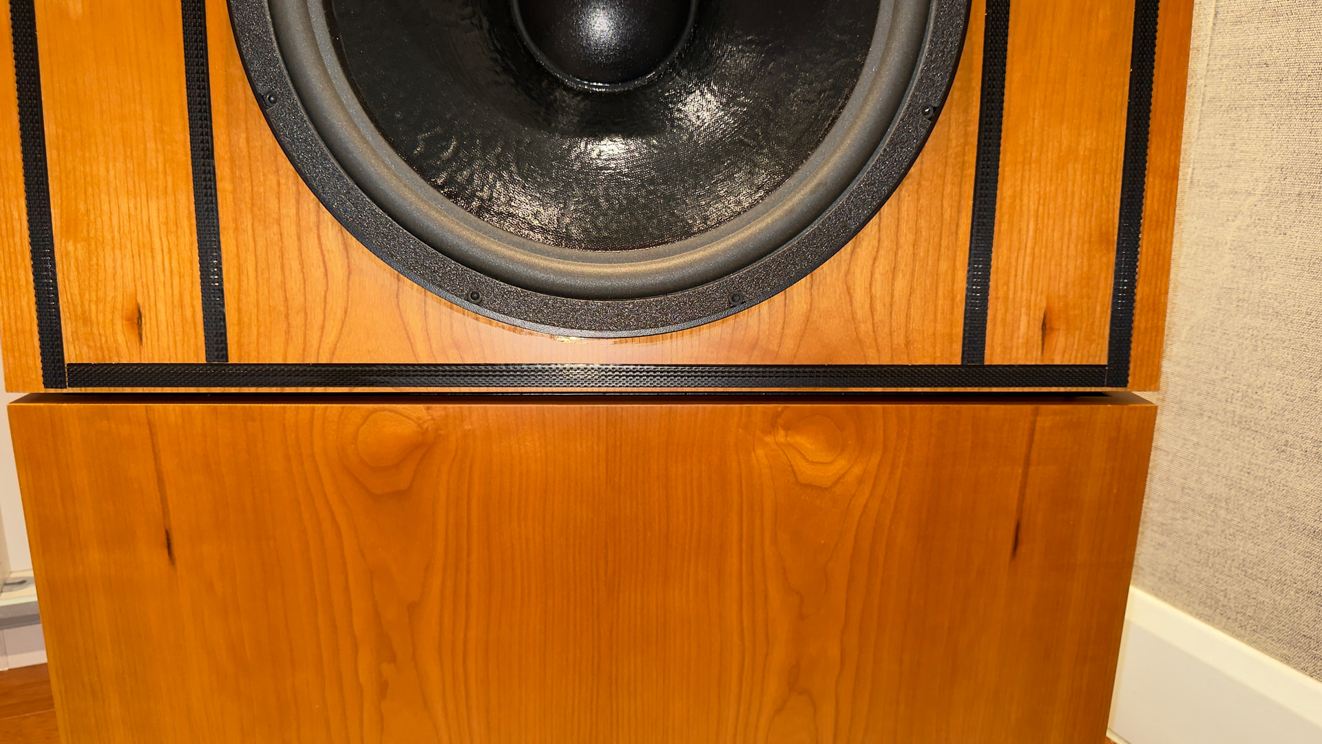

I have a problem with my DBL speakers setup. The bass driver cabinets are not sitting properly. I’m following the setup guide precisely but the panel which houses the spikes (facing upwards) isn’t perfectly level inside the L frame cabinet therefore when I place the bass driver cabinets on the L frame, the right speaker is sitting uneven and protruding from one side. On the left speaker, it is sitting level but rocks when you apply pressure at two ends.
I don’t think the panel that sits on the L frame cabinet is adjustable so I have no idea how to fix this problem. I’ve attached photos of the right speaker that isn’t sitting straight.
before anybody suggests, I’ve checked and I can confirm that the spikes are sitting in the hole. Can anybody offer any advice please

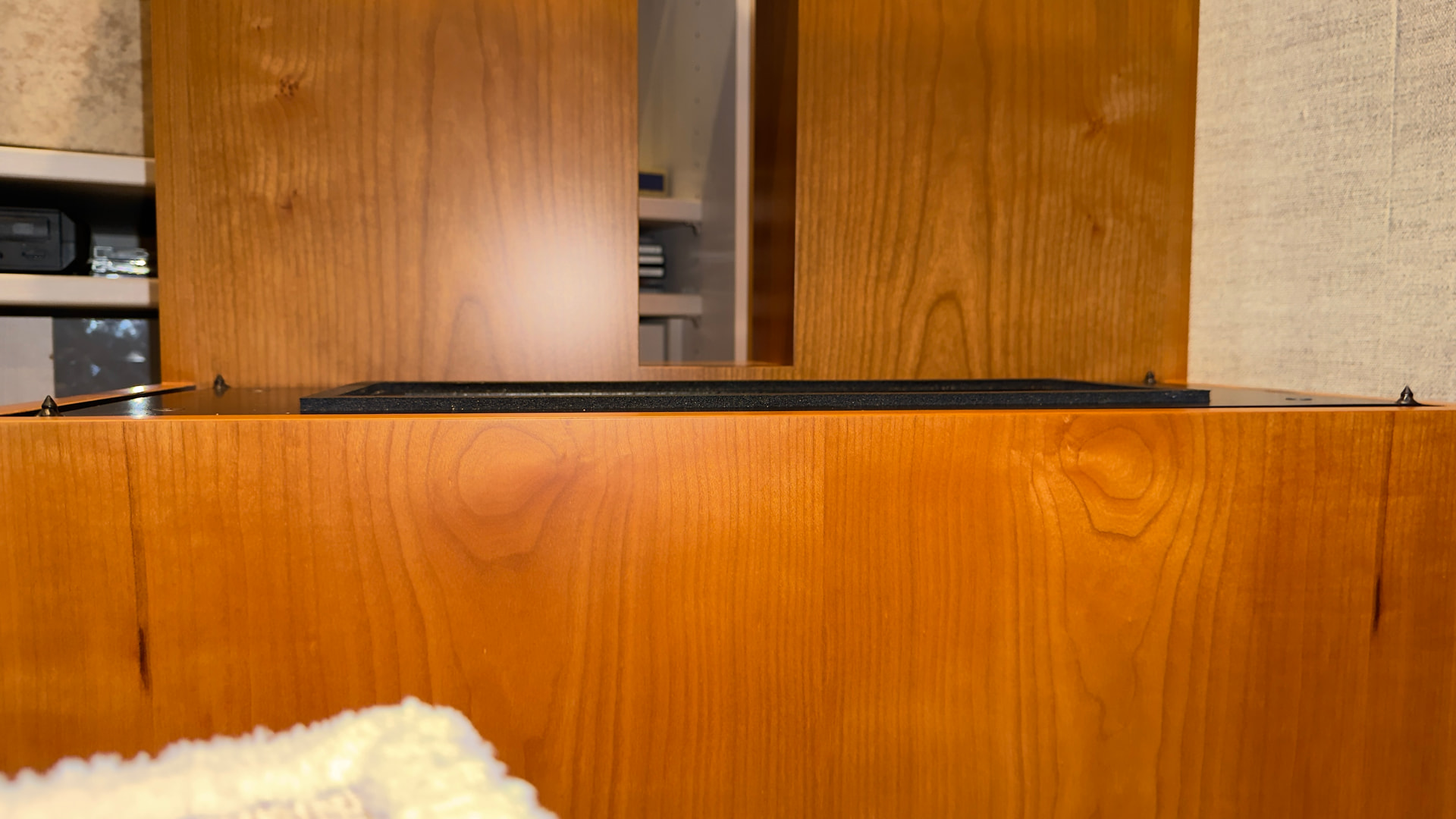

I’ll remove the bass driver cabinet and take a photo. To put it simply the spiked metal plate isn’t level. When you look at the cabinet eye level it’s lower from the left and higher on the right. Other than 2 allen bolts which attach the plate to the cabinet there is no other adjustment bolt. Even when the cabinet is level the plate isn’t.

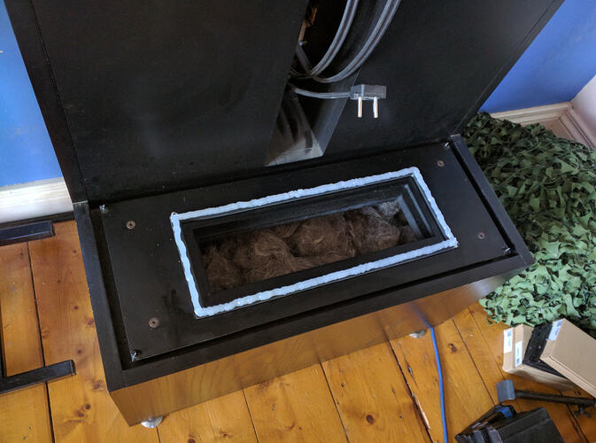

Had a trawl through my Google photos. Found this.
Clearly there’s no adjustment of the spikes relative to the plate, they’re welded.
The plate itself appears to be flat on surface of the cabinet. I can’t see any scope for adjustment/leveling. Can’t recall if there’s any supporting structure within the cabinet or if it’s simply the cabinet itself supporting the weight of the bass box.

So on my right speaker the plate is sitting a a millimetre lower on the left and sitting about 2 millimetres above the the rim of the cabinet on the right. As you have said I don’t see any adjustability unlike the mid tweeter cabinet for which the spikes can be adjusted.
The left speaker is sitting level but it rocks when you apply pressure at two ends.

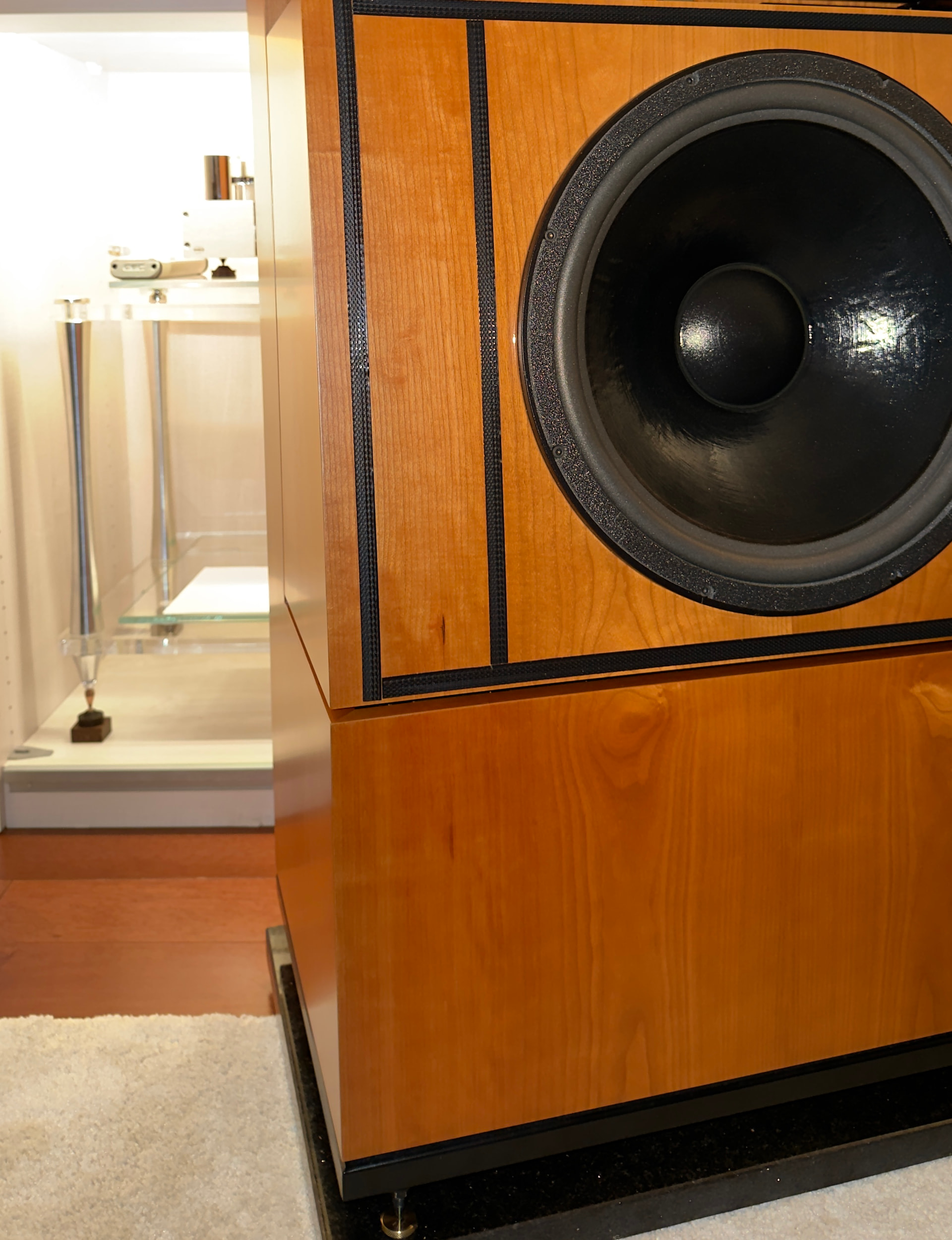

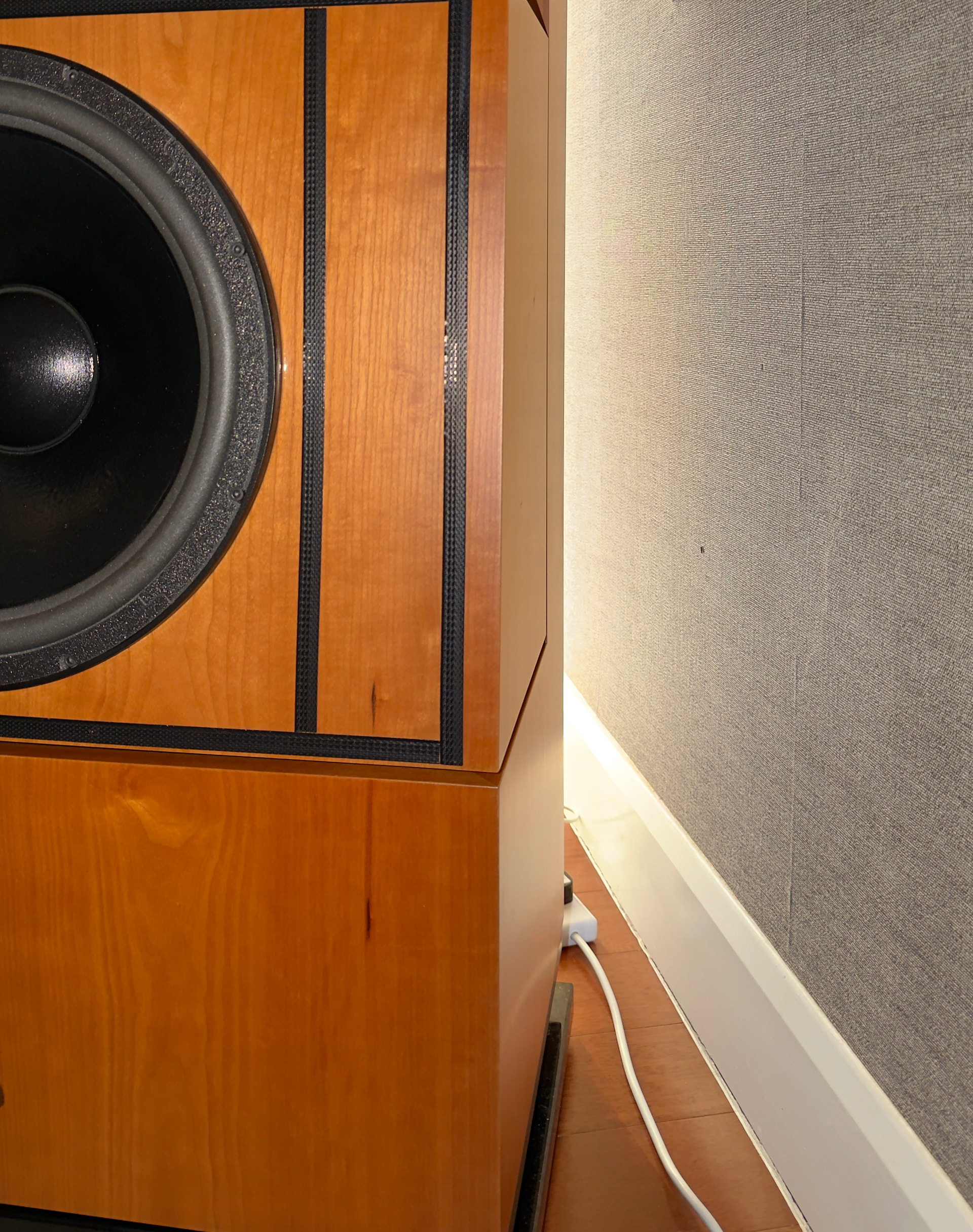

Thanks for your help guys. I’ve managed to get the bass driver cabinet to sit right. I used the 1mm aluminium plates that @garyi suggested. Thank you :folded_hands:
i installed extra 1mm aluminium pieces on the right speaker (left hand side front and back)
i stuck them to the existing plates to make up the height difference using power grip tape
as 1mm plates were too thick to compensate for the front back rocking on left speaker, I used 1mm thick silicone cut off to balance it.
both cabinets are now sitting perfectly with no movement whatsoever. Very rigid.
