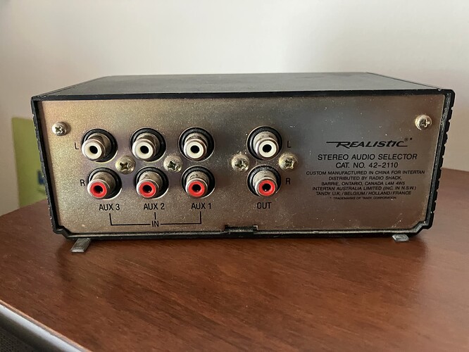

I now need to think about the best way to multiplex 2 or more line level inputs into my tuner input (e.g. CD and streamer). I’m sure there must be a lot of Nait 1 users out there who have had to solve similar problems (given the limited number of line level inputs to the Nait 1 and the array of input devices available these days). Maybe there are some decent devices out there that can be used to select between RCA inputs or maybe I’ll just use flying leads on the tuner input and switch sources manually. Any suggestions welcome!

Look for a beresford tc 7240 or a similar device.

I used to own one of those Realistic switch boxes and don’t recall it being detrimental to the signals passing through it. One way to find out of course.
Hi robert_h. Thanks for your

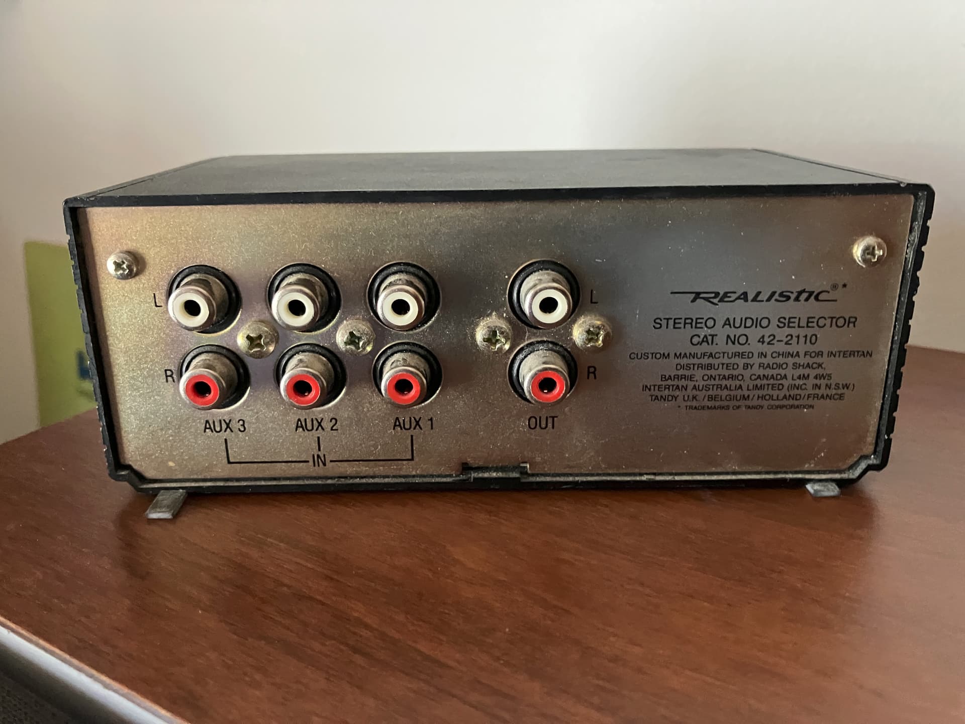

good advice, particularly about the Beresford - I’ll look out for one. Actually the guy who gave me the Nait 1 also gave me a device made by Realistic (see photos). He probably bought it in the mid 80s when he bought the amp. I just thought it didn’t look particularly good quality so I haven’t tried it - maybe I should?

I don’t know why I thought the Realistic unit might not be any good. I’ll give it a try!
