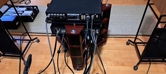

I don’t know if this will help, but I thought I would share my set-up with you.
I have five Naim boxes: NDX 2/XPS DR, NAC252/SuperCap DR, NAP 250 DR (as well as a blu-ray player and a headphone amplifier).
My room is long and rectangular, so rather than put my two racks beside each other I put the one with the brawn behind the one with the brain. This makes cable management much easier. Also, I get a better soundstage without a large stack of boxes between my speakers.
I have never understood why so many people put their racks so tight against the wall.

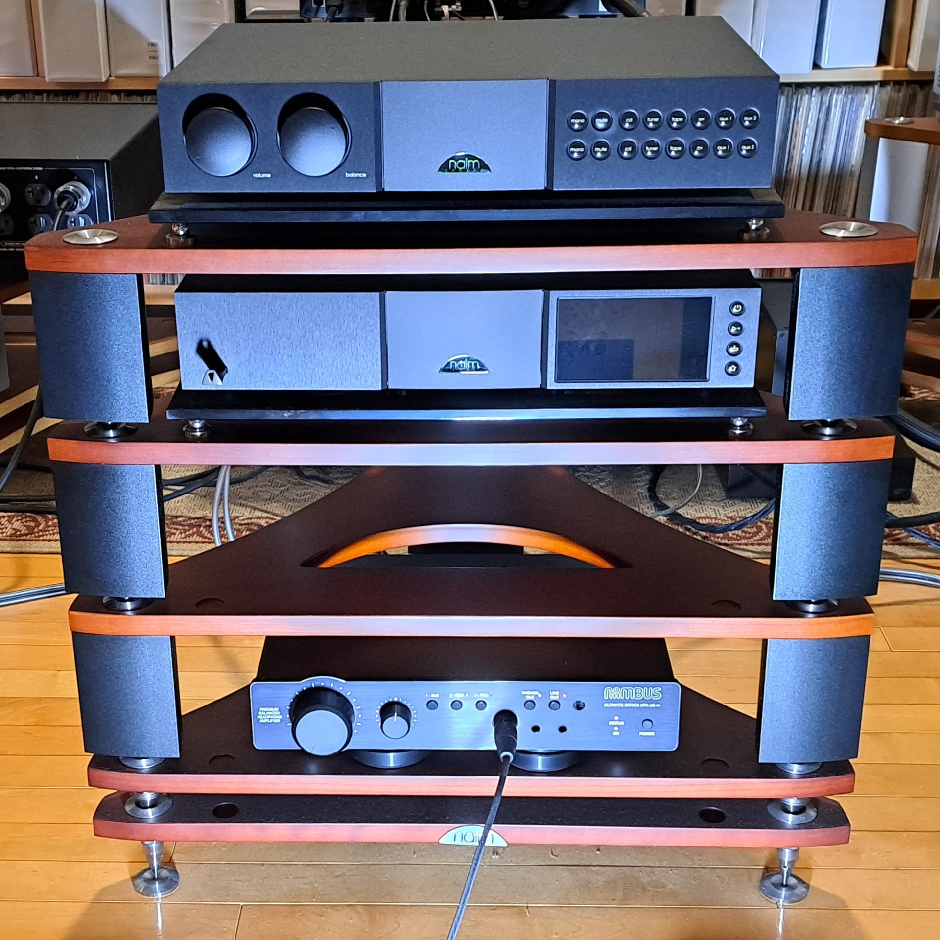

Personally I would reverse the 252 and NDX, but that’s how I had it when I had that exact system of six boxes (but on brain/brawn). When I had eight boxes it was (top down) 252 - SuperLine - NDX2 - 300
To make things even more complicated, the Fraim’s toughened glass sub-shelf has a top that rings like a tuning fork (Ding!) and a bottom that does not ring (donk.).
I learned this tweak earlier this year on this forum.
My preferred set-up is the 252 on top with a glass sub-shelf that Dings! and the NDX 2 on the second shelf on a glass sub-shelf that does not ring (donk.).

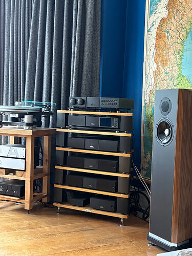

Think mine is:
282
NDX2
Nap 300
555ps
Nap 300 power
Napsc & Hicap
(Also top two shelves are fraim and bottom are fraim lite. Most sensitive components on fraim glass)
