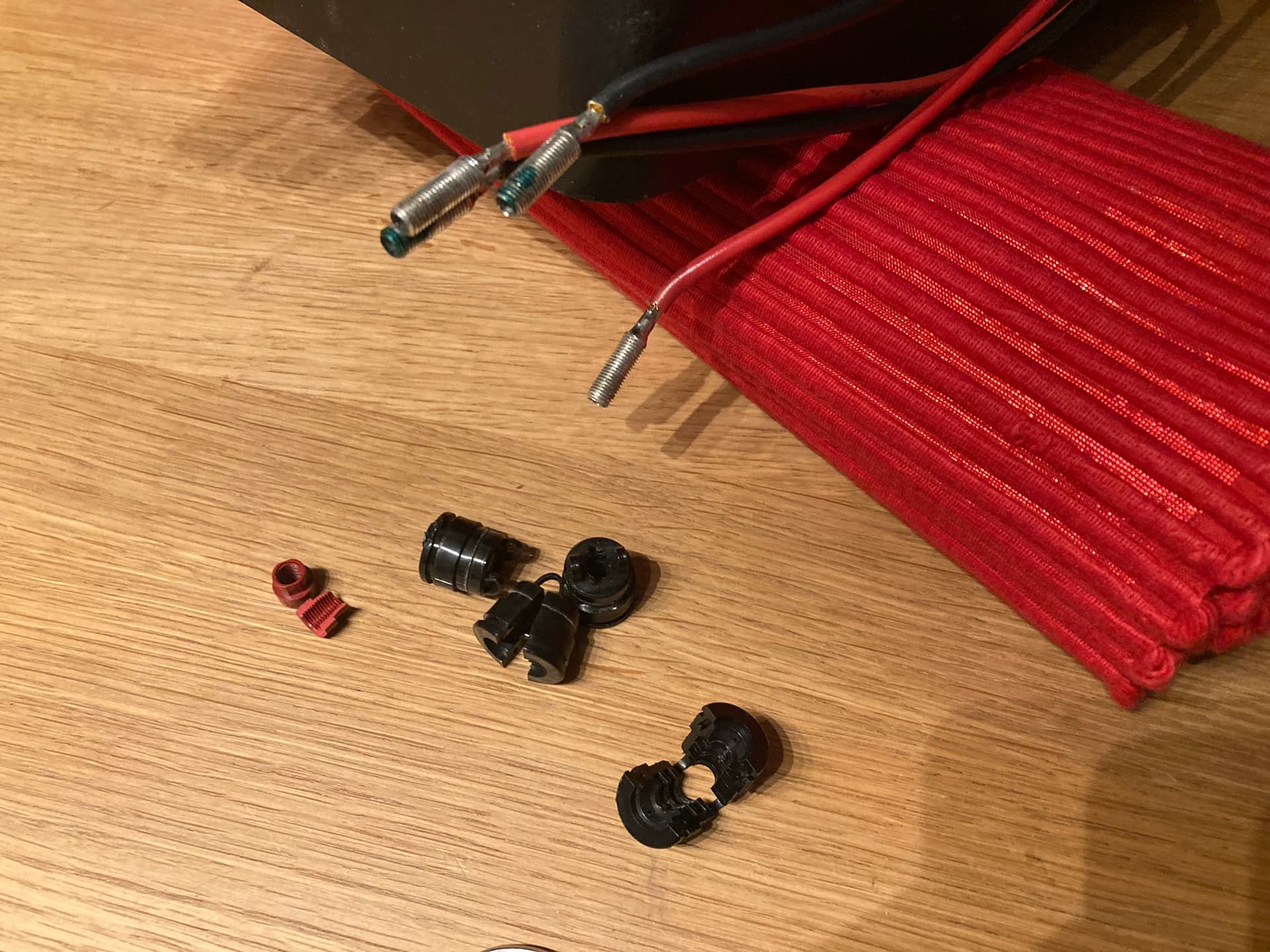

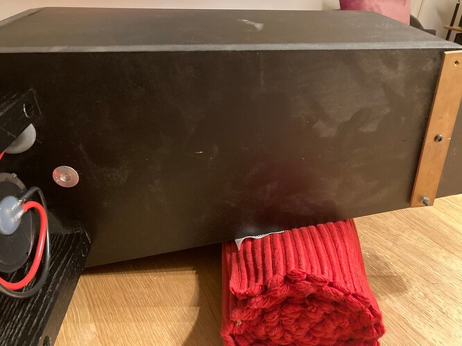

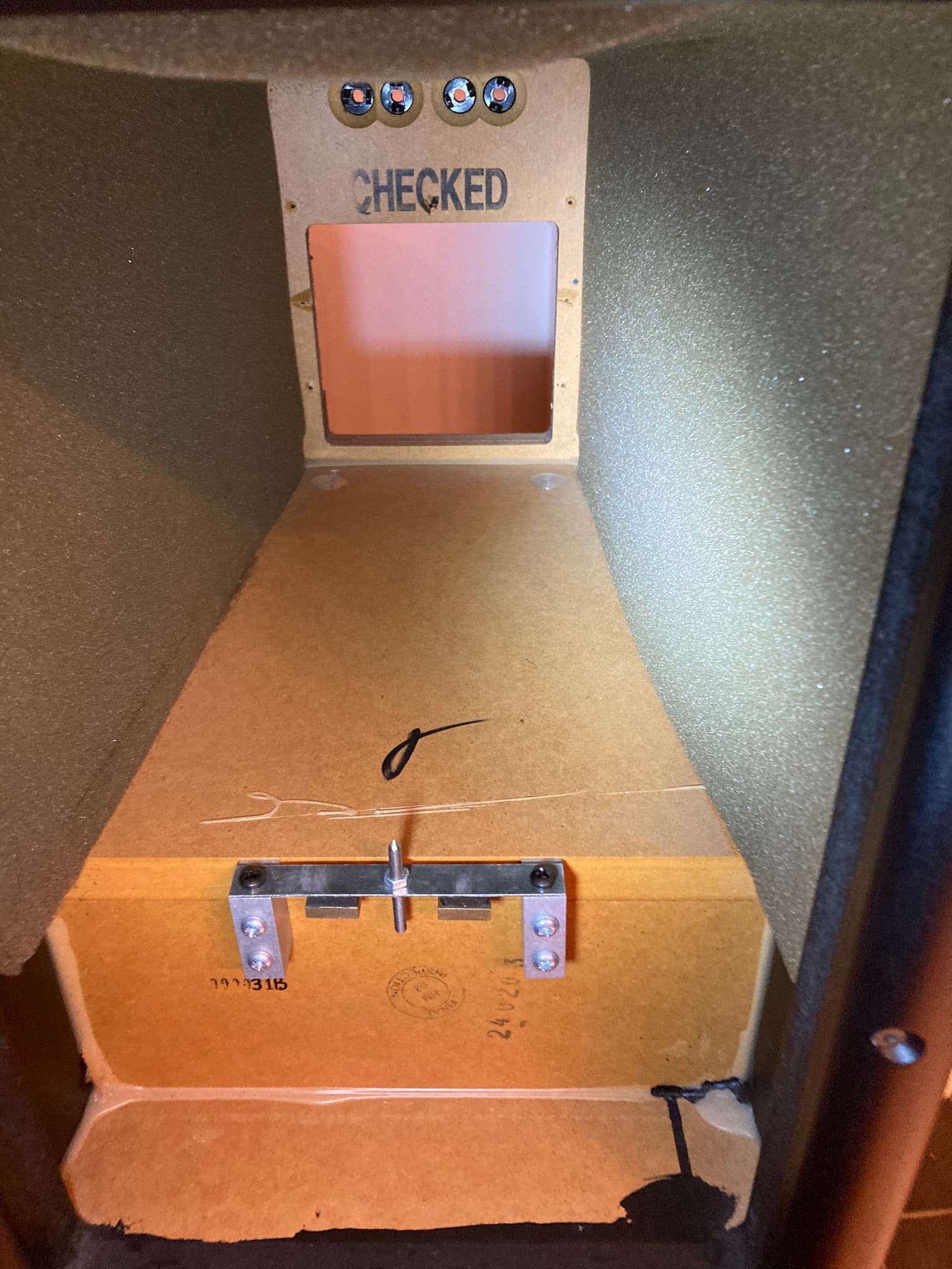

I was unable to remove the black bosses around the speaker posts so I removed the red and black plastic end caps. All but one broke but I had some spares. I removed the nested box (the bare terminals pushed trough the bushes). I tapped the bushes out from the inside.

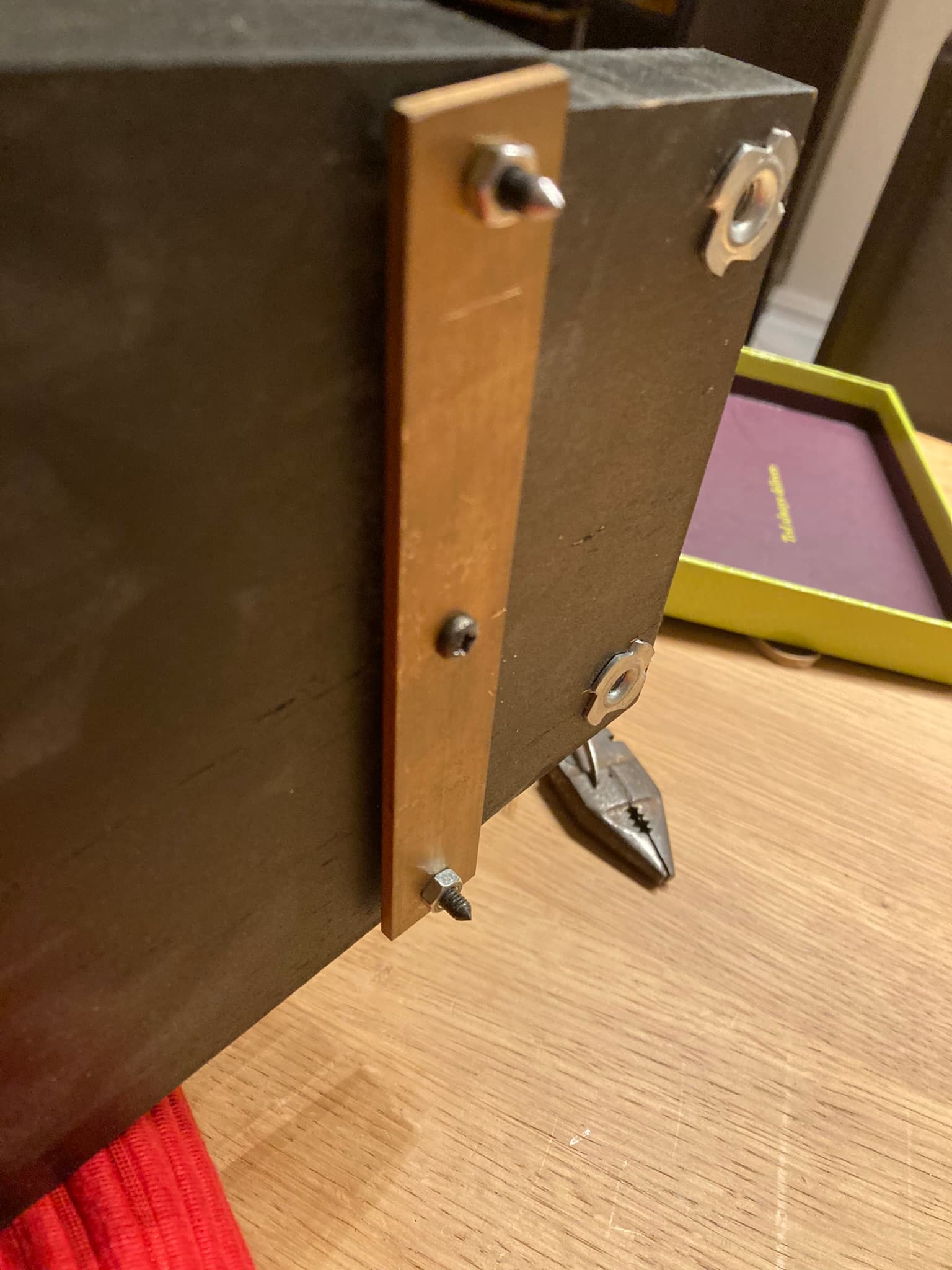

The suspension is three point and one of the two rear pins was sheared off, I fashioned a new pin for the rear brass bar.
Reassembled. And it works!
