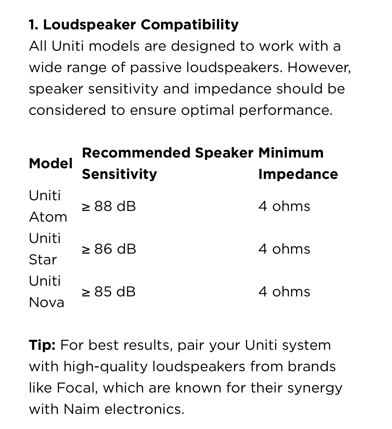

The main issue here is that not all speakers are a benign even load, and some can be quite reactive, with impedance far below the quoted number. The load quoted is often an average rather than a minimum. With the Unitis, I see that Naim recommend a minimum of 4 ohms, so perhaps there is some caution being expressed here on the basis that some speakers quoted as 4 ohms may present an impedance far lower at certain frequencies?
Either way, provided the speakers you choose aren’t too reactive and don’t dip below 2 ohms at any point then you’ll likely be fine.
