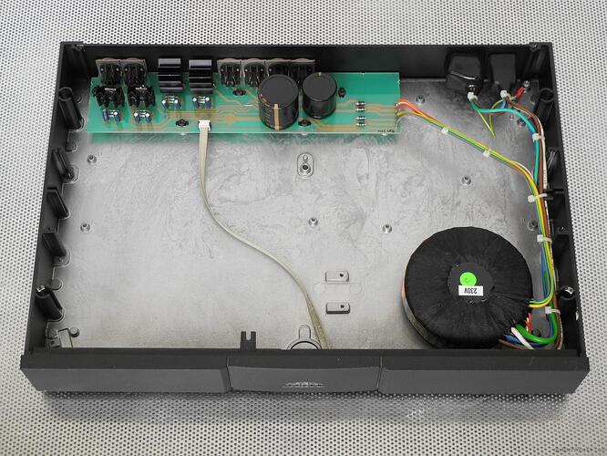

Just imagine the FlatCap components inside a HiCap case. I think the FlatCap just looks sparse due to the case size.
You could look at it as a slightly lower spec HiCap but with better component separation :slight_smile:
…and better I/O from the FlatCap 2 onwards

As I was born a Wilshire lad I can say Salisbury air is very good but the box and its associated unused space have more to do with matching the Flatcap with the other items in the family range. A Flatcap’s components could be made to fit in the same box as a Hicap quite easily but it would not then match stylistically with a NAC112,122 or NAP150 for example or any of the other of the slimline range.
It is not the size or weight of the box that matters but the design and quality of the components. Although I have long suspected that a Flatcap with a 2kg of lead weights put in it would make them believe it was a much better unit. Perhaps Naim missed a trick! :grinning:
