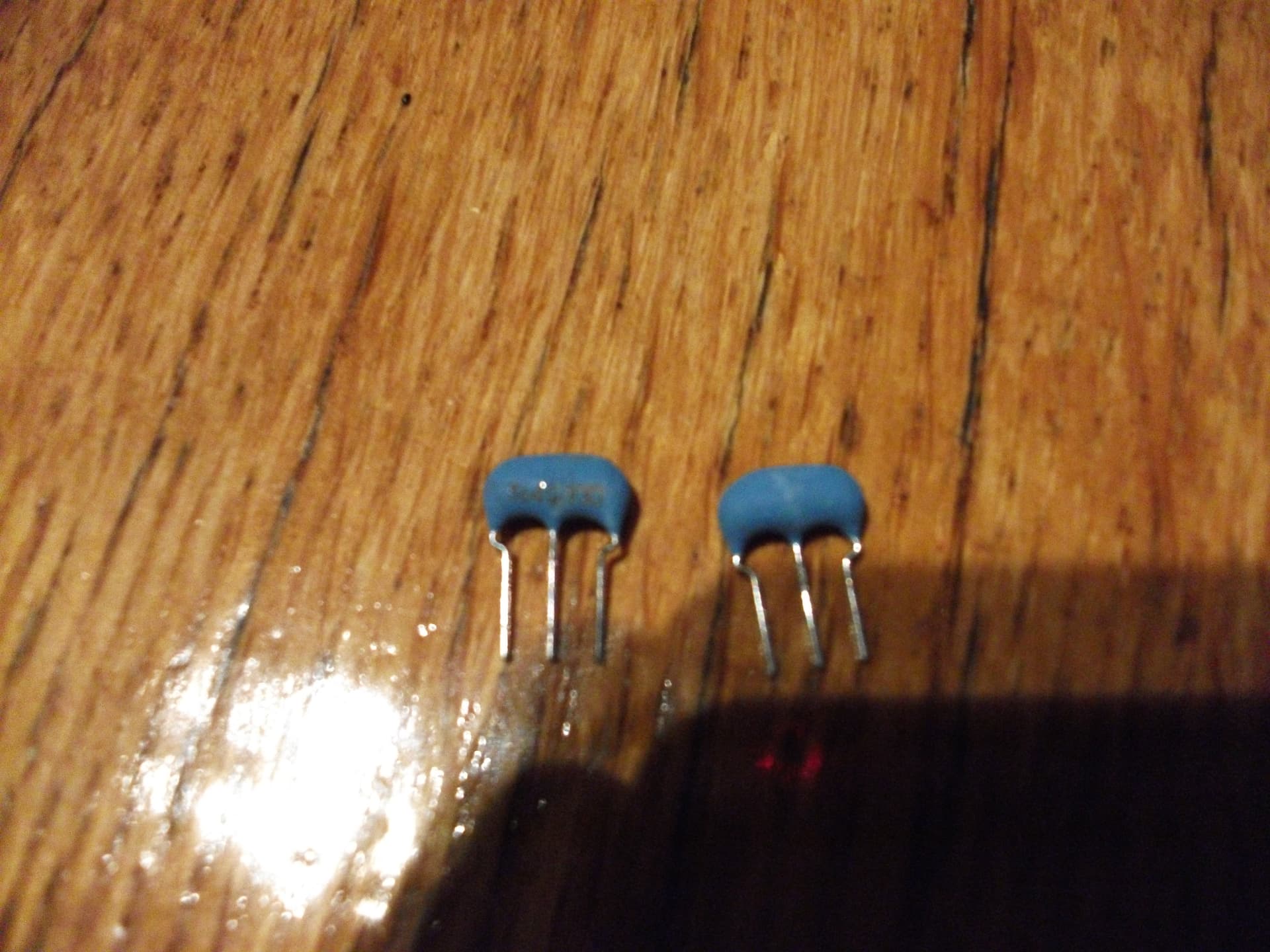

I have one of the remotes in the photo.
It never worked as long as I’ve owned it (bought second hand).
I have just repaired it using a replacement 3.64 MHz ceramic resonator from China.
Take out the resonator and the two small capacitors near it then solder in the new resonator connecting the middle wire (the original resonator is two wire) into one of the holes that was the junction of the two small capacitors.
Once you have the resonator it is an easy repair.
