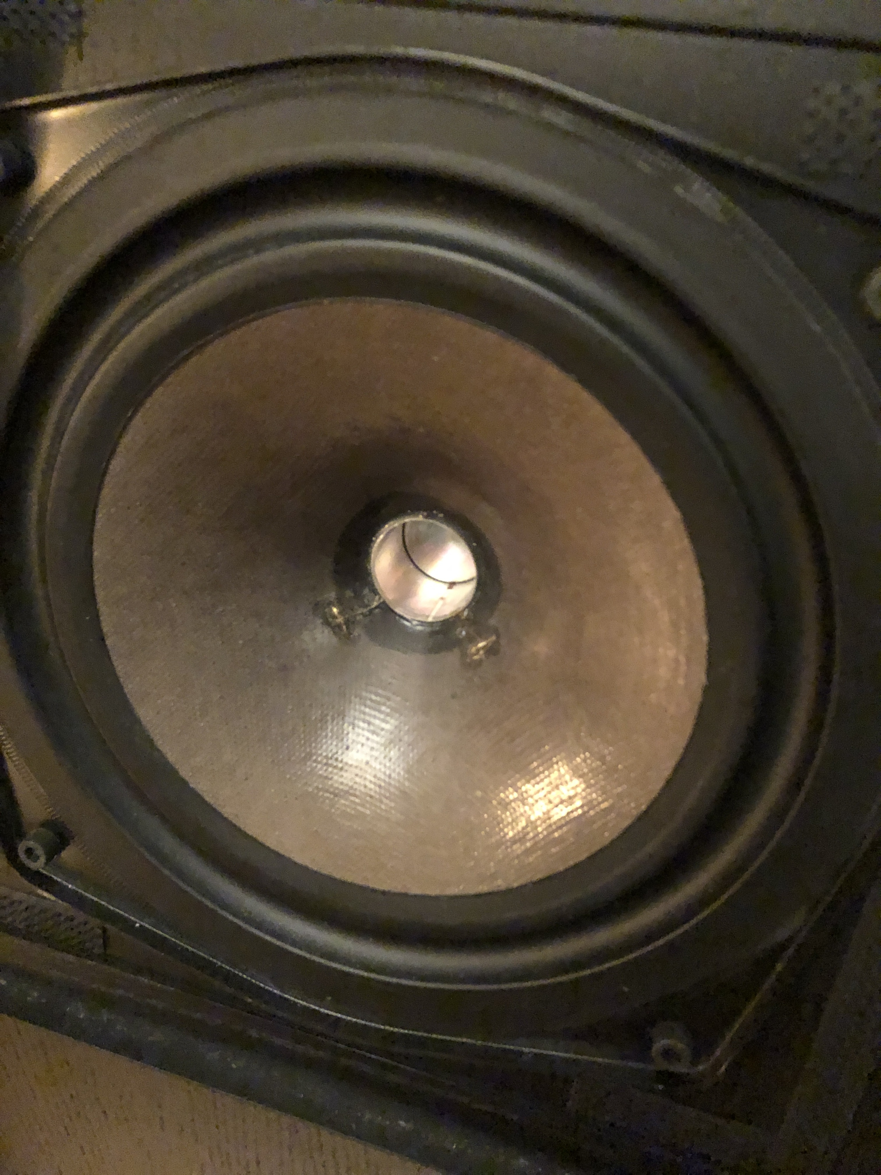

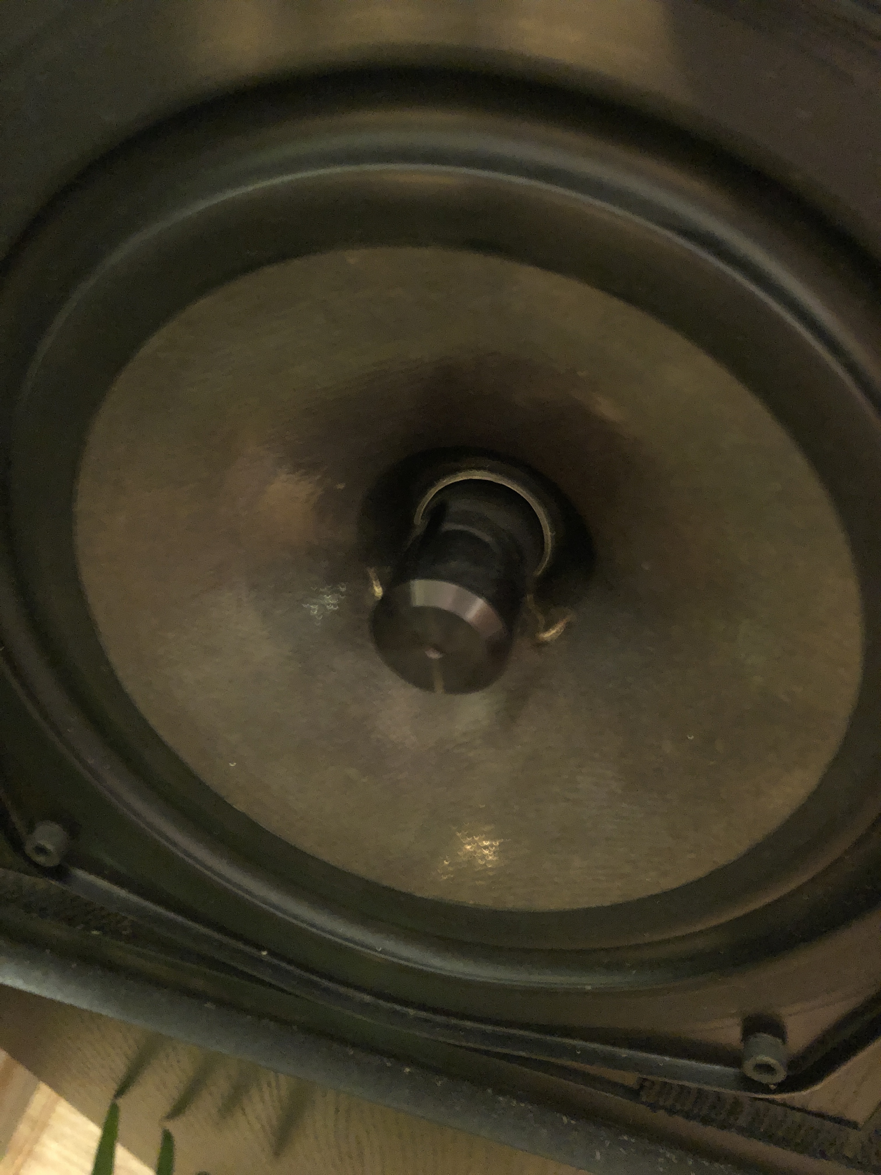

So I picked up some 90s SBL speakers today. One of them sounds great, the other has servere distortion. Upon investigation, the centre weight appears loose and in fact can be completely removed, it seems to have worked loose over the years. Does anyone have any advise on what I should do to fix this…

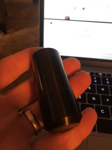

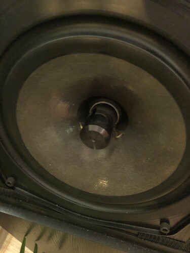

Hi…erm yes that may be what I mean, its the cylinder shaped plug at the centre of the bass unit… Removed it sounds fine, but when inserted its distorting because its moving around presumably.
Those are Mordaunt Short drivers by look of it. In which case, the repair kit won’t work - that’s only for the later Naim drivers with the split phase plug/heat sink.
IIRC the way to repair this is to ensure it’s perfectly centred and affix using a tiny speck of superglue. This must be done very carefully otherwise you risk destroying the driver. Best done with the driver removed and laid flat. Then shim the phase plug to centre it.
However, you say it plays with distortion. Even without the phase plug in place? If so, it indicates that the driver may already be damaged.

Reading the OP’s comments suggests that the sound is ok with the phase plug removed, which would indicate that the driver is ok. Looking at the photo it seems that the plug attaches to the metal bit at the rear of the hole, but not to the sides, which need to move in and out. Is that right? If so, getting any glue on the sides would make the driver seize up.
Fixing this is certainly not something I’d attempt as it looks really, really easy to mess it up. I’d be inclined, if I were the OP, to take them back for a refund. An alternative would be to have the drivers upgraded to Mk2, but I seem to recall that’s about £800. It would be far cheaper to return the speakers and buy a pair with the Mk2 (Naim) drivers already in place.
thank for all of the advice. With the plug removed they sound perfectly ok without any distortion at all. They came as part of package which im quite happy with (with the exception of the non working HICAP to 72…), anyway I don’t want to return them, id rather work out a way to get them working. Is there any danger of using the speakers with Plug removed… I presume its there for a reason!

Is the rear of the phase plug flat, like the front? If so putting a blob of glue in the middle would not be so hard, especially if the speaker was on its back and the plug was being lowered vertically. That’s something I’d me more than happy to do. If you put a band of thick paper around the plug that would ensure it was centred. Once the glue is dry it would simply slide out.
On the other hand, if the plug is an open tube at the back it’s a case of putting the glue round the edge and lowering it in without touching the sides, which would be really, really tricky to do.
In that case, take the bass box off and lie it on the table or floor. Support the top of the box with a book or something so it’s dead flat, and wrap a piece of paper round the plug that’s thick enough to keep the plug central while the glue dries, but not so thick that you can’t slide it out without pulling the phase plug off again!
I’m assuming that as the speakers have only just arrived you haven’t yet sealed the boxes together. Do you know how to do that properly?
I hope that makes sense. Good luck, let us know if it works.
