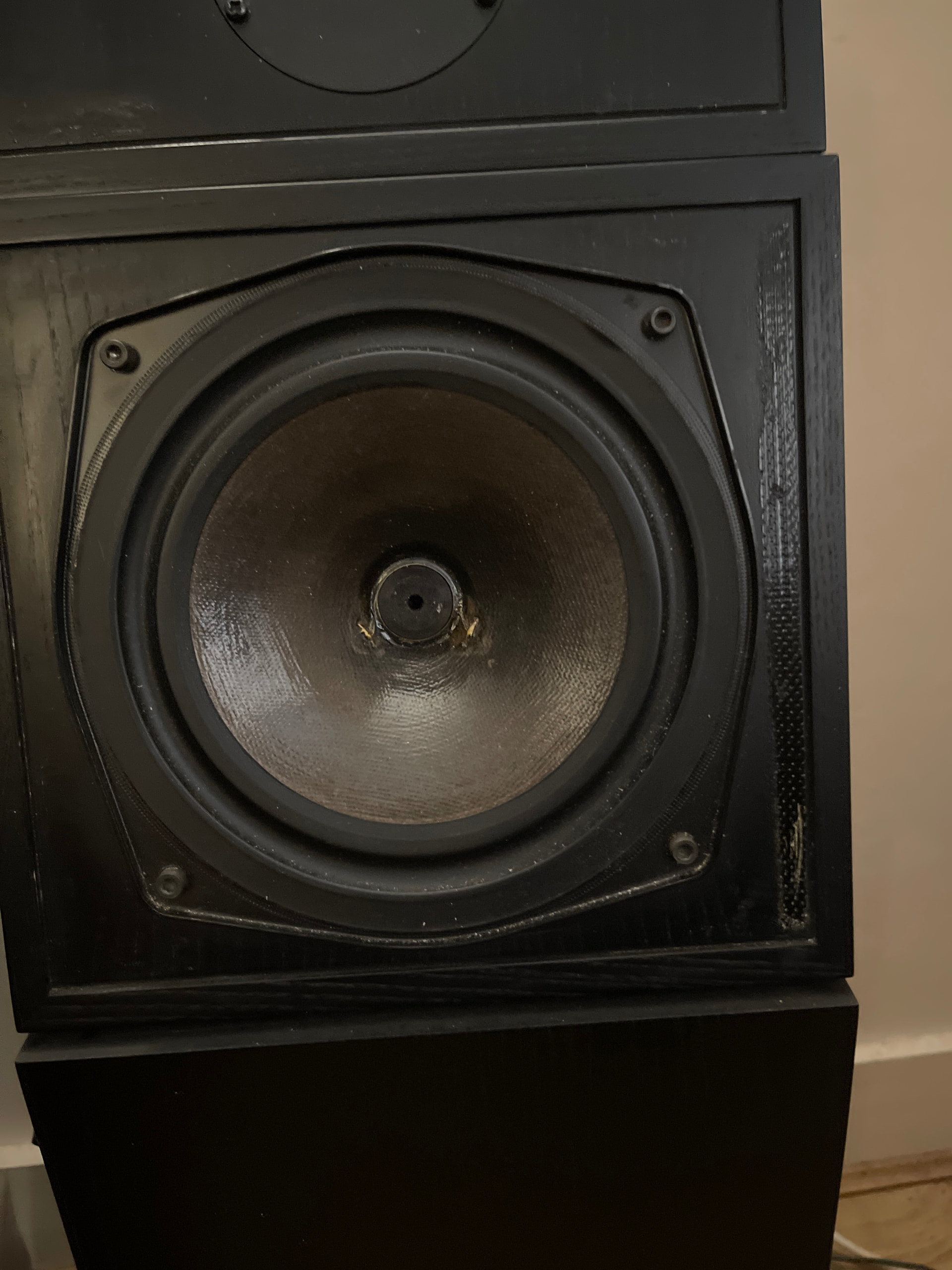

Thank you for your reply, I’m not sure what you mean when you say surround so here is a picture, perhaps you can tell me which one it is ?
That’s the original Mordaunt-Short driver. The phase plug just glues in.
