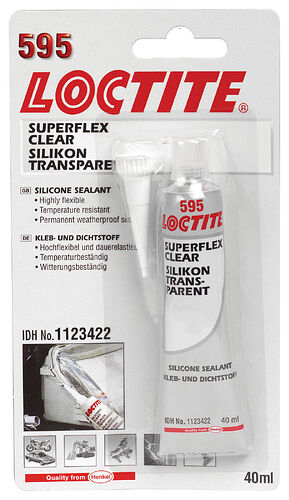

Yes, 595 Loctite Clear

And don’t forget the Fairy liquid!
What’s that, Stuart? I found a company in my country having the Loctite 595, but don’t know what the other liquid is which should be used. Unfortunately, the pdfs online seem to be gone and sbls.co.uk doesn’t work anymore.
It’s an old and established part of SBL ownership. Before applying the sealant you smear some washing up liquid on the gasket. The idea is that when you need to dismantle the boxes the seal separates more easily without damaging the gasket.

Cool. The current gaskets are used, but in tact. What kind of washing liquids are normally used? Washing liquid for laundry? Or for hands? Or the general purpose stuff?
Washing up your dishes and pans stuff. Any brand is fine. I use Fairy Liquid!
Stu
Ah, ok. I first thought that Fairy Liquid was some insiders phenomenon for audiophiles, but it appears to be what we call Dreft. Thanks - we have it in stock!
