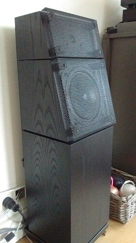

The grills have arrived and are perfect. The most important insurance for the loudspeakers in my busy young family. We have 4 kids and they are quite energetic. Had my tweeters of the BW’s replaced twice. Here is a photo of the grills on:

Interesting grilles. Can I ask who makes them?

A certain Mark from the Fishy place. Don’t think I can give more precise pointers, but this should be sufficient.
The grills are of such a quality that they will definitely survive lets say a football shot to the SBLs or a toy car thrown against them (shock / horror - but these things happen :-).

Ah yes, of course; he does very nice foam grilles as well. And amusingly, during our correspondence concerning my sibbles (black ash like yours), we established that he went to school with my cousin (who has the same name as me)!
Wow that’s different! I don’t mind the mesh look, at least on black speakers.
