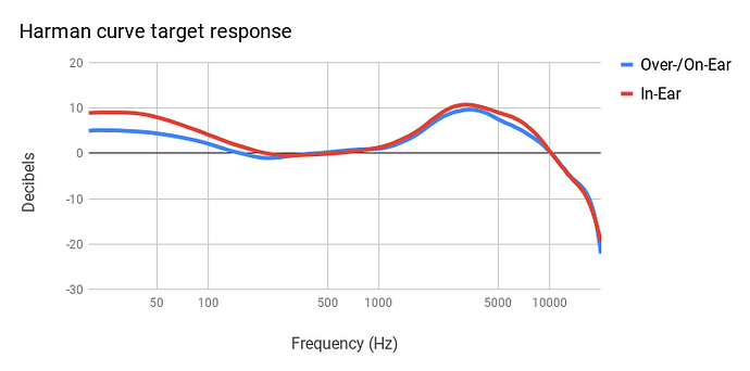

Indeed, and let’s not forgot for us humans, we don’t require it to be even frequency response across the audio spectrum… we have sensitivities in certain areas and it is these we should focus on.. and they vary slightly from person to person.
Sean Olive, an audio researcher found the following with headphones, but maps to preference with speakers as well when coupled into a room.
”Harman curve Lovers”: This group, which constitutes 64% of listeners, includes mostly a broad spectrum of people, although they’re generally under age 50. They prefer headphones tuned close to the Harman curve.
“More Bass Is Better”: This next group, which makes up 15% of listeners, prefers headphones with 3 to 6dB more bass than Harman curve below 300Hz, and 1dB more output above 1kHz. This group is predominantly male and younger.
“Less Bass Is Better”: This group, 21% of listeners, prefers 2 to 3dB less bass than the Harman curve and 1dB more output above 1kHz. This group is disproportionately female and older than 50.”
Note where we have great sensitivity is notorious for room reflections.
